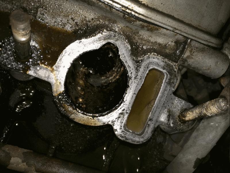

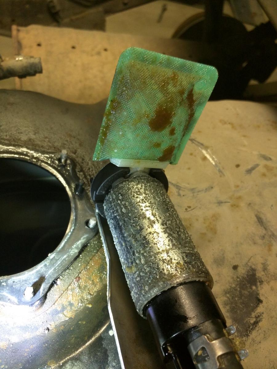

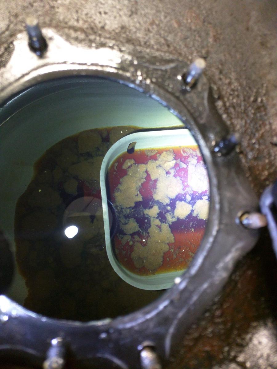

So i think i found the issue... idk what some idiot dumped in the fuel tank but damn.... might need to take the injectors out and replace/clean them.
Attachment 16053Attachment 16054
That looks like water. And it has been there for a long time. Yep, that'll screw up how the engine is running - you can try adding methylated spirits to the fuel to force the water into solution. Afterwards add a good quality injector cleaner and fingers crossed it will sort it out.
I just wonder how it got in there? The seals are good around the fuel level thing, and the fuel pump and as far as I can tell the tank hasn't been compromised, as well as the filler neck is in tact and not ripped. Maybe some idiot dumped some mixture of fuel and water in it a long time ago.
I'm gonna drop the tank and clean it out and take the injectors out and inspect. I have until Thursday when my new denso fuel pump gets here.
Condensation is one way. And country fuel supplies were notorious for having water in their storage tanks. Don't know if it as much an problem now but it happens...
My understanding is that one of the horrors of ethynol is it attracts moisture. That's one reason to use fuel additives that remove moisture, or seek out filling stations that serve real 100% gasoline.
I use shell or chevron exclusively. Might settle for Conoco if I have to. Sad thing is I just put 5 gallons of 90 octane and some injector cleaner in that tank for trouble shooting. Debating about getting one of those fuel filter things that filter out water to conserve the fuel I dumped in there.
Pull the plug and let it all drain out.
I just dropped the tank and pressure washed the inside of it. And cleaned the outside it wasn't that hard to get out and since the old nasty stuff settled to the bottom I was able to pull out most of the good fuel with the old pump before I drained the tank. Letting the tank dry out in my garage right now. commencing removal of injectors now.

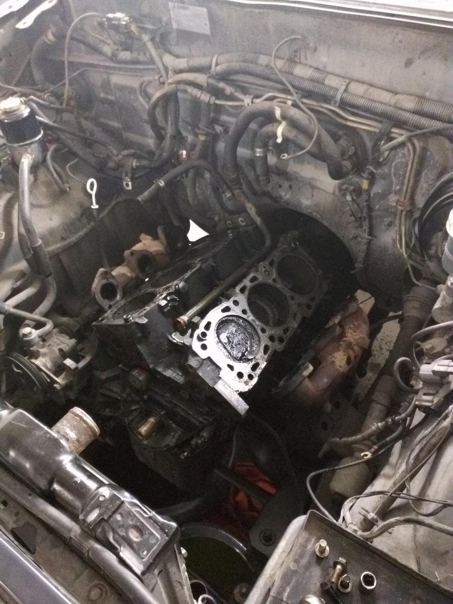

alright this is just disgusting. it looks like my engine has a disease... I'm gonna take the heads off and clean them out, replace the head gaskets, valve stems, and seals while I'm at it. doesnt seem like that much of a challenge this engine is so freaking easy to work on. does anyone have a link to a guide that shows the deletion of emissions stuff? AK doesn't require it.

Might as well throw in a new pump and strainer while you are in there.

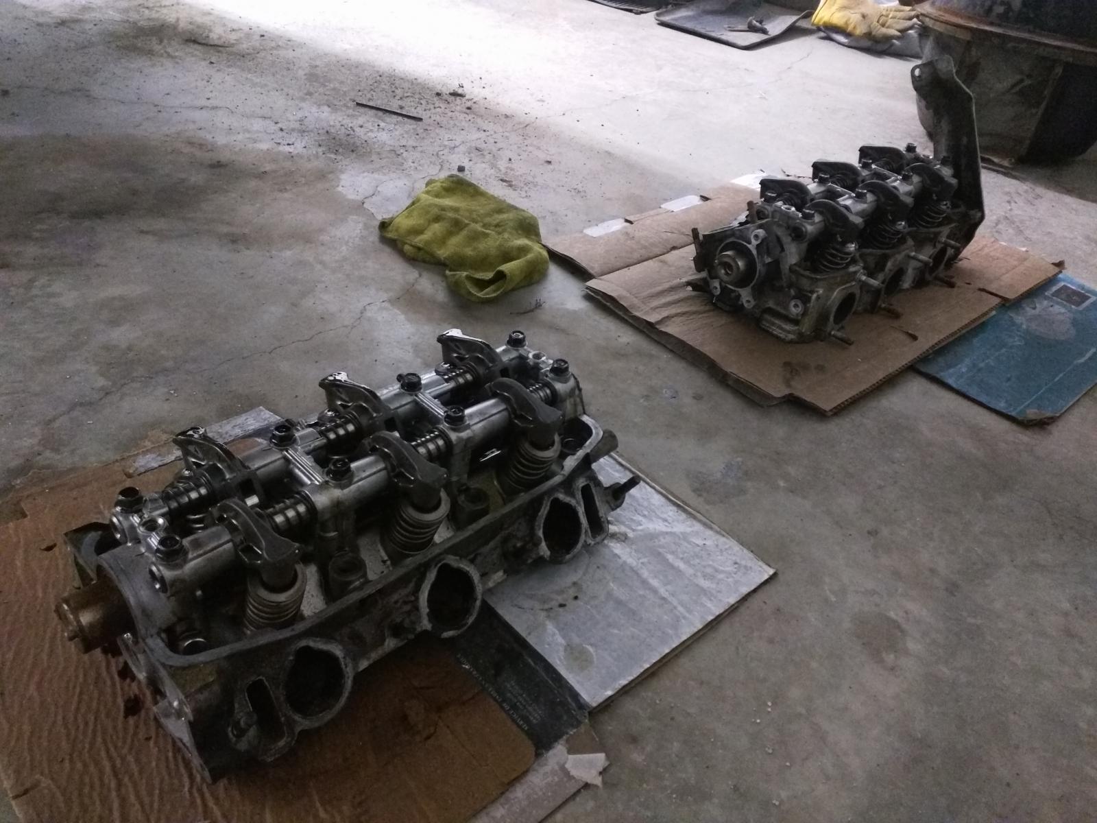

i ordered it last week since that's what i suspect is what is bad. it will be here Wednesday i think. but the rest of the parts wont be here til like the 25th so i have some time to kill. honestly besides the horrible nasty fuel buildup of whatever was in the tank this engine is in great shape. the head gaskets where not bad the timing belt and water pump where in pretty good shape accept some idiot decided to use red rtv all over everything. its the little things about this engine that make me think the previous owner took care of it but used the cheapest stuff he could when doing maintenance. does this engine have a front main seal that is easily replacable while I'm in there? the oil pump seal on the crank looks pretty good and is not leaking but if there is a front main back there i would consider replacing it since i have the time and its already all torn down.
some pics of the progress:

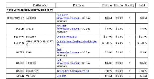

Parts are rolling in!! looks like its gonna be a while before my timing belt will get here though. sometimes i hate living in AK.

Wow, sure have a build up of muck on those pistons. Makes me wonder how much more compression you get with that, lol.

that was one of my thoughts but i triple checked my orientation before i tore it down. and at first i jacked it up just like you said then i fixed it and made sure all the plug wires go to the corrosponding cylinder. but after seeing the intake manifold i just decided screw it and tore everything apart. replacing everything i could and did the best i could with a plastic scraper to clean the carbon and muck of the cylinders. would have had it back together by now but rockauto lost my parts and shipped me a new set friday so i should have progress this weekend when the head gasket and the timing kit get here thursday. but i still need to get a valve spring compressor to take the heads apart then im going to steam clean them at my buddies shop. hopefully not to much longer
