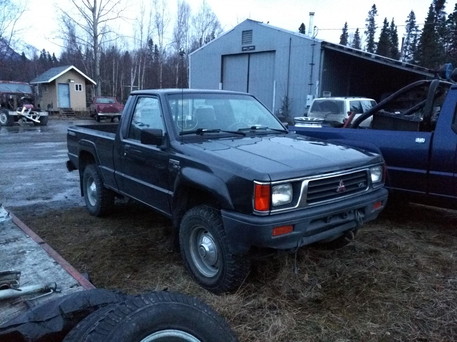

    Quote Originally Posted by GoodApollo View Post
    Also post up some picks of your Alaskan 4x4!
    Only good picture i have at the moment! will post more when i can get the thing moving!

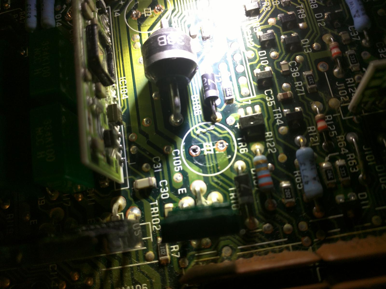

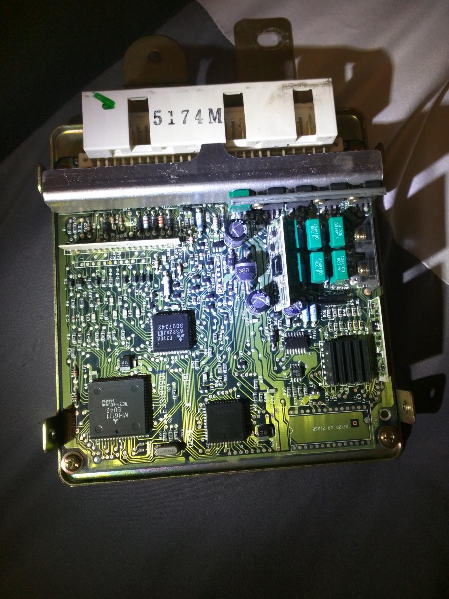

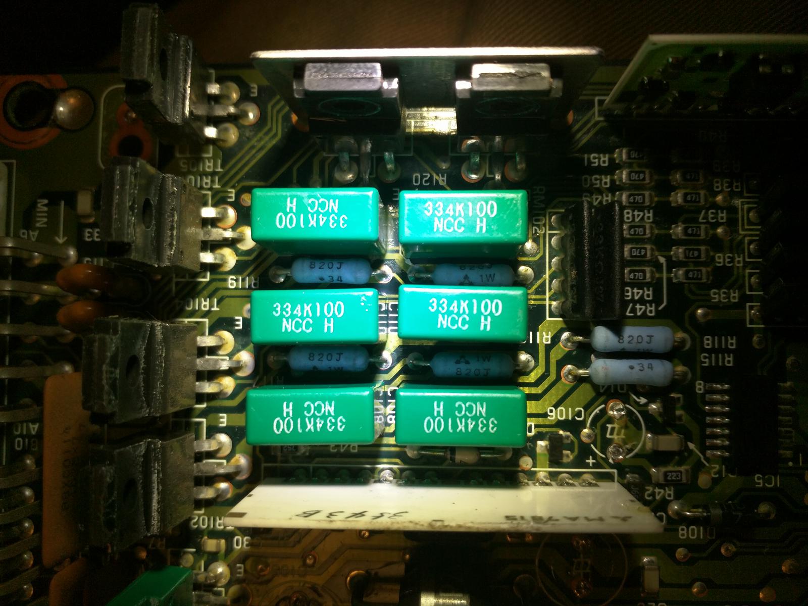

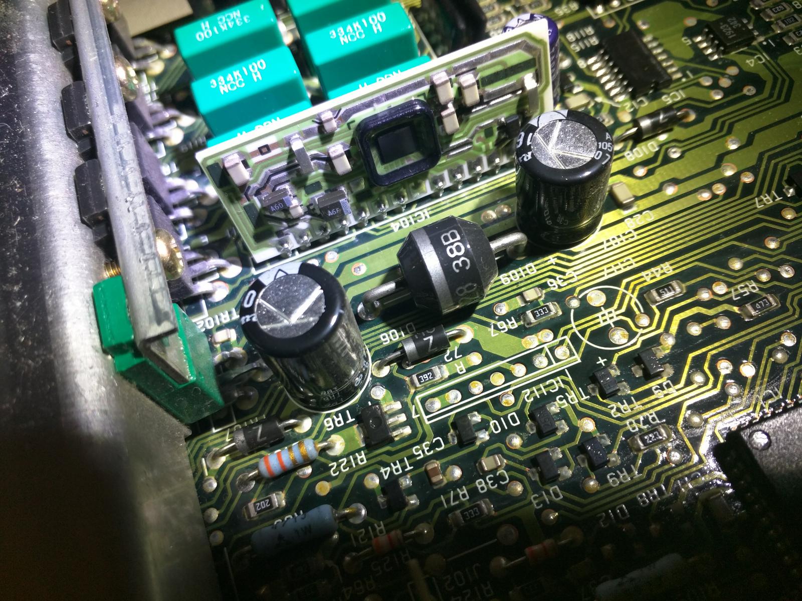

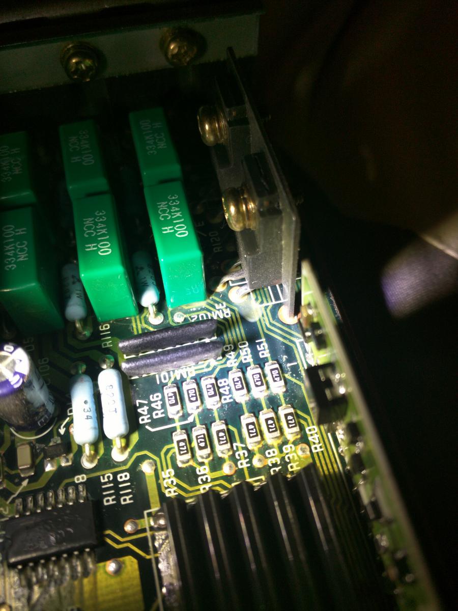

    Alright I got the ECU out and apart and i cant see anything to drastic. here are some pics though. what do you guys think?Click image for larger version.

    Can't see anything but check closely to the bottom of those 3 large capacitors. Anything wet is a bad sign.

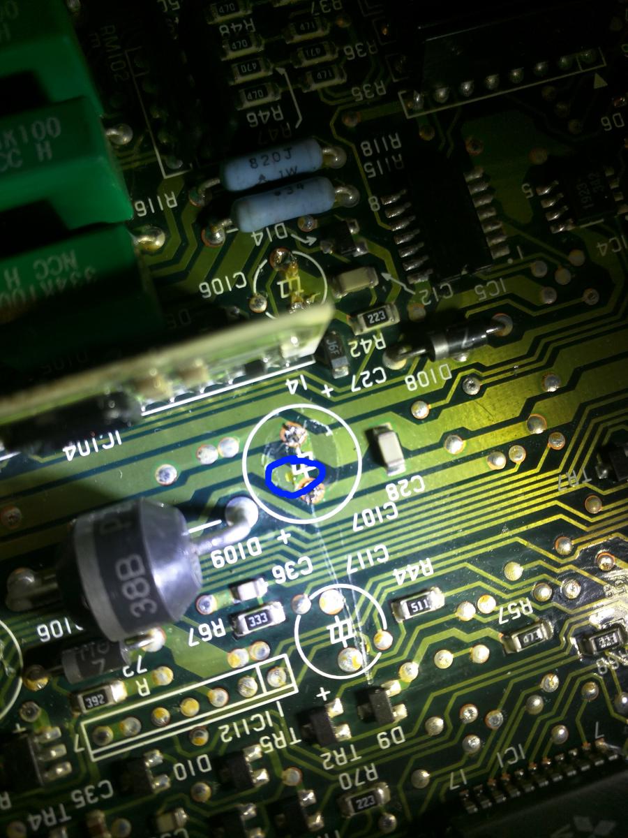

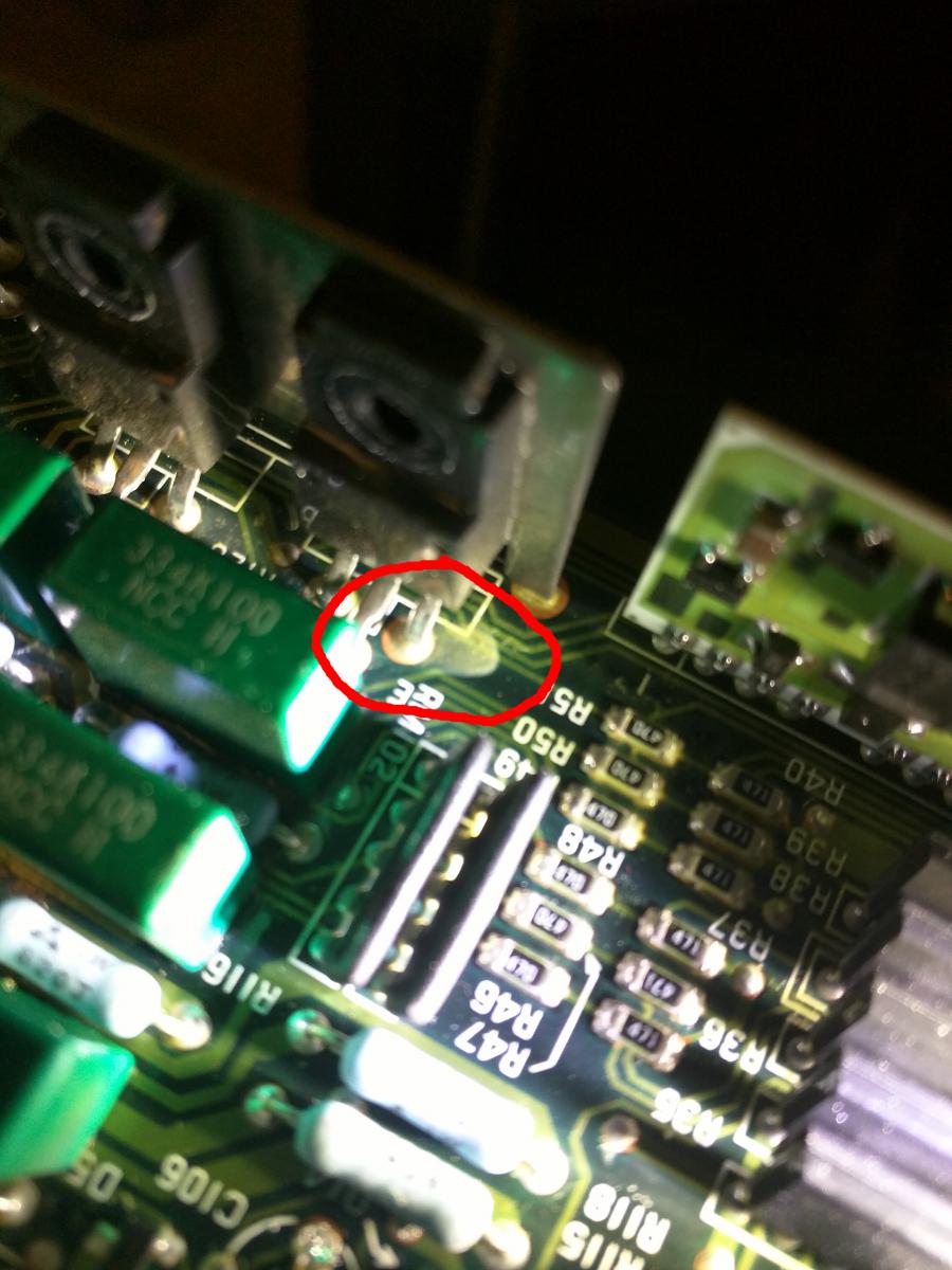

    Ok got the capacitors off and one of them had a drop of something on the board (circled blue). and is the stuff circled in red in the pictures just sealant??

    if the caps have left stains on the PCB - they're toast. As for the mystery substance in your red ringed image, I got nada on that.
    01-07-2016
    231
    Kansas City, MO
    1992 Mitsubishi Mighty Max
    I think the stuff in the red circle is just where some of the anti-condensation coating pooled up. It's nothing to worry about.

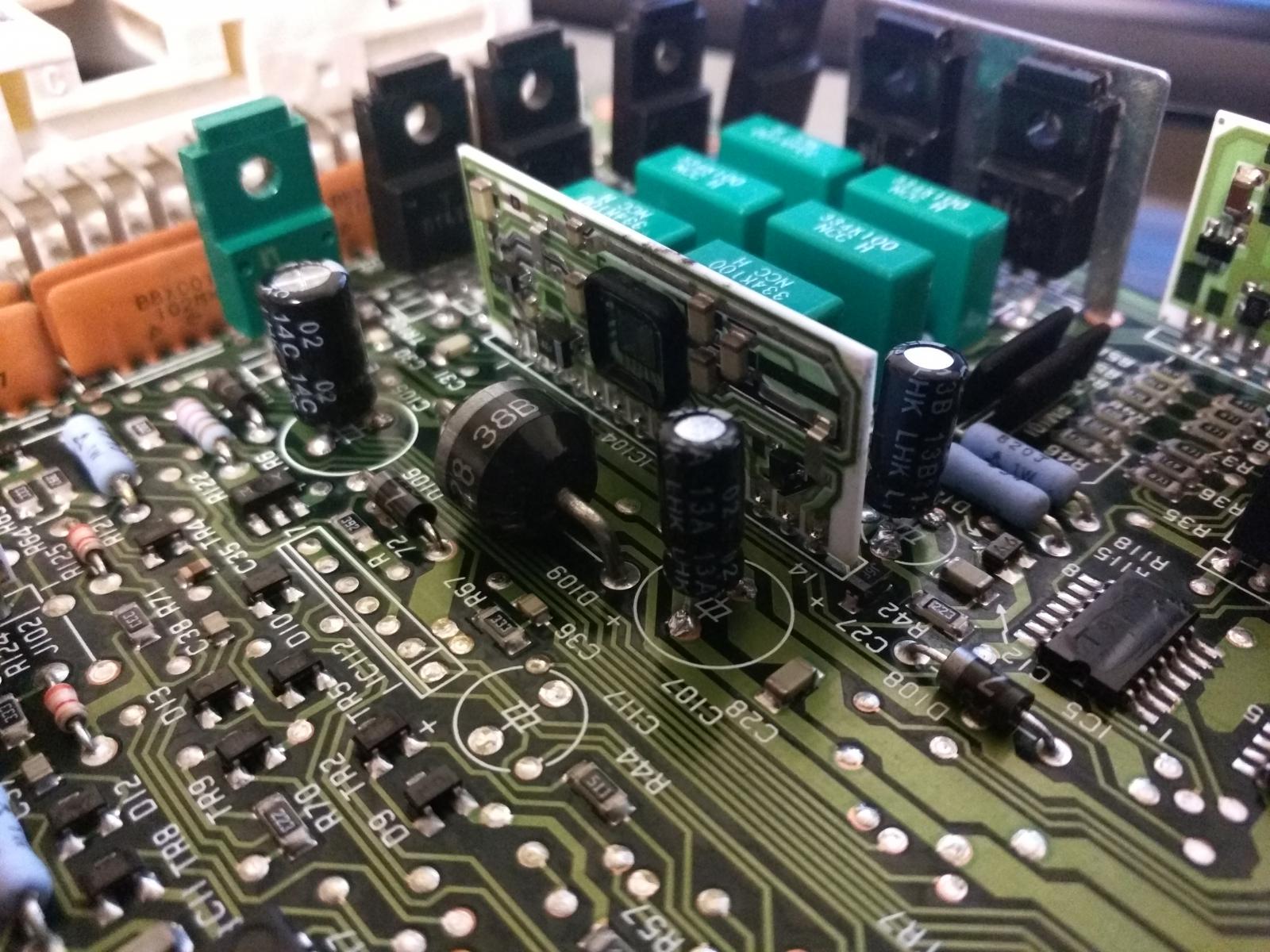

    Ok new capacitors soldered on. not the same size but the same ratings on all of them and they are not crappy rubycons. also stripped the old peeling coating and got some epoxy to paint on to coat it. why do you need to coat the PCB? why couldn't you just seal the metal case the board comes in?

    Maybe coat it with clear nail polish? If a track on a PCB oxidises there's a good chance it will burn off the board.
    Online
    4,309
    It is also to insulate the traces on the board
