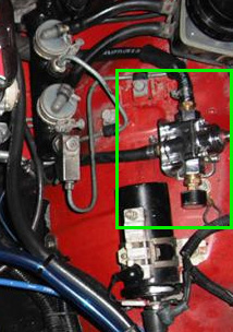

That is exactly correct. 1-4 psi is what they dial in at. I use a mini gauge on mine to check the psi. Though it doesn't have 4x4 moving parts in it, lol. Set it and forget it.
Attachment 6370
I ordered a P4070 Carter pump and a 12-804 Holly pressure regulator from StreetsideAuto.com- 104.00 bucks and some change.
There is a nut on the reg to adjust the pressure. I may add a mini-guage like Brad has to dial in the correct pressure.

A buddy just gave me a Holly regulator with a Tee for the gauge and plug where your gauge is. I like that and now know what to do with it.
Otay I recieved the Carter 4070 and Holley 12-804 from StreetsideAuto.com- I ordered them Wed. or so and they were on my doorstep Fri. Super prompt shipping for only 10.00 bucks. They are awesome.
