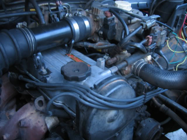

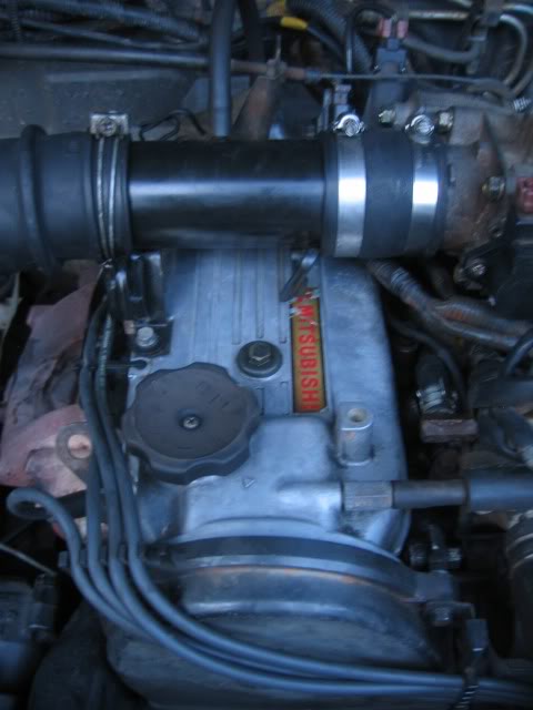

Truck has been running great the past week or so. Even better recently, until it started blowing smoke out of the tailpipe. At start-ups.. I was used to it and didn't mind so much. But recently it started blowing smoke while driving.. sitting at red lights.. and got even worse at start-up. So I knew the time had come to replace the valve guide seals. With much success, I knocked it out with flying colors. This was the issue I had on the last truck. I over torqued the valve cover and broke one of the camshaft main bearings, then the front of the rocker assembly had broken in half, and in the end I dropped a valve in the cylinder. So sadly, I wiped my hands clean of that truck.

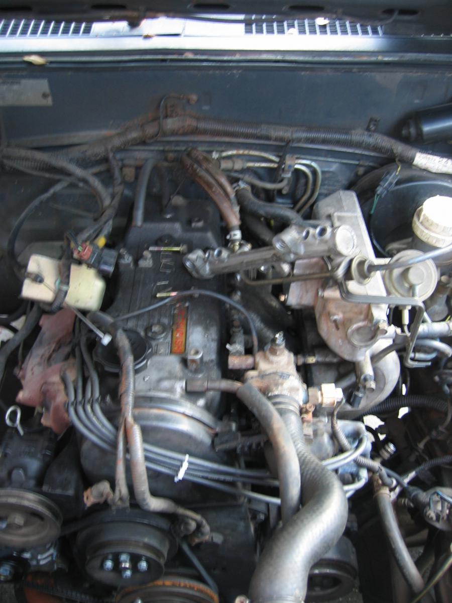

I was terrified of destroying this one. But fortunately, learning from my mistakes, nothing went wrong, and she no longer burns oil or blows any smoke. Oh, what a relief. Here's a comparison shot of my filthy valve cover before and after I cleaned it during this process.
Before (when I was replacing the injectors):
Attachment 19733
After:
Attachment 19734
and if you notice, I did a small wire tuck. Instead of having the wire harness come over the valve cover in front of the intake tube; I ran in behind it and under the throttle body. Much cleaner look IMO
Attachment 19735

Good update. You seen honda-tech forums? They got a lot of wire tuck info on there.
It has a mass air flow adapter on it that allows it to fit a cone filter. It's not technically a cold air intake, but a nice upgrade over stock. I don't plan on doing a CAI since it's a daily driver and I enjoy running through the deep puddles :devil:
Thanks. I've browsed on there a time or two. I won't be going gung-ho on wire tucking. But if I can find a better, less of an eye sore, way to route wires.. then I'm going to take it ;)
The deep puddles make the best waves. Lol. It was just a suggestion if you were going further into a wire tuck.

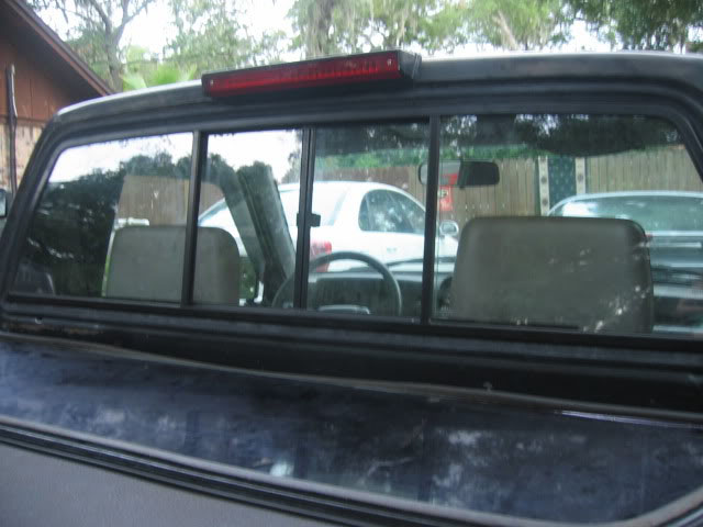

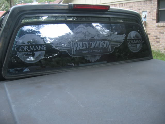

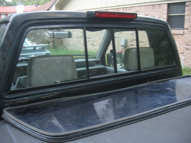

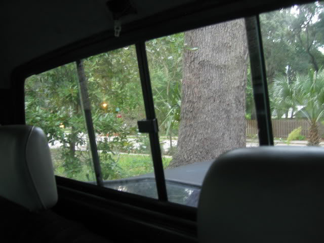

Motor is still running good, so I was finally able to focus on something else today. Got my new back slider glass and new weather stripping installed.
Out with the old
Attachment 19739
and in with the new
Attachment 19736
Attachment 19737
Attachment 19738
Will finally be able to see behind me now! The old glass was etched with some logos, making it nearly impossible to see through it and the 2 layers of tint. Next plan is to get the new glass along with the side windows tinted.

i really wish you would have taken some pics during the swap and a little how to...id like to remove mine and re weather strip but not completely sure on how to...
It was honestly ridiculously easy. This was my first time ever doing one.
I watched these two videos to gain some perspective on how to do it, they should help you too.
http://youtu.be/ZVJdYinyASs
http://youtu.be/hW-2PD-hcCM
All you really need is a flat head screw driver to pry the window out, and about 12 feet of small string, which I got from wal-mart for $1. They have it in the craft section, just look for some that is about the size of kite string. When installing the window, you wrap the string in the weather stripping and spray the whole seal down with some water/dish soap mix. Have a friend hold it in place, and pull the string from inside the cab. It grabs the lip of the weather stripping and lifts it over the edge and inside. If you can change a spark plug, then this is nothing.
Here's another link that might help you with the install:
http://www.fordmuscle.com/2007/05/in...ng-back-glass/
It is really easy. I had to replace the back glass in my '92 Ram 50 after someone CUT IT OUT and stole it, along with my speakers, amp, and cd's.
Anyway, my boss at the body shop I worked at at the time found me a back glass and seal for $35 at a nearby salvage yard. A short trip later and I was back with it and ready to put it in. Having never installed one of this type before, I asked one of the guys I worked with to help me. We had it installed in less than five minutes. More like three. This was in '96, and it's been in and problem-free ever since... until now. It's not really a problem (yet), but I noticed the weatherstripping/seal is starting to split in places, and when you rub your finger or a rag across it, it'll leave you with a nice black mark for your troubles. Time is catching up to it, so it looks like a replacement is in my future.
What I'm really trying to say, in my long-winded-ass way, is that replacing yours shouldn't give you any problems or headaches.
nice to know..i see a new rear window seal in my future.

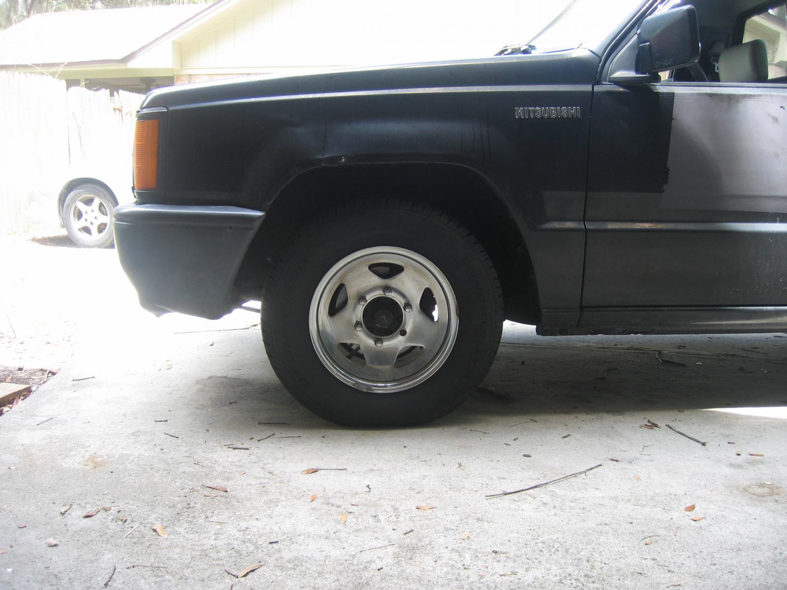

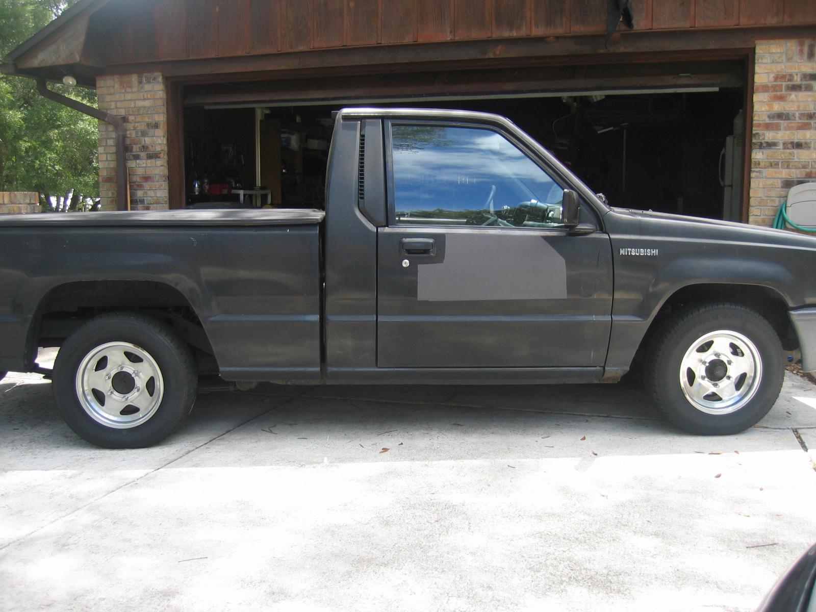

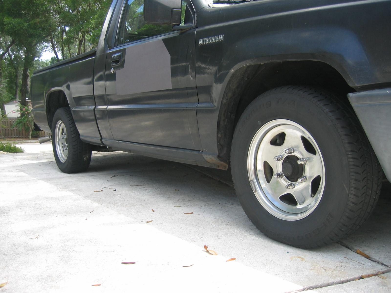

Scored a set of "new" rims yesterday for the truck! They came with 4 pretty decent tires too. Finally, something on my truck actually looks good!
Attachment 19740
Attachment 19741
Attachment 19742
They came with all 4 center caps too, I just didn't put them on yet. Cleaned them all last night, they were pretty filthy. They still need some polishing pretty bad, but man they look a ton better than my mismatched set of rims I had before.
Also.. don't ask about the primered rectangles on the doors. I have.. no idea? Possibly a decal was there that got painted over.. Seriously, the whole truck looks like it was roll painted with some rustoleum.
Those r sum sharp wheels bud. Good find....I like the original factory look.
those look like factory sport wheels. I still have a set of those laying around. I like the look of em. Are yours 14's or 15's? If i remember correctly they came in both.
Yeah they're the sport wheels, 14's. Bought them from a guy here in town who had the sport model, but threw on some toyota rims. Sold his truck, and still had these. Believe it or not I scored all 4 with the tires and center caps for only $100!
good deal!
Lookin sweet, I see you got those from that guy Mclovin on the other site huh
