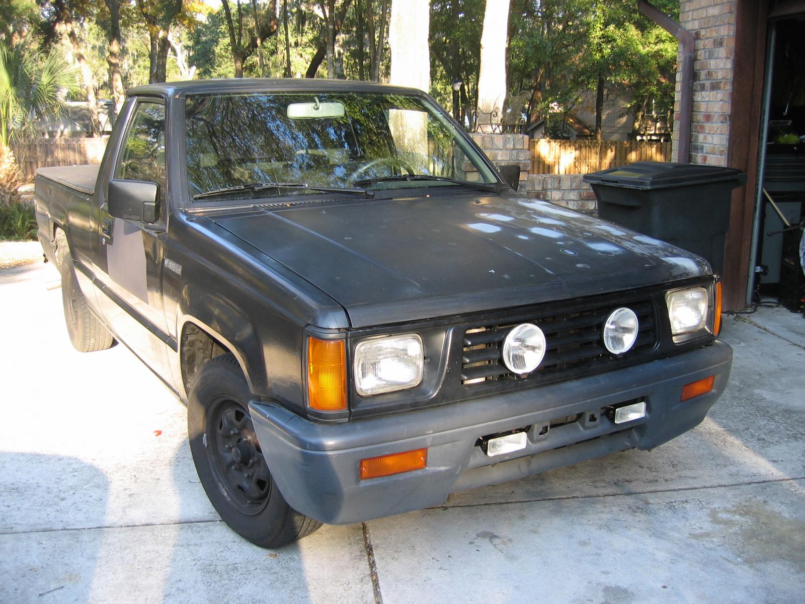

    Like the title states, this is more of a repair thread than it is a build thread. Bought this truck for $1400.. over paid, big time. Here she is in all her glory
    And here she sits.. now

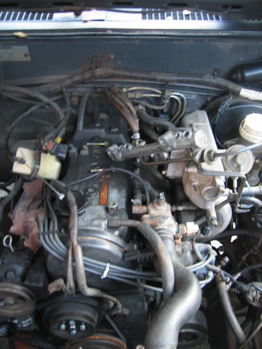

    There's probably more in there, nothing I can think off off the top of my head right now. I have checked all wires.. fuses.. any connections to see for corrosion. Can't find a thing. Vacuum hoses all looked great, until now since I hacked them up to remove the intake plenum and throttle body. I'm merely going on blind gut feelings now.

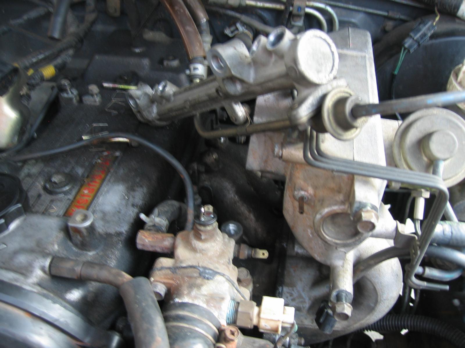

    Which brings me to my current operation, replacing the fuel injectors with used ones that were on my old truck (which ran fine). I didn't bother testing the injectors to see whether or not they were bad.. I couldn't think of anything else that could be the problem at the time, so I started wrenching away. Got the intake plenum and throttle body off. Didn't realize until afterwards I didn't even need to remove the plenum to get to the fuel rail. Thanks go to the Haynes manual on that one!
    I've got the intake plenum reinstalled. Just waiting on the new O-rings to arrive to continue re-assembly. Apparently no auto parts store here carries on hand the rings that go onto the forward spraying end of the injectors. Think I'm gonna also replace the regulator as well while I've got it right in front of me.
