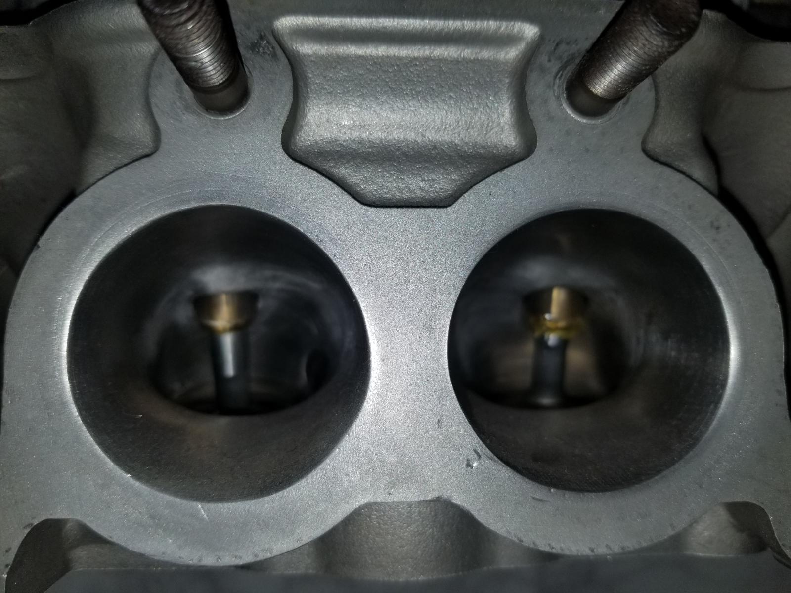

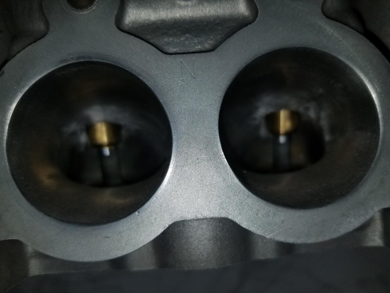

All this machine work was done by a machine shop in the orlando area called C.W. Pence, Here are better pictures of the exhaust port, I blocked the egr in the intake manifold, since I was trying different plenum ideas, ATTACH=CONFIG]23745[/ATTACH]
http://www.mightyram50.net/vbulletin...3&d=1575645075
'Flat Crankshaft' Mitsubishi firing order -1-3-4-2,
#1 intake runner, short, more for High Rpm torque.
#3 intake runner, long , more for Low speed Rpm torque.
#4 intake runner ,long, more for Low speed Rpm torque.
#2 runner, short, more for High Rpm torque.

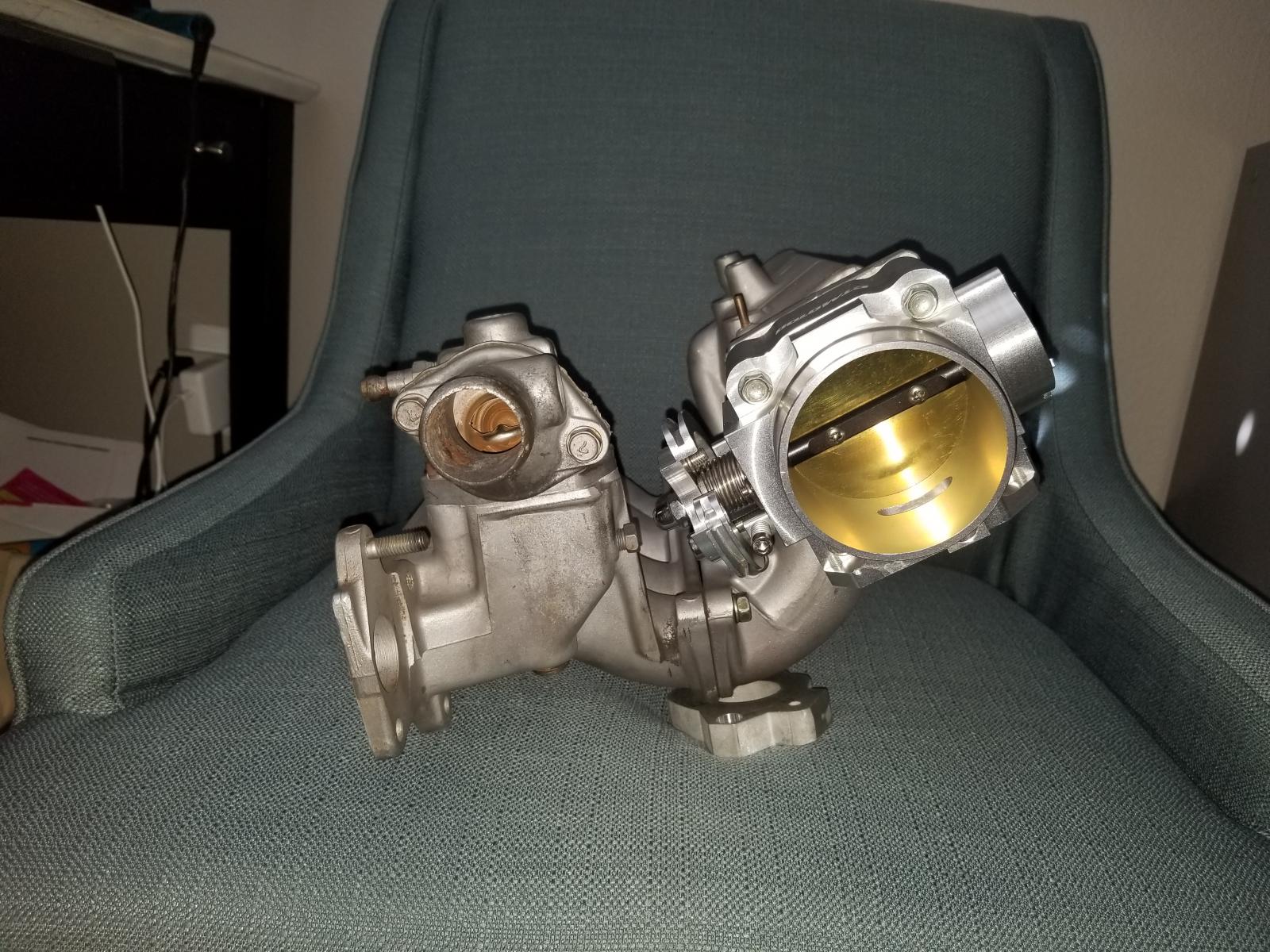

Plenum + intake is from a Galant?
The plenum is from the galant,the lower is from the truck

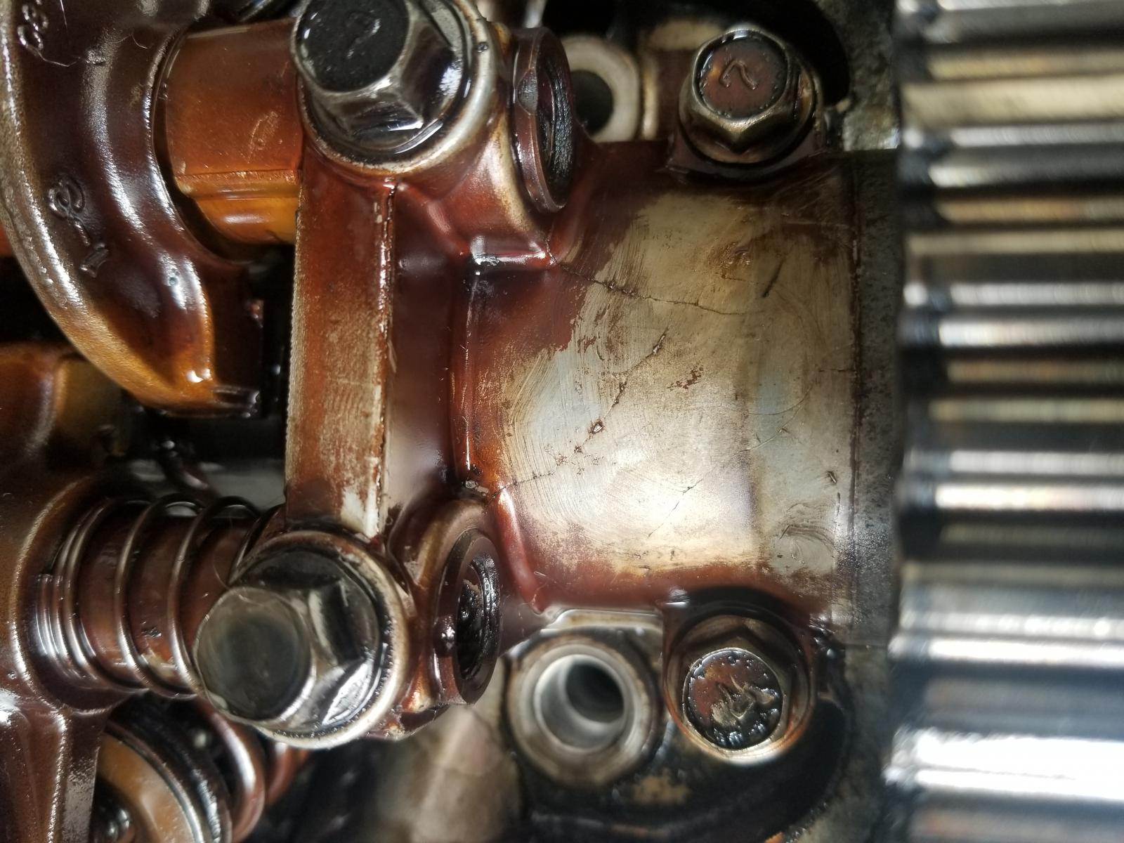

I may be getting a 2.0L valvetrain sooner than I thought. Looks like the rocker arm pedestal is cracked right at the cam gear. Going to upload a picture. I'm going to put it all back together, and just send it until I find one. Head gasket was blown at a coolant port, so atleast the head looks good.
I like that intake setup. I'm definitely going to have to run that myself. While I was splitting mine apart I couldn't help but think, "This wont be factory long."
I dont see how they breathe.
Low9
LOL they dont breathe , that is what makes this hybrid setup so cool !
The t/body inside diameter on My '94 is (drum roll) aprox 54mm :lmao::lmao:

Speaking of t/bodys is that one from a Galant ??
Thx!

Should I be really concerned about this? Never seen one crack here before.
I don't think they're cracks, more likely expansion lines from when it was cast. These are only cosmetic and you'll see them on the thinner cast alloy parts.
Good to know! I did find a small knick about a 1/4" long and a little deep in cylinder 3 between half way to 3/4s the way up the cylinder wall. It isnt enough to say it is a chip. Quite unusual. I'm not worried too much about it, as the engine was running well even with a head gasket issue aside from cold starting.
The question is how well it will hold up to boost. Either way I'll have a spare complete engine on standby before I hit it with a razzle dazzle engine tassle.
Motor turns very easily though. No scoring of other cylinders. And aside from a lot of carbon build up, it was surprisingly clean.
Ordering a timing kit, as the belt looked factory, then putting it back together.

The throttlebody is a 70mm for

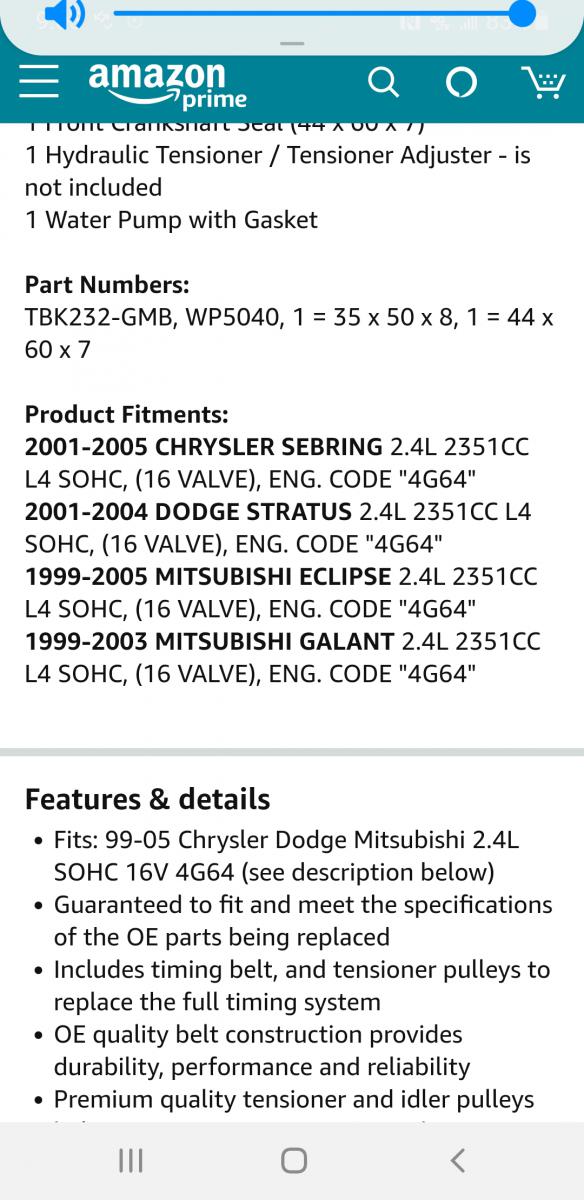

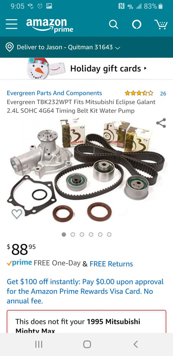

What about this kit here? Amazon says it will not fit, but I'm not aware of any differences, and the pump looks exactly the same.
Difference I see is 16V vs 8V. Still being SOHC though, is the game gear just not the same?
*cam gear
That's the wrong kit
I figured. Just wasn't 100% if they are interchangeable. I'm trying to find one with a water pump included, as it is usually cheaper, but may just have to order the kit and pump separately. Getting more and more eager to toss some boost at it the more I browse through parts, but I'm trying to replace everything that is a basic normal wear part while I reassemble.
