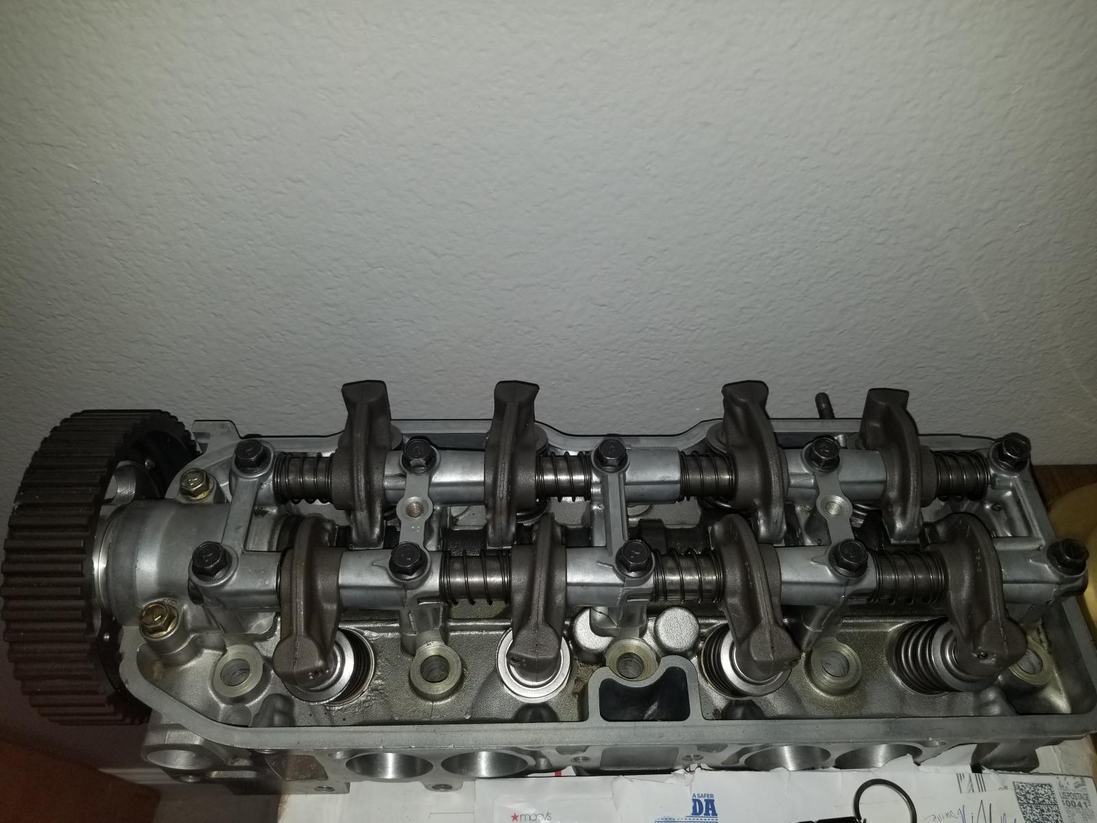

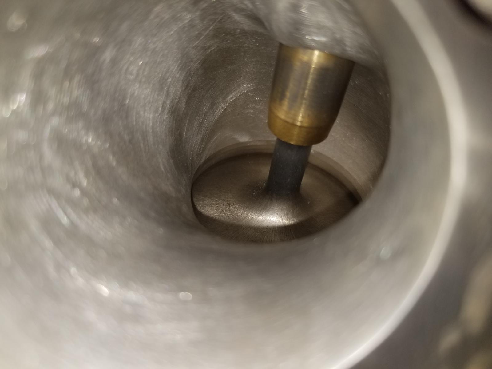

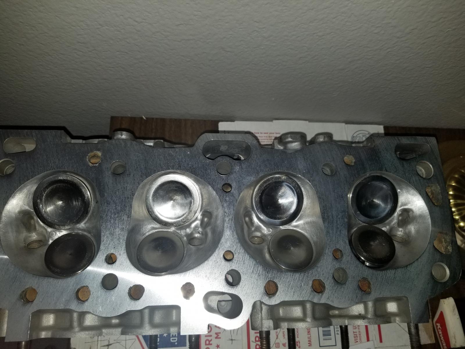

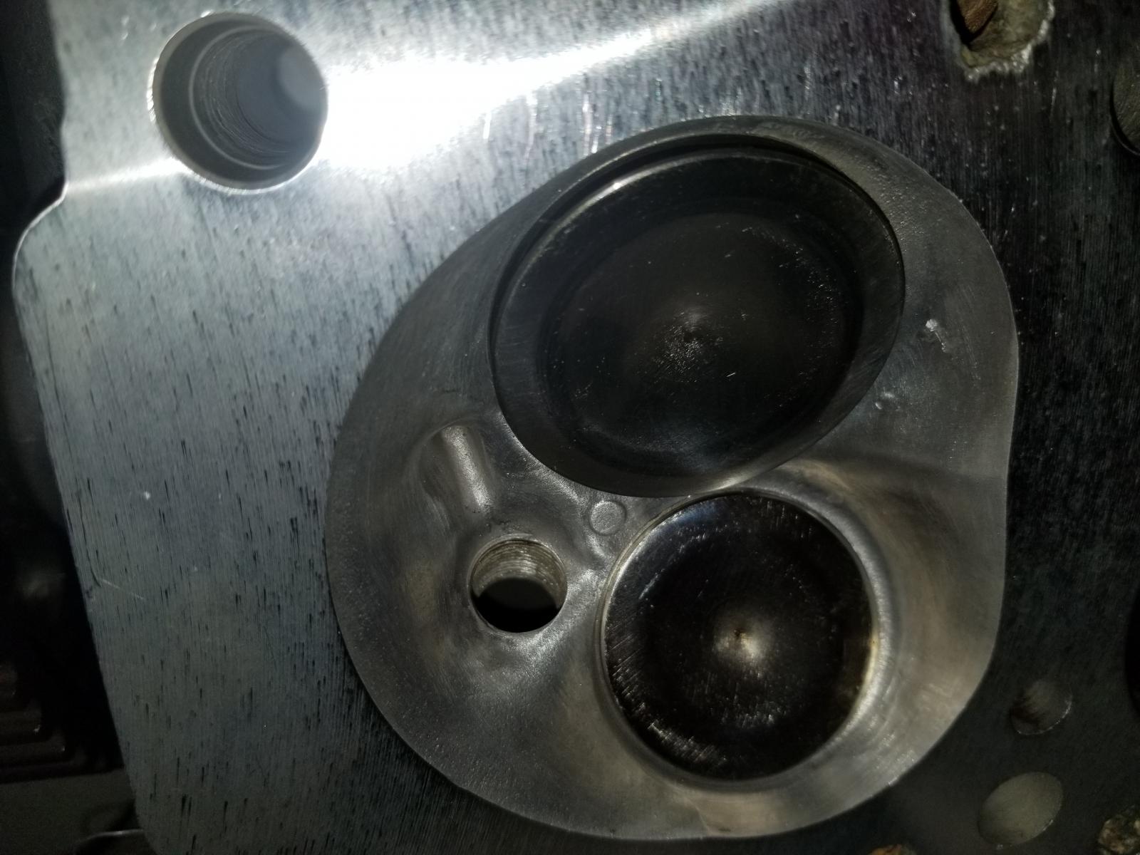

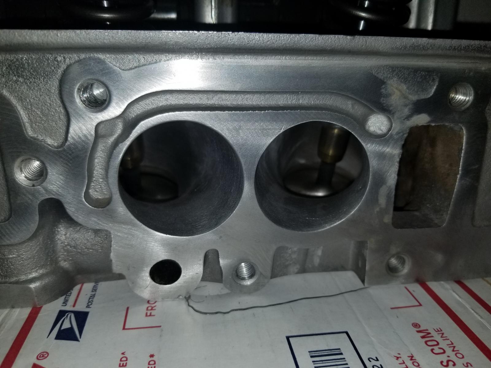

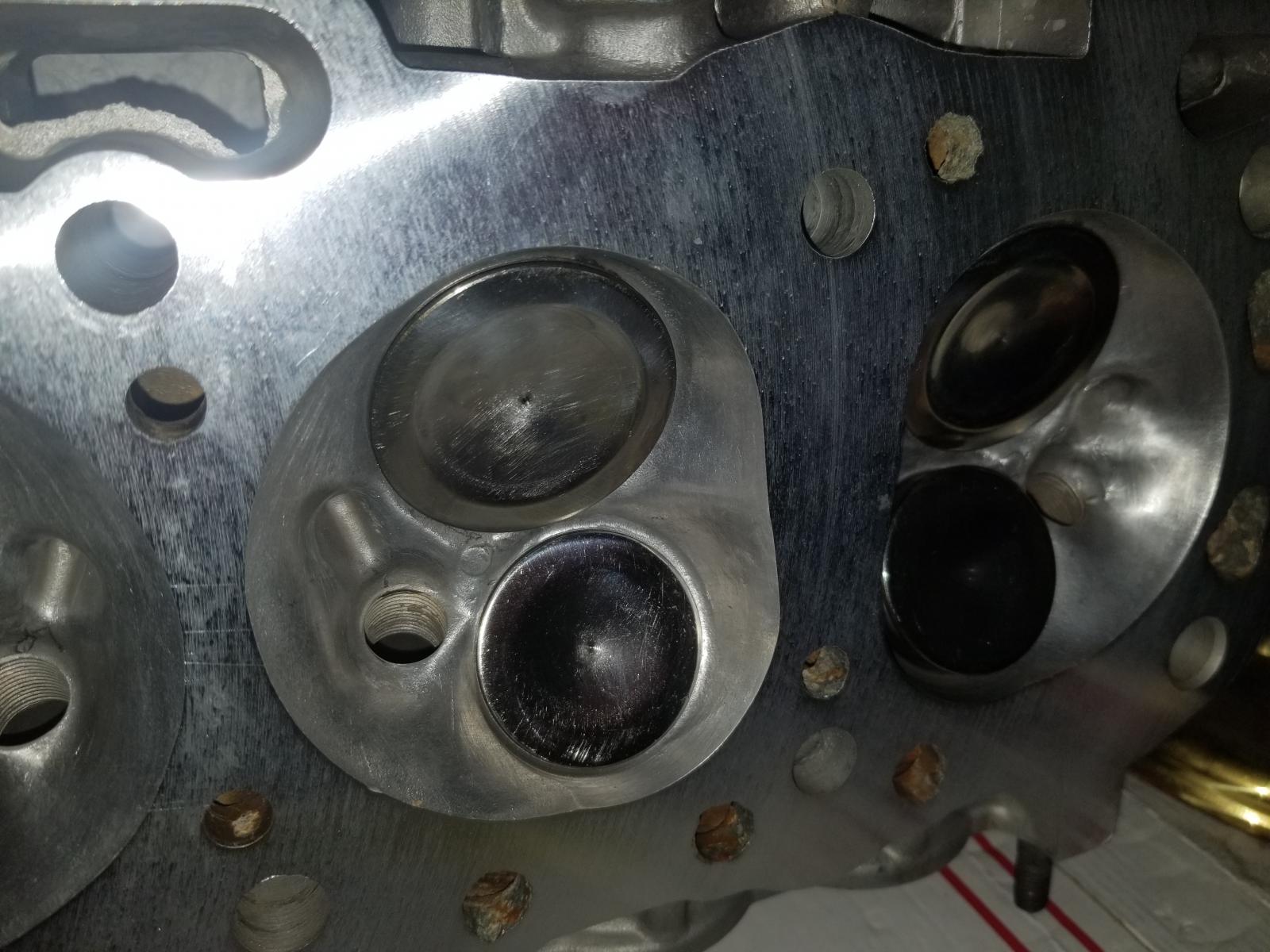

    I fell the same way about the sohc making power,

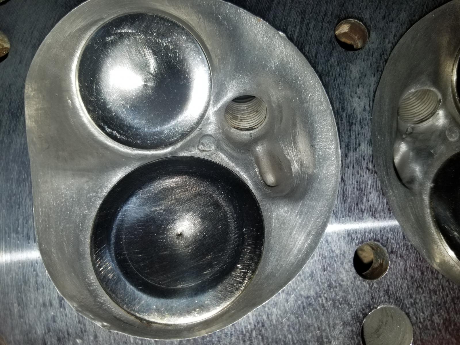

    That why I had a cylinder head ported and polished with oversize stainless steel valves, springs,chromemoly retainers,and the cam 20191205_093933.jpg
    Nice port work Taking some metal off the valve guide shrouds on the intake side definitely helps improve flow - you do the work or did you get a shop to handle it?
    09-26-2014
    494
    Ca
    1993 Dodge Ram 50
    Rahtid
    Could I impose for pics of the exhaust port work ?
    Thank You.
    Further, there is a huge amount of info in those pics .
    With permission__
    The surface pattern on the head was created by an rotary broach ?

    That head looks line prestine work by the way!
    Image #7 is exhaust ports. Looks like the port walls have been smoothed out and the guide shroud has been ground back but the overall port size hasn't been tampered with. You didn't opt to seal up the EGR gallery through the head from #4 exhaust port?
