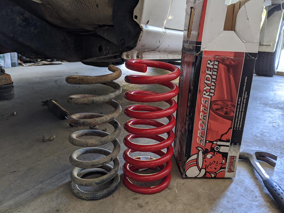

Here is the stock spring compared to the new sports coil
Attachment 24979
Unsprung, the two are not too different in height, maybe 20mm differnece. Turns out this shows in the final ride height, which sucks because I just installed 50mm (2 inch) drop spindles and now I've jumped up 20mm (almost 1 inch). And I really liked the ride height I was at before.
I'll give them a couple of months to settle, see if they drop at all, but I've done 60km in the ute today and see no difference.
If I have time later in the year and it still bugs me I'll take them out again and cut a coil out. Just not looking forward to it as they were a pain to get in, hopefully because they'll be shorter they will be easier.

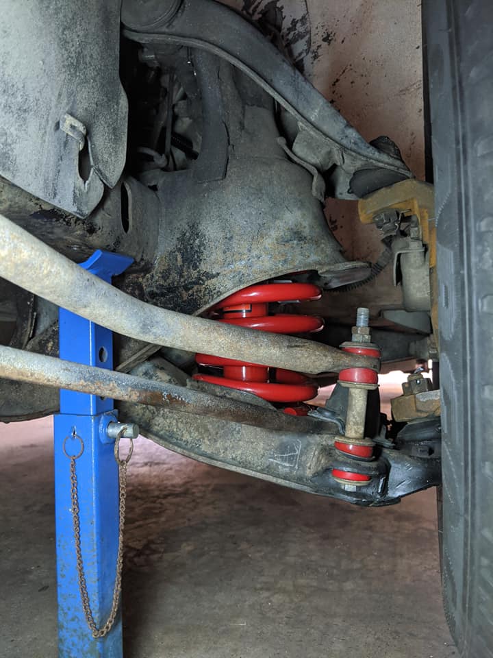

Attachment 24980
Here is all the goodies put together and off to get a wheel alignment. Will have to clean these up and give them a coat of paint to make that red pop! Again, regretting I didn't take the time to paint parts before installing them, and not taking more photos!
On the upside the old girl drives so much better now, not harsh, but firm and no longer hitting the bumpstops on any small pothole in the road. Stays much flatter around corners too, but I still want more sway bar action. My last car was a 2010 mini cooper and that thing handled like it was on rails, and then I swapped out the sway bars in that too. So now I am (foolishly) trying to get this long heavy thing to feel the same :lmao:
