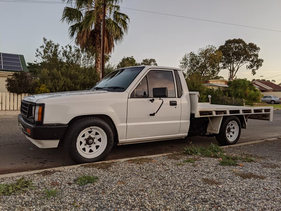

    Hi There,
    New here, but thought I'd get a start on a build thread for my ute.
    Its a 1991 Triton/MightyMax 5 speed 2.6 tray top.
    I am a Design and Tech High school teacher and I take the ute in to work on fridays and work on it with some of my students during our club time every friday arvo.
    Started life as a government vehicle for a rural hospital so it didn't see much use and was well cared for. How many people owned it from there I don't know, but at least 2.
    The previous owner who did some of the initial work to the ute was a bit sloppy and most of the work I've done so far is just redoing his wiring etc.
    Work done by the previous owner:
    the wheels and tires
    tray top swap for towing dirtbikes
    "sports" exhaust aka muffler delete and high flow rear muffler
    4-2-1 headers
    shaved and recon head for higher compression
    LPG duel fuel set up
    retrimmed bench seat in black leather
    sports steering wheel (Made driving the manual steering painful)
    new stereo and speakers
    I have since:
    rewired the stereo
    actually cleaned the car (the last owner bought it as described above and couldn't drive it with the little wheel so it sat for a year before I bought it from him)
    new air filter
    instrument cluster swap for tacho
    "modified" junkyard tray sides because it had none
    power steering install
    removal of the worlds most janky killswitch
    3D printed gauge cluster that fits in stereo location
    and likely a bunch of other small things I forget
    Next on the list is fixing more things done by the previous owners, lowering, handling, dedicated LPG setup and an oversized supercharger!! yay
    Maybe bigger wheels, the current ones seem like they are a bit smaller than stock (205/65r15)
    So here she is, more photos to come, its been raining a heap recently so I have not been able to do much work.

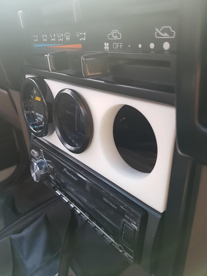

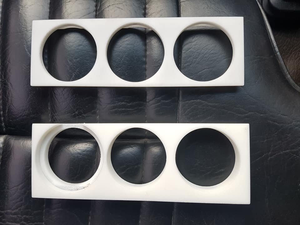

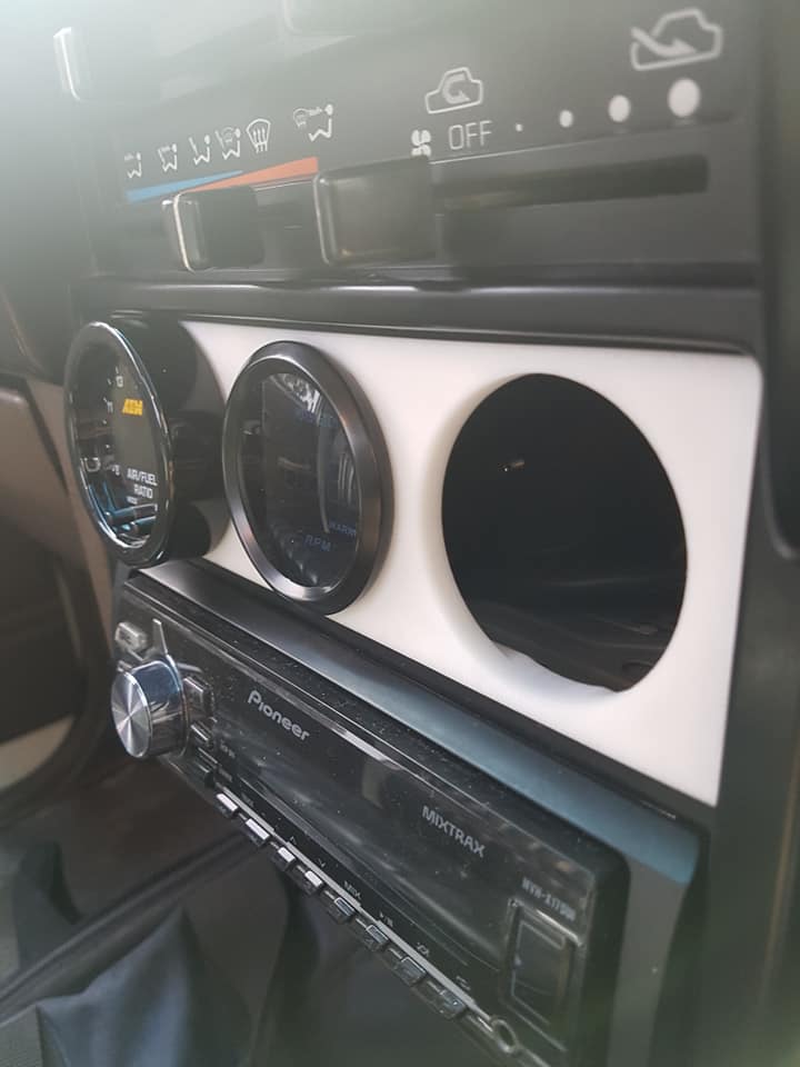

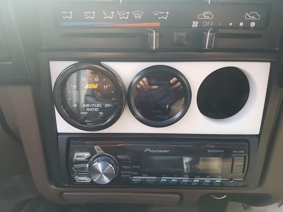

    So today I re-modeled the gauge cluster I designed to fit in the Mighty max dash. Because the wideband I ordered has a much deeper bezel than other 52mm gauges it stuck out way to far for my liking.
    The new piece has a sunken area for the gauge and is 5mm thicker on the front to try and level things out a bit.
    Ignore the RPM gauge, thats just a old busted gauge for test fits etc
    Here is the original 3D printed cluster with the wideband sticking out too far
    New cluster
    Here is the new Vs old cluster
    New set up all ready for some primer and paint, unless I can get some affordable black ABS filament for the 3D printer and then I'll print a new one and smooth it off with acetone
    Cheers
    Alec

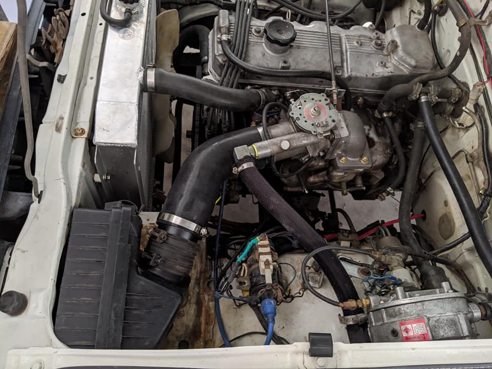

    So I've finally found time to get more work done on the ute. For the last 6 months life has gotten in the way a bit.
    The biggest change will be the new fuel system. I installed a Gas Research Australia throttle body and converter. The adaptor didn't quite fit as it had the throttle body pointing straight forward into the thermostat housing. I cut a pie shape out and welded it back together at work, although it was still close to the radiator hose. To fix this I got a thermostat housing off of a magna which points the hose a little higher up and straighter towards the radiator.
    Speaking of the radiator, that's new too, well new to me. It's an Australian made alloy for a V6 4x4 triton (mighty Max). I got it from a wrecked ute, but because it's for the 4x4 it is taller and I had to space it back towards the engine.
    The engine now breathes so much better and pulls way harder than before with the performance LPG system (and a propper tune of course)
    The engine bay is also heaps cleaner and is continuing to get cleaned up more, just check out how bad the wiring was before

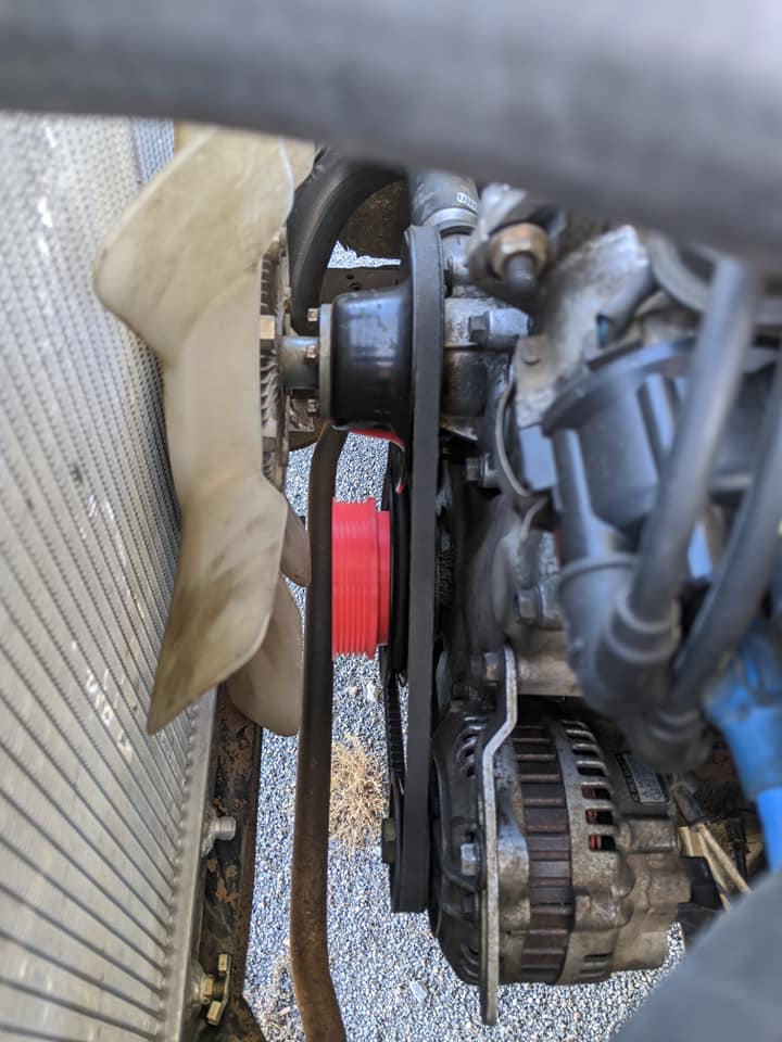

    I also did a test fit of the super charger pulley I am getting made up. it will be a long time before that gets made a mounted so for now I think ill get the Paris Dakar cam upgrade to get some better drivability out of the ute. Its already noticeably better than before (it actually revs past 4500 easily now) but I would like to do the swap.

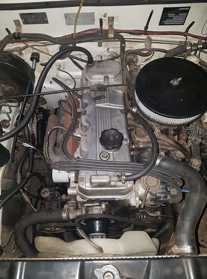

    questions !!!!!!!questions !!!!!!!

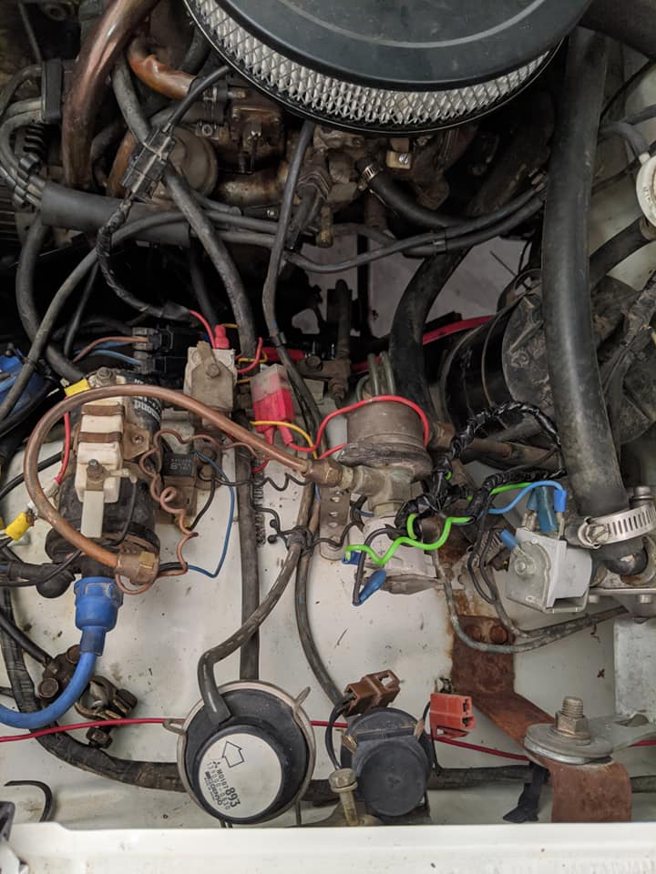

    1)picture 2 & 3 should be reversed ???
    2) picture(s)of the propane tank(s) mounting & certifications.
    3)Material for the crankshaft pulley.
    4)Paris Dakar camshaft upgrade??? Petrol engine ????
    ^I'm getting an "image URL expired" error message. I'm not on FB but that shouldn't have any effect on viewing an image.
    07-22-2019
    42
    Adelaide - Australia
    1991 Mitsubishi Triton
    Pictures display perfectly for Me.
    With Humble respects AlecBB
    Picture 3 is there under the paragraph that mentions it (that is how the wiring used to look) pic 1 and 2 are the before and after.
    I don't have pics of the tank but I can get some if you want them.
    It is located under the tray just like the petrol tank but on the driver's side.
    The pulley will be aluminium, that test fit was a 3d print.
    The Paris Dakar cam profile is what the cam shop calls it, from what I've heard I think it is inspired by the profile used in the Pajero when it raced in the Paris Dakar..... I think? Should be fine with the lpg, I'll have an adjustable cam gear on it.
    Cheers

    Lower and slower
    So its school holidays over hear, which means I'm off work (sorta) and car stuff can get done!

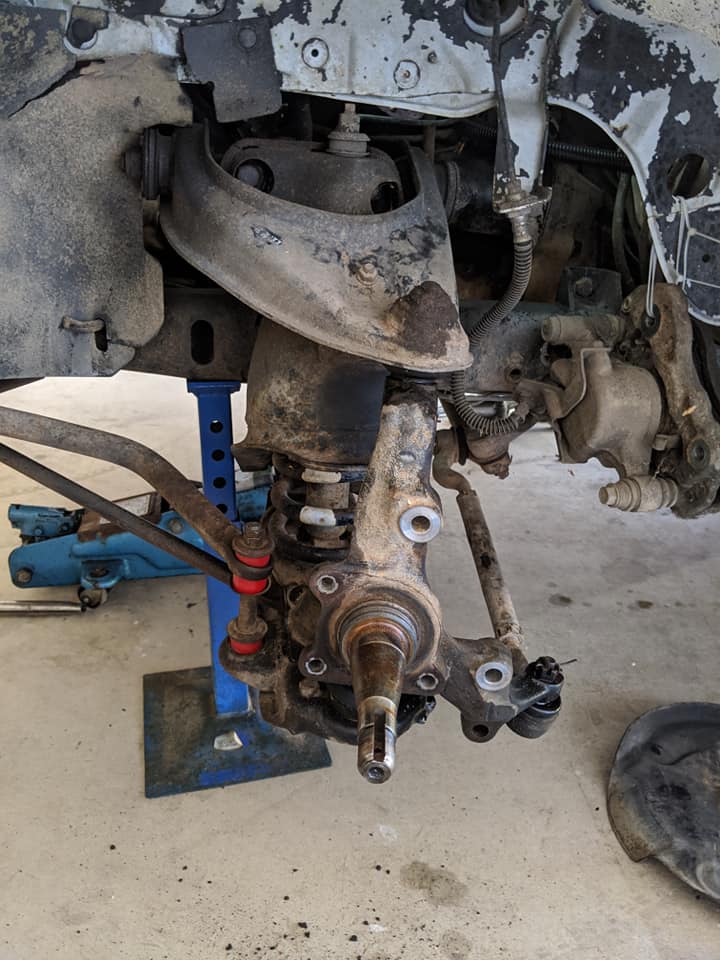

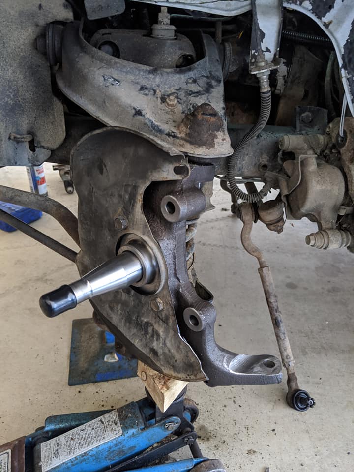

    First up I finally found time to install my drop spindles that I ordered over 6 months ago. This was easier than I thought and the fit is great. I definitely need stiffer springs though, the stock ones are worn, soft and sag about 15mm lower on the drivers side. Running over manhole covers and potholes before the spindle install I would hit the bump stops way too easily. Now I get tire rub if I'm cornering and hit a bump, so I'll roll the fenders and look into springs.
    Out with the old
    In with the new
    The toe in with the new spindles was shocking, I had to wind both my tie rod ends in all the way to get them close to straight, then tidied it up with an alignment the next day. (I was 1.5mm out just by eye, which Im happy with)
    The only regret I have is not painting the spindles before hand.

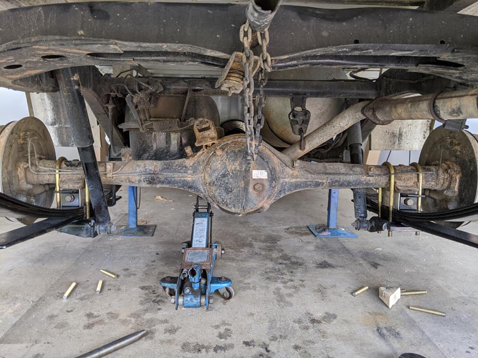

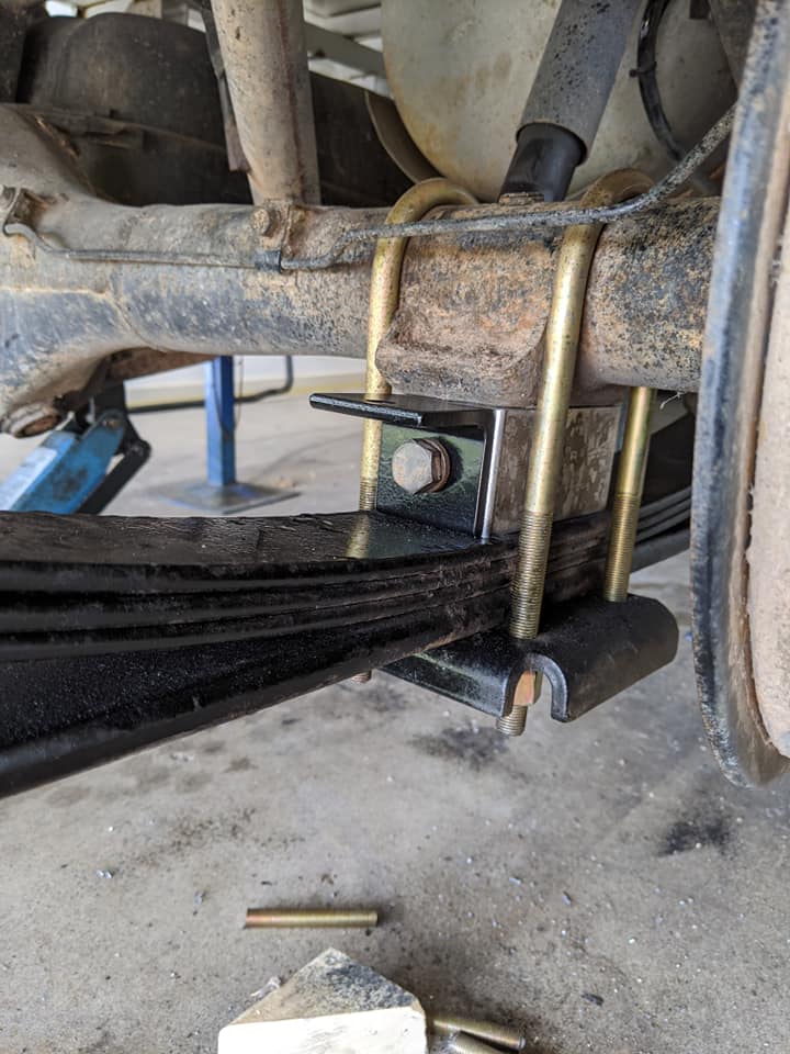

    While I was at it, I also dropped the rear 50mm to keep everything level. I also painted the springs and the inside of the wheels black while I had them off to save time later. Now that the springs are done I want to paint the whole rear end, but thats a job for another day.
    94257491_10222672398548082_1141464116704051200_n.jpg93864609_10222672398748087_2129002330710867968_n.jpg

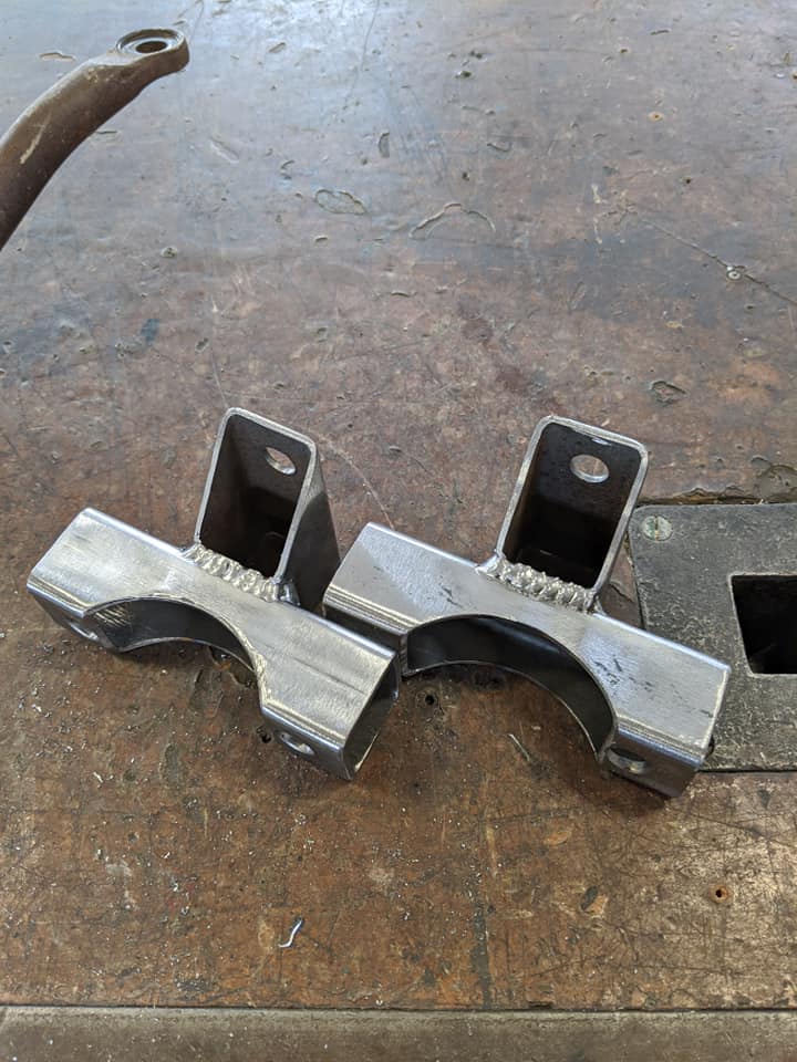

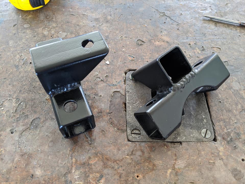

    The bracket on the back is for an idea I have for mounting a Pajero(monty) front sway bar in the back. I just drilled and tapped a hole 50mm deep for a M12 grade 8 bolt and drowned the sucker in locktight, shouldn't go anywhere.
    I did make some other style brackets that were going to bolt on over the axle tube but I didn't like how they were positioning the bar so I went with the simple bracket on the lowering block instead.
    Here are the other ones that I didn't end up using
    94114188_10222673989267849_2609475786628923392_n.jpg94072220_10222673989507855_1300327745733001216_n.jpg
    Anyway, more on the sway bar idea when I get to it.

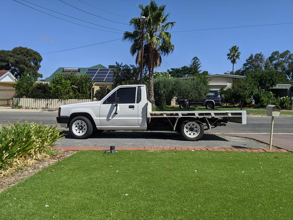

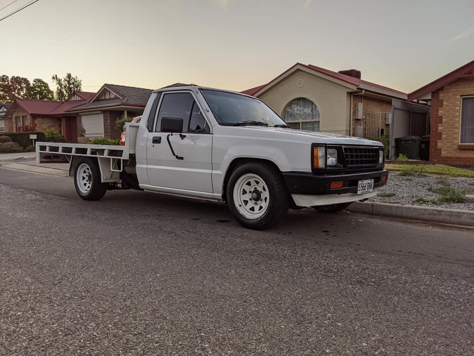

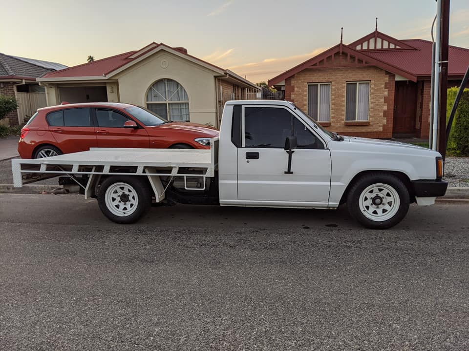

    Here she is all washed up and sitting a little lower.
    93670738_10222672397908066_9094493846556901376_n.jpg94229401_10222672397708061_3918361954778873856_n.jpg94258525_10222672397508056_8228516594439946240_n.jpg
    While I was at it, I detailed both my cars
    I also went to U-Pull-It and got myself some twin piston calipers from a pajero which I will fit up soon. As well as a Pajero 85Amp alternator which I am going to see if I can make fit on my 4g54. The plugs are the same and I have an idea for how to do the bracket. I chose this one to mess with as I could get the second hand one for dirt cheap and if it works I can order the 100Amp version new for only $97 and it will drop in.
    I am going the the effort with the alternator because of the electric pump and radiator fan I will be installing will draw a bit of power. Not to mention the electric assist steering from a toyota prius I hope to mess with.
    As you might have noticed in the first pic I also installed Nolathane sway bar end link bushings, I also did the sway bar bushings and the strut rod(caster rod) bushings, boy what a difference a couple bushings made, I cant wait to do the rest of the suspension.
    That's all for now,
    More to come soon I hope!!!
    Cheers
    Alec.
