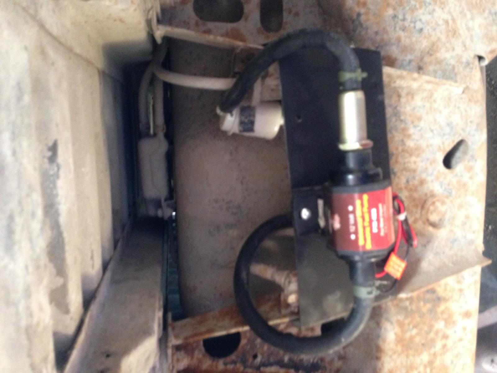

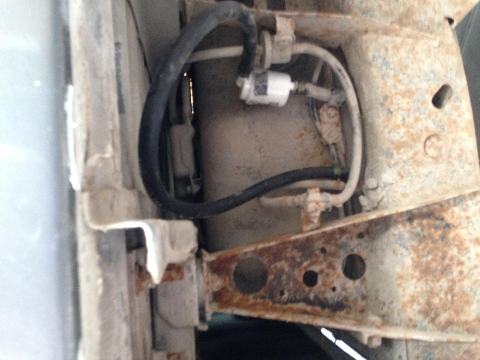

Before and after of the fuel pump install, still need to build a cover for it, add some fluids hook up the new carb linkage and fire it up.
Make sure your fuel hoses are either well secured or sheathed. You don't want the hoses to wear through on anything metal.
It's in a good location - nice and high but accessible. A shroud will go a long way to prevent debris from hitting it. Make sure it won't collect dirt and water and it should be rock solid. Let us know how your test run goes and feedback on the pump and your set up. It will help members with future installs :thumbup:
