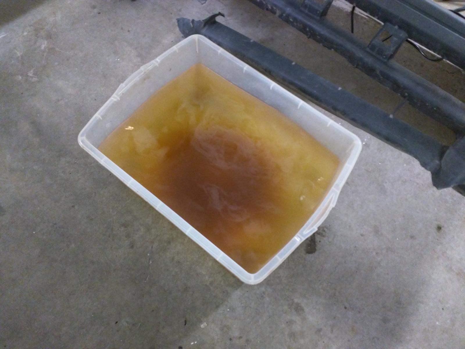

when you pumped out all that fuel you didn't happen to empty the tank did you? just a thought. if your filter is semi-see through, i'd shine a flashlight behind it & look in & double check it for gunk if your tank got down to E in the process of checking the fuel pump.
