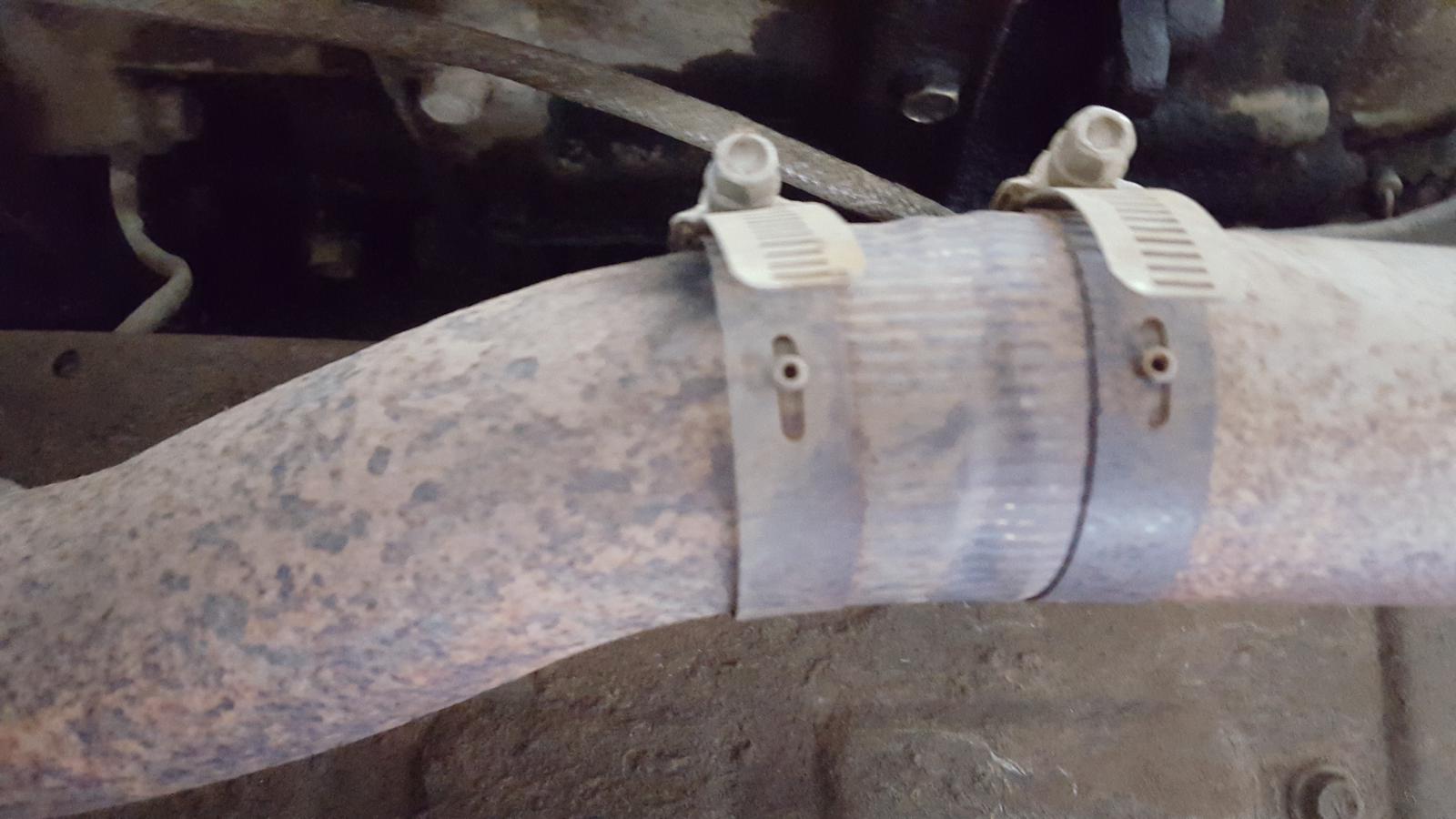

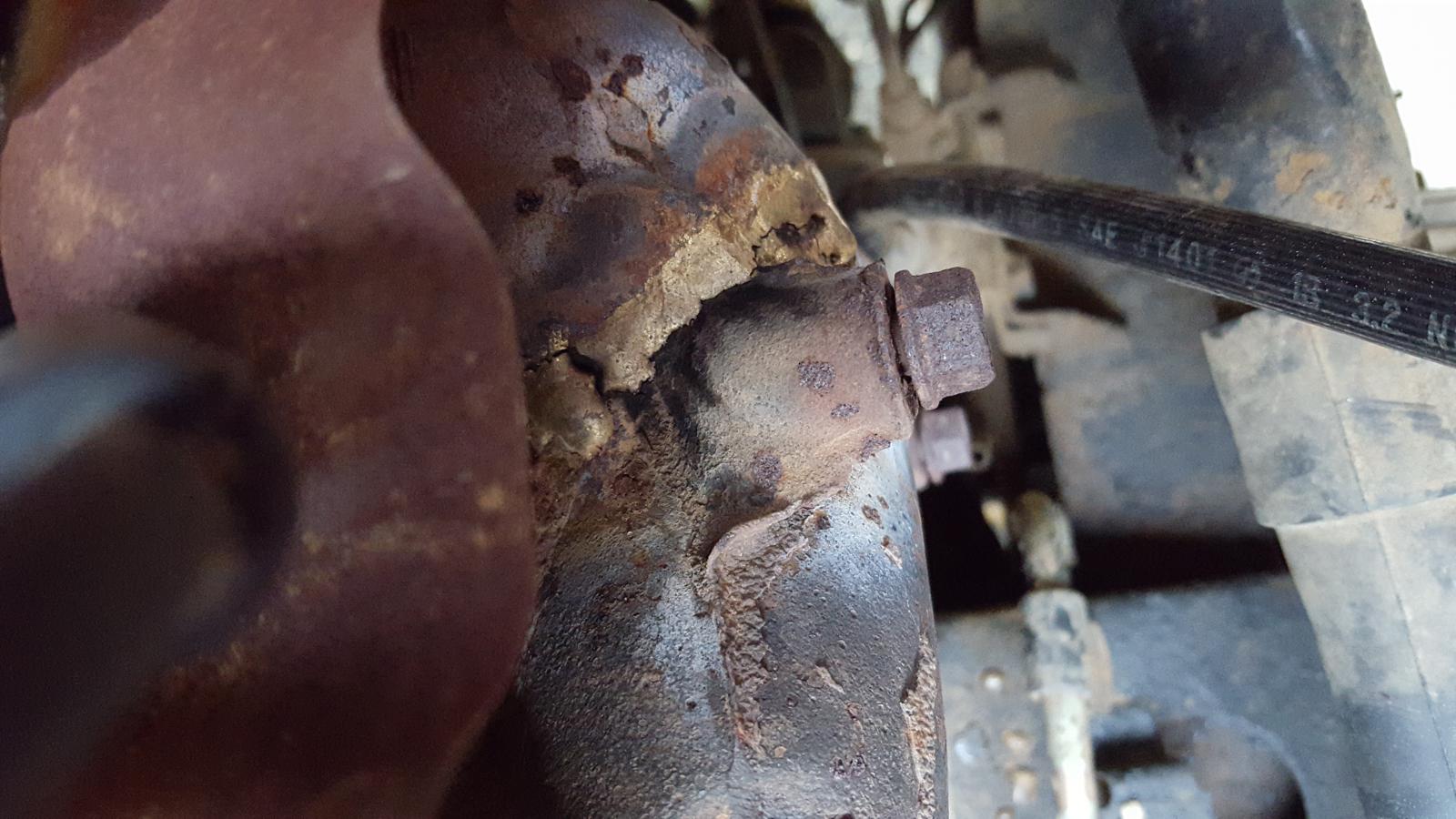

There is an exhaust leak from the right bank manifold to the y-pipe (old gasket), and it makes an audible noise that will also be remedied before the teardown.

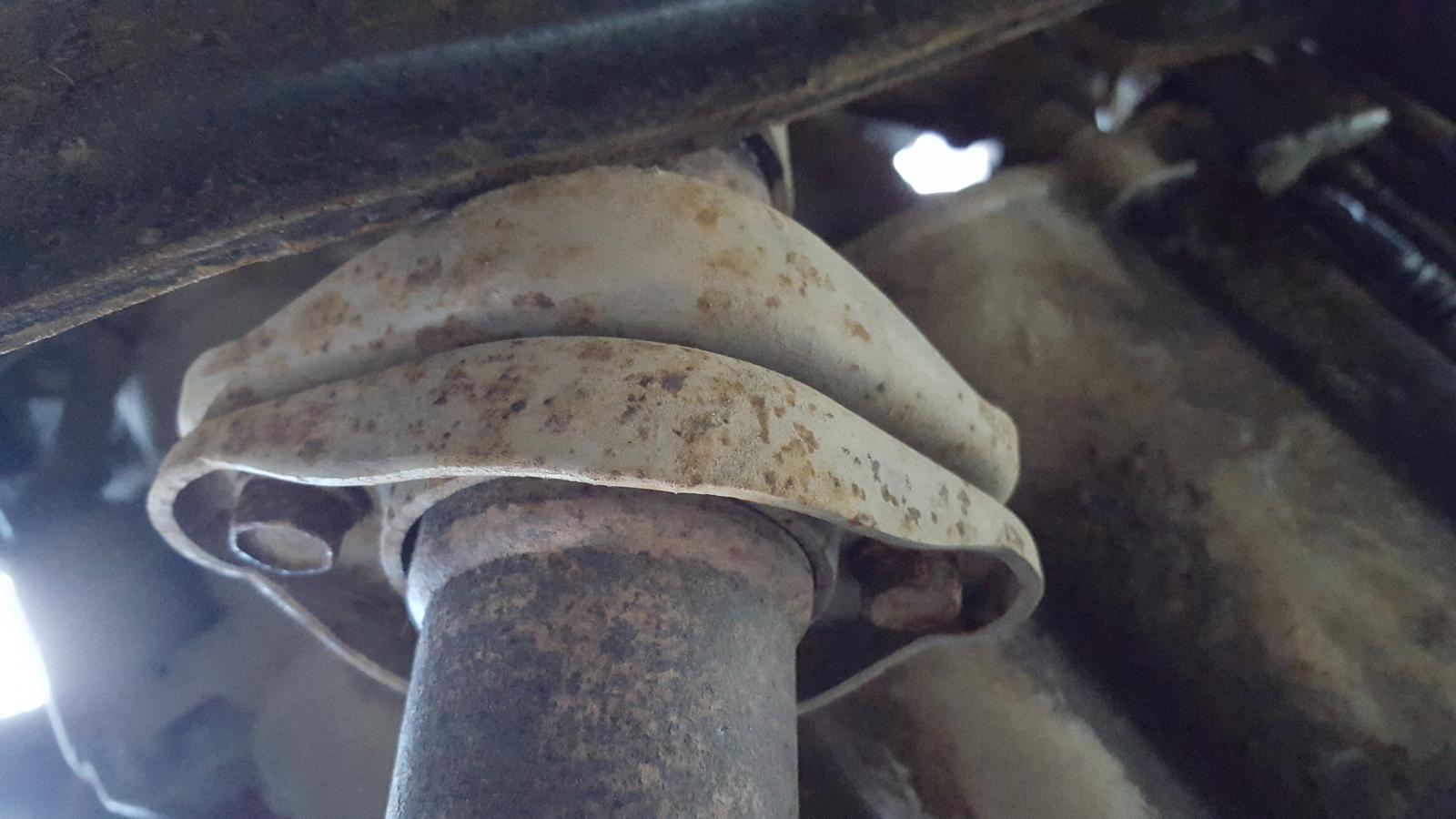

The exhaust is not a strong point for this build ATM. It is a known temporary component and has not received much attention due to the redundancy of perfecting it. Don't worry, it's all going in favor of dual 2 1/2" stainless piping all the way back (with an x-pipe for the O2 sensor just below the passenger foot-well).

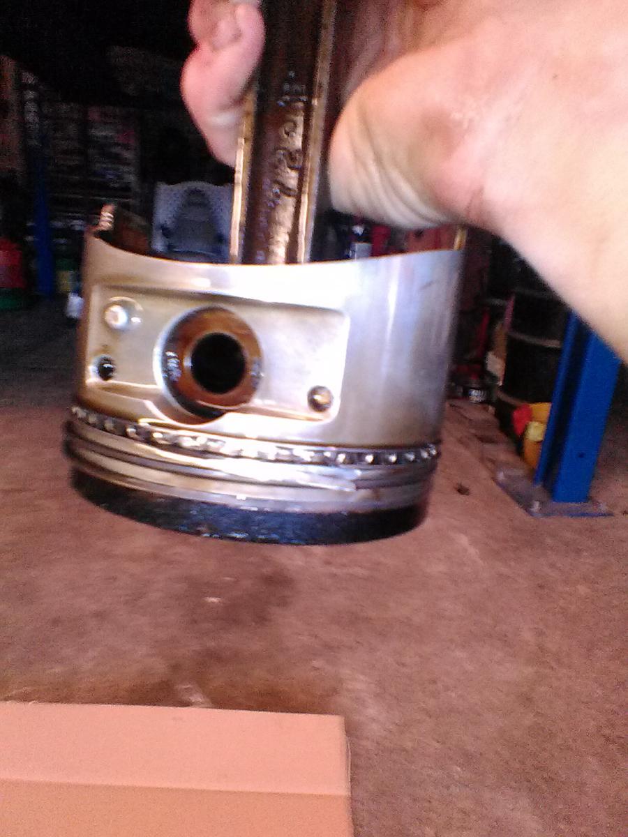

Anyway that brings me to the findings... Spun rod bearings on #2, #4, and #5. The lower oiler retainer ring on #1 folded over, gouged out the cylinder wall, cracked in several places, and smashed the oil ring land on the piston. Even the rods that still had good bearings seemed scored, and all of the unspun bearings were elliptical rather than hemicircular when removed... As far as I can see the block is shot until it can be bored out, and the crank and rods are probably in need of repair and/or replacement.
Here is a picture of the ring damage on the #1 piston. Apologies for the quality, I had to use my phone.
