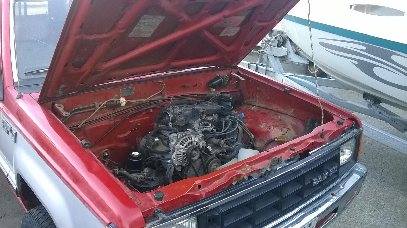

    Well, I've finally gotten fed up with the 2.6l slushbox combo, and I'm ready to move on to bigger and better things.
    I'm about to attempt the 6g72 SOHC swap in my second gen power-ram 50, and I'm bringing the montero's 5 speed/transfer case along for the ride. I've heard that this swap isn't too unusual, but my further plans for the motor probably are. I want to twin-turbo/twincharge the thing. I've already picked out turbo's and a supercharger (the turbos are from a vr4, and the supercharger is a Paxton SN89). Reliability is sure to be an issue here, but I'm not afraid of fabrication, and I'm not shooting for crazy hp. Whatever power the final build makes will be plenty, and my primary concerns will be cost (within reason) and reliability (also, within reason).
    For the swap, I'm expecting the need to fabricate/replace:
    -A one piece intake manifold
    -Both exhaust tracks
    -the intercooling system
    -motor mounts
    -tranny mounts
    -any parts needed to prevent interference
    -any parts needed to install both of the turbos and the supercharger
    -both drive-shafts
    -both axles
    -most of, if not the entire, electrical system
    Basically I was wondering what kind of issues that I might face, which parts will be prone to failure, and what I should also replace to maximize reliability.
    I'm hoping to stick with the SOHC, and it needs to stay manual and 4wd. Any alternate turbo or supercharger suggestions would be appreciated, as I am new to forced induction (though I understand the concepts). Once again power production is not my primary concern here, a semi reliable 350hp truck would be better than a 1000hp self-destructing monster.

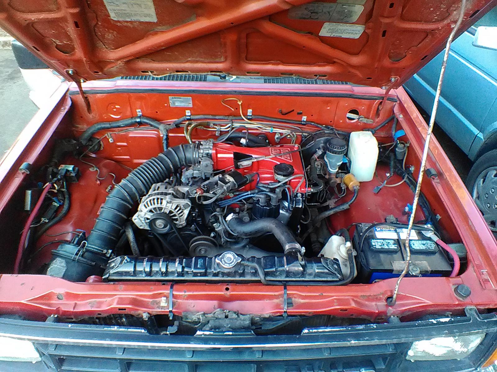

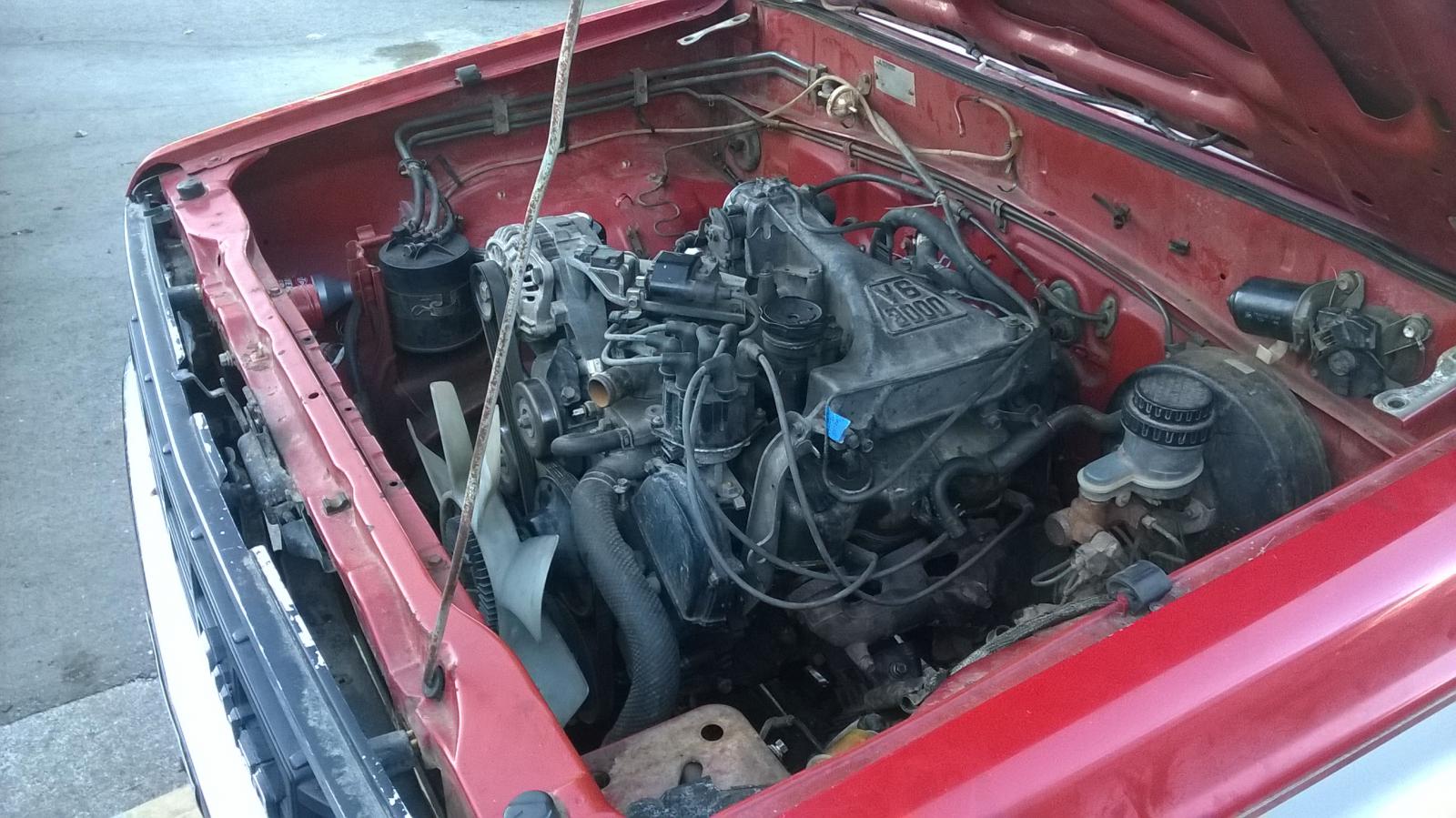

    Here are a few pictures of the thing for reference:
    As the project gets off the ground I'd be happy to post pictures of the process for those who are interested. I'm also part way through swamping a dodge raider dash into it.

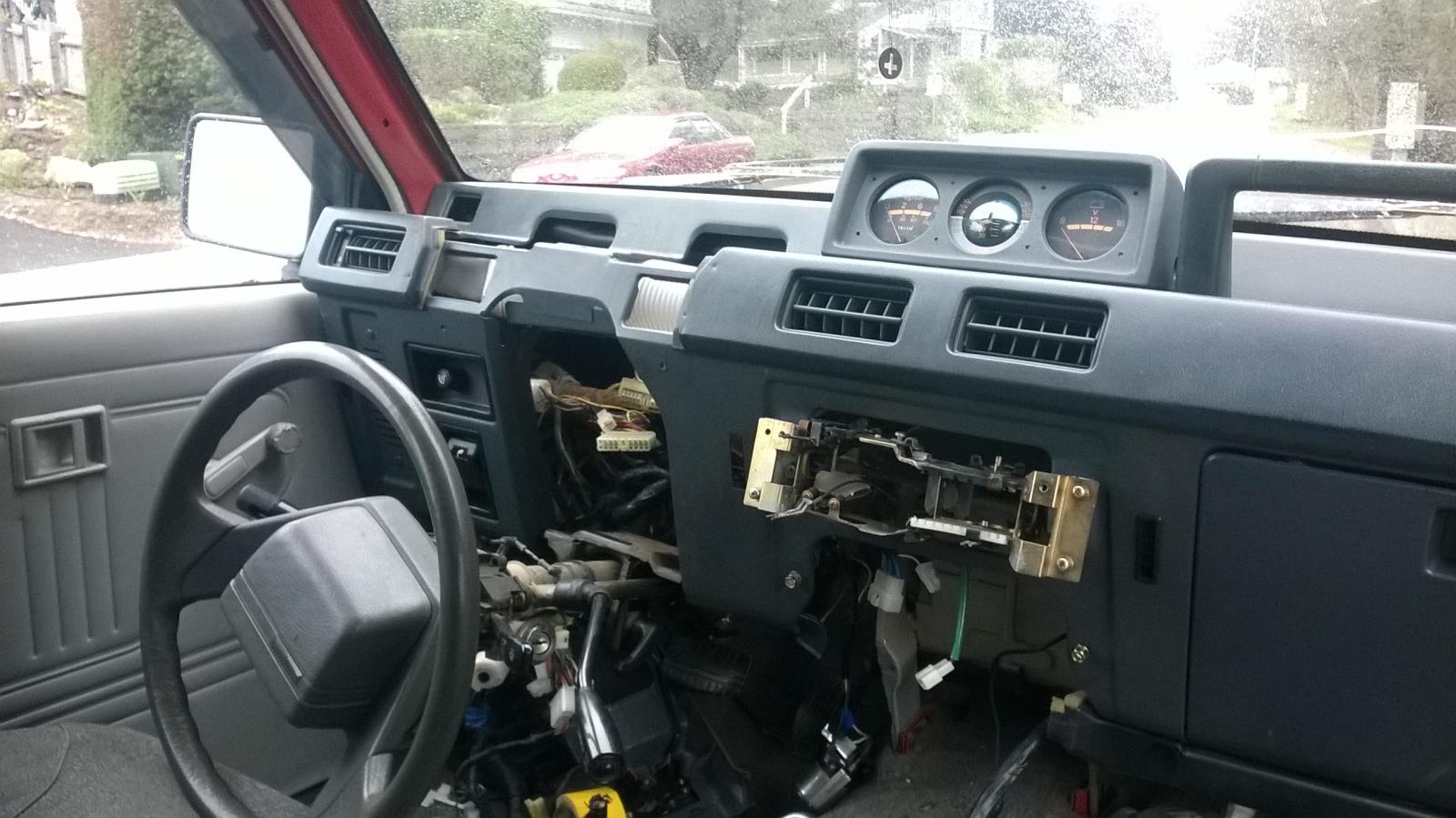

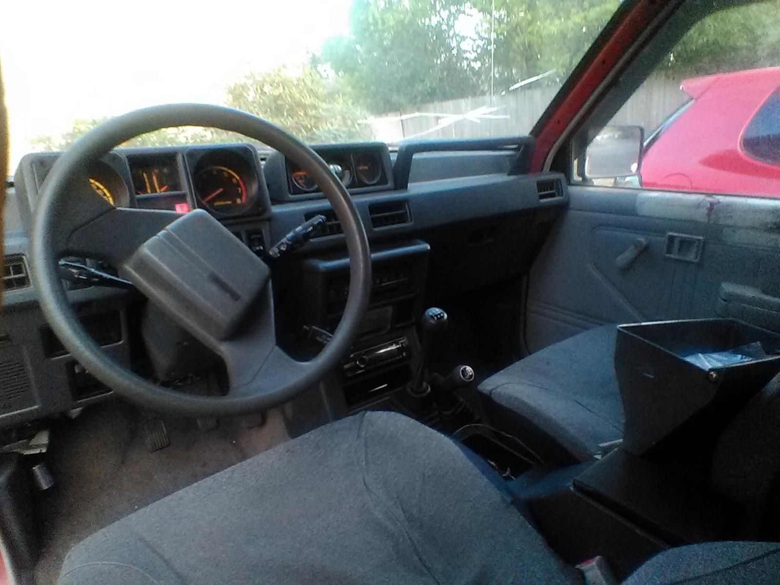

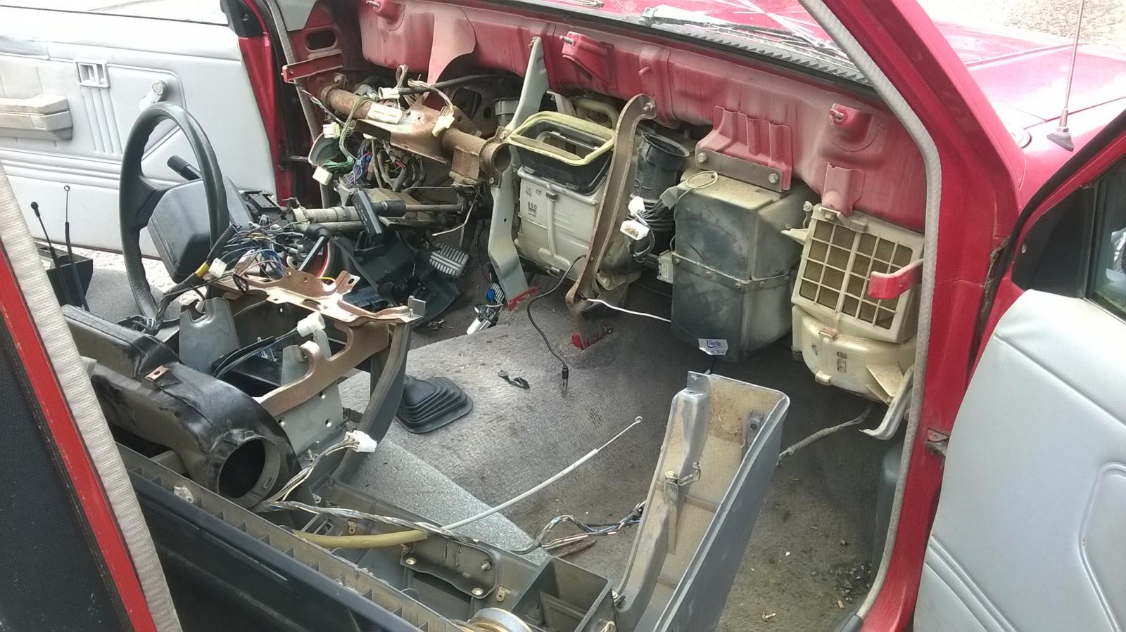

    Figured I'd put up a few pictures of the dash install. The stock dash came out fairly easy, and if you've ever wondered what it looks like behind them, I'd go with dusty. We couldn't resist setting the raider dash in place, and from what I can tell the biggest hurdles are going to be with wiring, providing clearance for the parking brake, and unfortunately leaning in the top front corners of the dash about 1cm on each side. As it sits in the picture it's around 4 inches too close to the driver on top and according to the inclinometer (which is oddly handy in this situation) it's also leaned back by ten degrees.
    The raider dash looks well enough at home here, though that subtle color difference will probably grate on me.
    Any thoughts on how to wire up the darn thing? So far i'm torn between splicing together the two harnesses wire by wire, and just replacing the whole harness with the Montero one. As always any bits of advice/opinions are greatly appreciated.

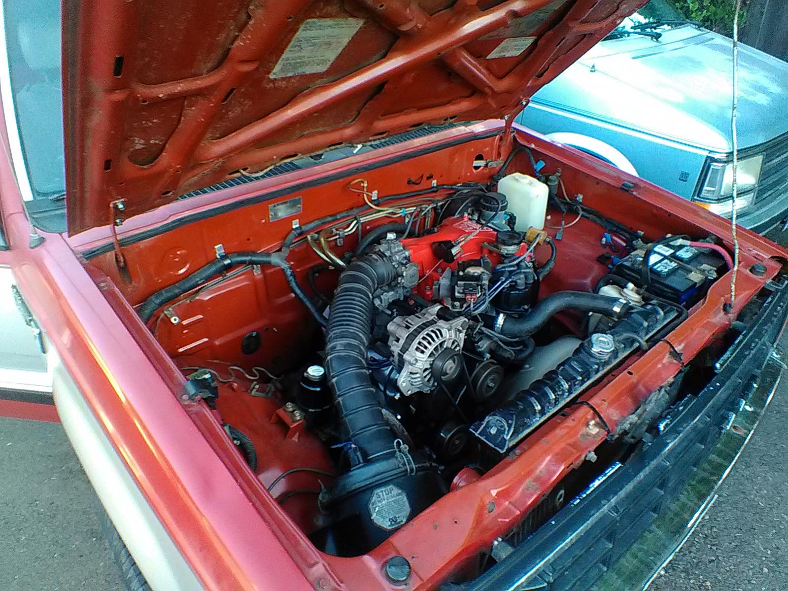

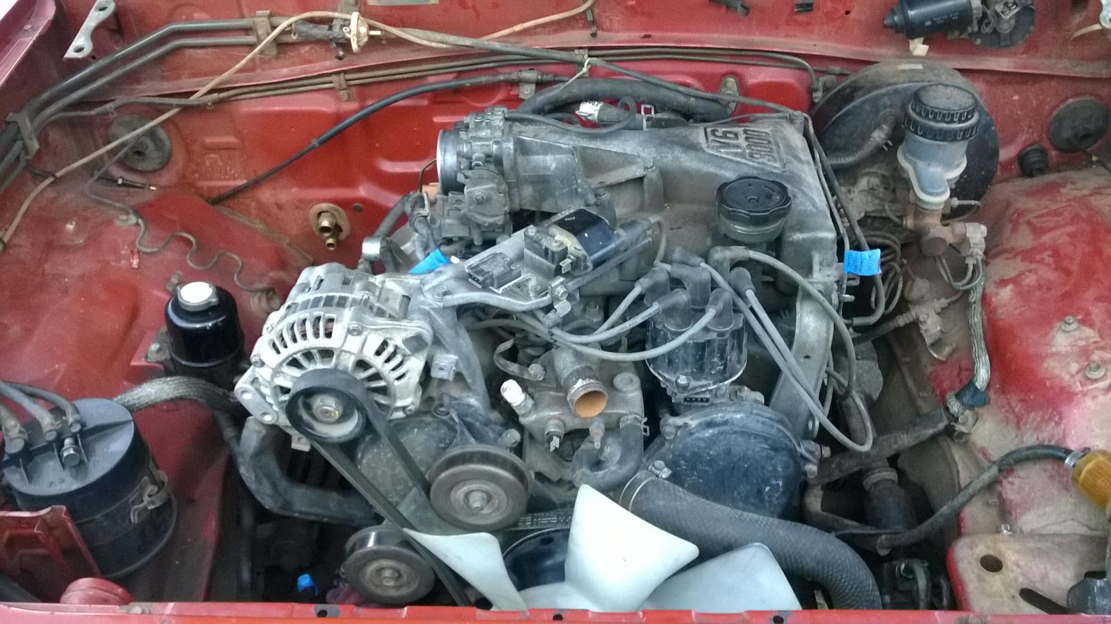

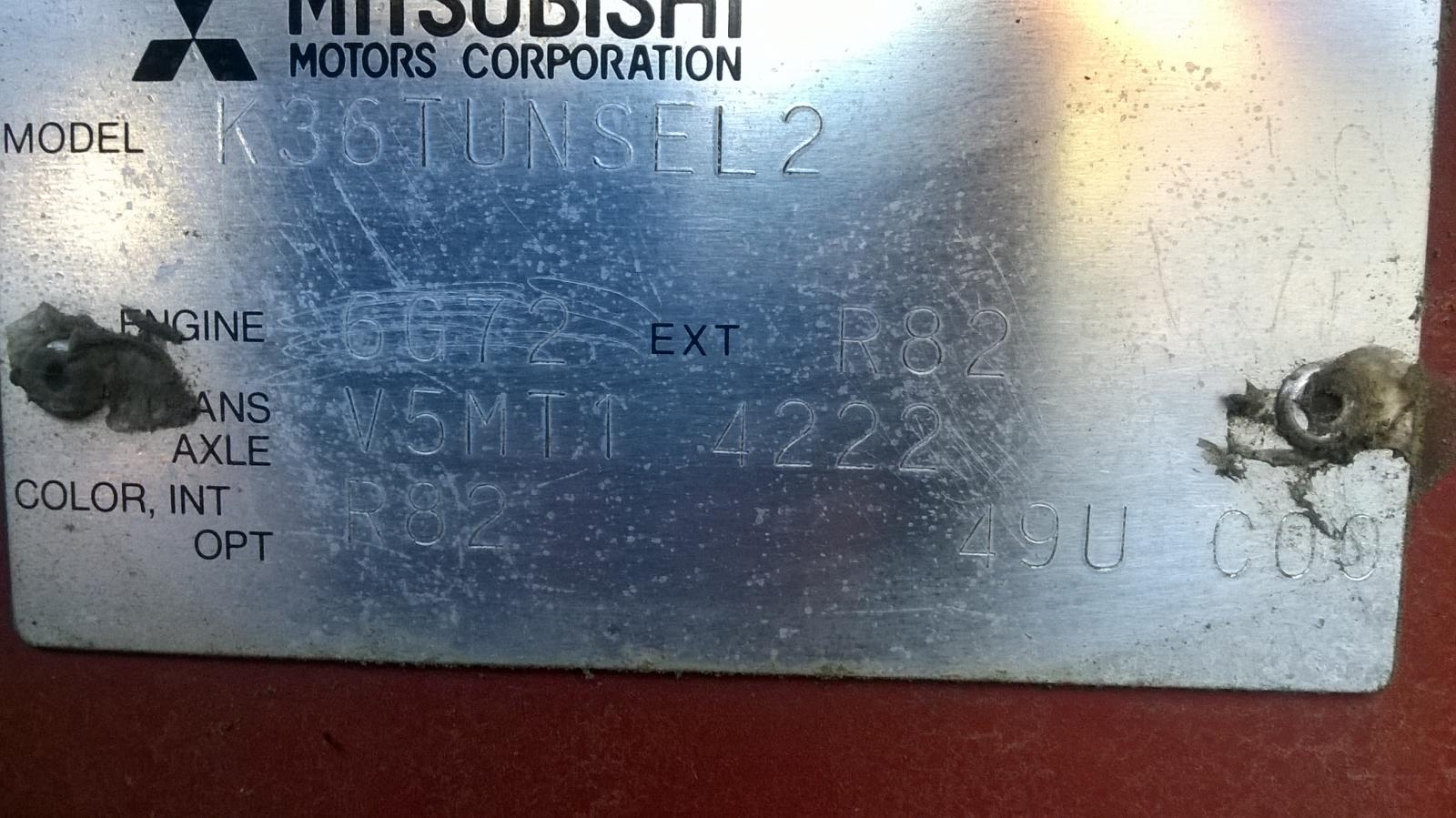

    Ok It's been a long few weeks but the motor and trans are in the truck. Here are a few pictures.
    I've done a whole lot of research on this particular swap and every thread that I have found has either claimed that it's been covered many times elsewhere, or merely states that it is possible. Well that first one sure as heck ain't true so I'll just go ahead and immortalize it here.
    The Swap:
    Starting with: 1988 PowerRam 50 4X4 Ext. Cab W/ 2.6L G54B and factory Auto trans. (Meaning that if you have any 2nd gen mighty max or Ram 50 with 4X4 this is applicable to your truck.)
    This swap pertains to replacing the 2.6 with a 3.0L V6 (6G72 SOHC) out of a 1990 Mitsubishi Montero, and replacing the auto trans. with a 5 speed out of a V6 Dodge Raider (V5MT1-1)
    More simply:
    2.6L I4 (G54B) ---> 3.0L V6 (6G72 SOHC)
    Auto Trans. (KM-148) ---> 5 speed Manual (V5MT1-1)
    Pros:
    -The Sticks (shifting levers that is) line up perfectly with the existing hole in the cab, and in my case only required a few cuts to make room for the transmission stick (I had an automatic). The transfer-case stick was fine.
    -The motor mounts lined up perfectly and can even be bolted in. No need to make new ones.
    -The ECU harness is (somewhat) separate from the main wiring harness and the ECU is located in the same place in the Montero as the "Carburetor Control Unit" is in the Ram
    -Gobs of clearance on everything besides the oil pan and the brake lines.
    -147hp NA and can be twin turboed for ~250hp with relative ease using factory Mitsubishi TD04 9Bs. (I got my twin turbos with intercoolers for $200)
    -Pretty easy to do if you are willing to do a full drive-train swap in the first place.
    -If you want to do a dash swap from a raider too (Highly recommended, they look sweet) You can take the whole harness and enjoy all of its cool features like cruise control, intermittent whipers, electric locks, and headlight sprayers (if you're into that).
    -Pretty much turn-key after everything is reconnected (Shouldn't have any ECU troubles).
    -You can contact me if you hit a roadblock and I'll try to help.
    Cons:
    -You will likely need a whole donor vehicle for the V6 to get all the appropriate parts. (try to get a 5 door Montero LS from '87-'90. They have all of the bells and whistles)
    -The oil pan out of the Montero/Raider is completely incompatible with our trucks. The lowest part of the pan hits the front axle and differential within 4" of the motor mounts. You must buy or fabricate one for your truck.
    -Not necessarily the most powerful swap when naturally aspirated (much better than the 2.6 though)
    -Want to upgrade the ECU or anything at all in the motor? I hope you can tune your own ECU and fabricate precision parts because that's all you can do (besides pay a bunch of money to have a shop do it for you)...
    -The transmission crossmember has to be modified (not extensively though).
    -The shifter from the Raider is at an uncomfortable distance from the seat if you like to lean back. Try to find a factory one for the Ram/mighty max.
    -You need to make new driveshafts
    -If you want to turbo it you can't just buy turbo headers or down pipes. You must make them.
    -The V6 radiator hits the factory power steering lines so they must be (slightly) rerouted.
    -The brake lines from the booster are uncomfortably close to the driver side manifold and should probably be rerouted. See for yourself:
    -The battery in the Montero is in the opposite corner as the one in the ram, so modification to the wiring harness is needed (to extend it to the front drivers corner that is. You can't just move the battery to the same place as the Montero's as the location is too shallow for it.).
    -Fuel lines need to be rerouted in the engine bay, and the stock fuel pump is inadequate for the V6.
    -Obtaining the clutch pedal and linkage is all but impossible unless your junkyard has a miraculously un-crushed manual 2nd gen.

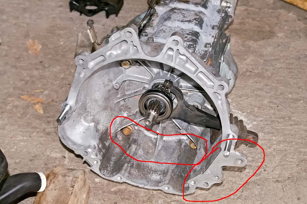

    I am thinking about doing this to my ram 50. Mine has the 5 speed manual now. Do i still need to swap the transmission?
    Thank you
    01-21-2014
    29
    Brookings, OR
    1988 Dodge Power Ram 50
    Quote Originally Posted by idahoram50 View Post
    Thank you
    I'm knee deep in the swap now, so I'll be happy to help. Unfortunately, I'm going to have to hit you with a slew of questions, as I am only familiar with what I'VE done. First of all, I'm going to have to assume that you have a first gen 4wd as you specified it as an '84 power ram. That implies that your trans is a KM 145. If you hope to keep it you will inevitably run into reliability issues, as a little research will show. Let me know what your trans code is (it should be on a metal plate under the hood on the firewall, as well as on the trans itself.) and we can move from there. I don't know anything about the 1st gens but in my case the motor dropped straight in on the mounts no problem. There is a reason that they switched the trans for the v6 rams, and I'd highly suggest that you replace it. More directly, the bellhousings look mighty different to me.
    For reference, here is a picture of the V5MT1-1 bellhousing, a picture of (I think) a KM 145 bellhousing, and a picture of that id plate on a 1990 power ram 50 with the 5-speed. The wiki states incorrectly that the V6 Dodges had a V5MT2, but the plate states otherwise.
    PICT2793-Transfer-Case-Conversion-July-2009-Sharpened-Ninja-1.jpg20150363_sag_km1459_pri_larg.jpgWP_20150728_010.jpg
    The silver lining here is that If you DO choose to get a V5MT1 (out of a 1st gen V6 Mitsubishi montero, a V6 dodge raider, or best of all a V6 ram or mighty max) The sticks will line right up with your existing hole and you should be able to use at least the front driveshaft, maybe the rear as well. Let me know if you have a hydraulic clutch as well.
    Feel free to contact me if you need to know anything about the swap and remember that pictures help.
    If you can drive to southwest Oregon with the means to haul a trans, I happen to have a good spare V5MT1 that we could negotiate on... Can't ship it though.
    Also, check out this link http://www.car-part.com/ if you need ANY parts. (You will almost certainly need a parts car and if they list something mundane like a dash or door panel for one of the previously mentioned possible donor vehicles, they probably have a whole truck sitting there waiting to be scavenged)

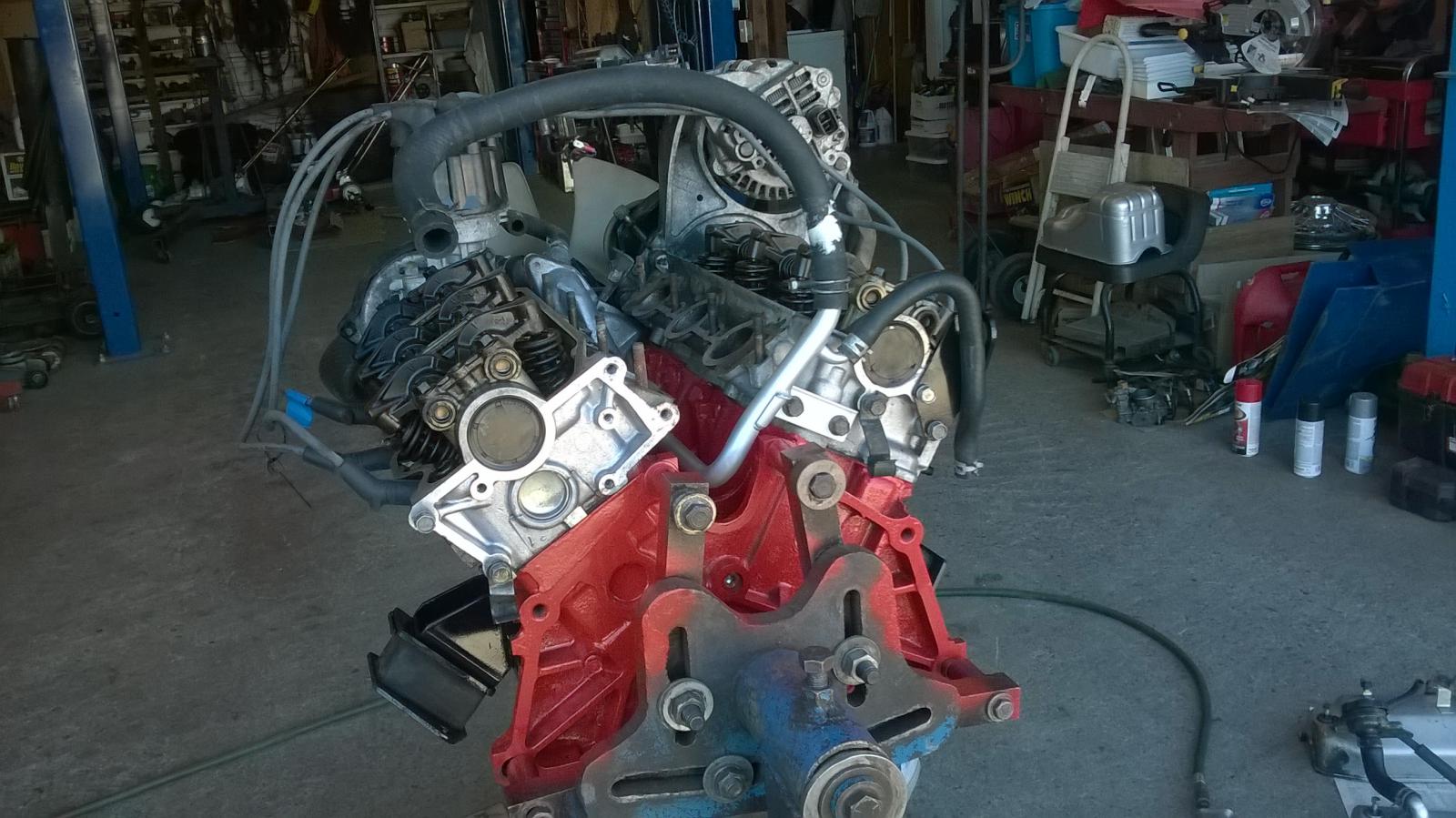

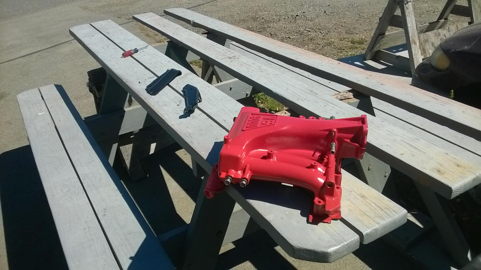

    Quick update. The motor is getting dolled up and the oil pan pictured above most definitely will NOT fit. Had to get a used one from a junkyard (by god was that junked ram 50 a goldmine! Got everything that I thought I had to fabricate right off a factory truck). On that note, don't order an uncommon oil pan from O'riellys, because they are a pain in the ass to return. Just find a junker to strip.
    Oh, and here are a few pictures for those who like pictures. First is the motor as it was yestrday with the CORRECT oil pan in the background (note the dramatic indent for the front pumpkin), and the second is my attempt at making the ugly intake manifold more attractive. I'm going to block sand the raised "V6 3000" back to raw aluminum when the enamel cures.
    While I've got the engine out I'd be happy to take a picture of any component on it or the truck upon request. If you need pictures or measurements for anything you have maybe two weeks to ask me to get them for you.

    Ok so I am pleased to announce that IT LIVES! But is far from done... As per the usual here is a wall of text.
    If you are thinking of attempting this build I will once again outline what I needed to do so, just to do it.
    This rig needed two donor vehicles, one if you get a running V6 ram/mighty max to tear apart (why would you do that though?)
    In my case I had a running Montero 5 door donor(fully loaded), and a junkyard V6 Ram 50 at my disposal.
    Engine:
    A 6g72 from a first gen Montero/Raider will drop right in with no modification. Take the radiator while you're at it, as it is slightly larger, but in order to make it fit you will need the power steering lines from a V6 2nd gen. The engine bay fuel lines could be done custom, but it's easier to take some from the aforementioned 2nd gen (and then done custom back to the tank, fuel injection's a bitch). The exhaust I have now is temporary in my case, but to get it running I was forced to use the y-pipe from the junkyard ram, which is frighteningly close to one of my brake lines (which are different in the V6 models) my line has showed no sign of failure or fatigue, but I would have preferred to get some more breathing room. If you felt so inclined you could take the whole booster and line system from a V6 model to make the clearances more relaxed. I'll update with a picture of the engine bay tomorrow morning. The MAF is clunky and awkward to fit, but given my new harness I was able to move the radiator overflow and washer fluid reservoir elsewhere to make room. When the turbos go on I will be converting to a MAP and megasquirt III ECU.

    Dash:
    This one is only for those who really like it, as it was a nightmare to make work. The Montero/Raider dash is set such that it needs quite a bit of trimming to even fit, and once it does you have to fabricate a brace for the steering column as the stock pipe support is simply in the way (the wheel needs to be moved to the left anyway if you want it to look right). To get it to fit you have to flatten out the beveled section on the windshield side such that the dash goes straight forward from the defrost vents (you will know what I mean when you have one in front of you). Once that is done you will need to trim that section back to where the ark of the windshield is met and it juuuust barely touches the indented section where the defrost vents are. At the corners of the dash bordering the front take a cut straight down 90 degrees to the ground. It wont be very long. There are two brackets on the side that need to be removed from the cab carefully, and the dash will need some small nips on the sides to make room for a few needed brackets, such as the bracket for the steering column. These are all hidden. The Dash has two kicker braces in the middle by the heater core that need to be reattached to the top of the dash by whatever means you find. The top mounts (there are three) will need to be made from scratch, as will the side mounts. The center console needed to have the bottom most cubbie trimmed off, but fits perfectly without it, so there are no uncomfortable gaps. to make it's support fit simple undo the bottom bolts and flip the bottom bracket over. The vents need extensive work to fit, and I have yet to make them work. All in good time. The steering column is straight out of the Montero, and as such need the floor mount from the ram. It's a prick to swap given the grommet, but a little oil and patience will see it off. The parking brake needed a hole cut for it to clear the face of the dash. Don't ask how I got it out in the first place...
    After all of that I gained a sweet new dash, the only one to ever be put in a Ram or Mighty Max, as well as an appropriate speedo, tach, oil pressure gauge, volt meter, that goofy "inclinometer", plus a bunch of real estate for the aftermarket gauges that I will be running (boost, fuel-air, water/meth level, Intake air temp, and maybe EGT and that AEM meth failsafe gauge).

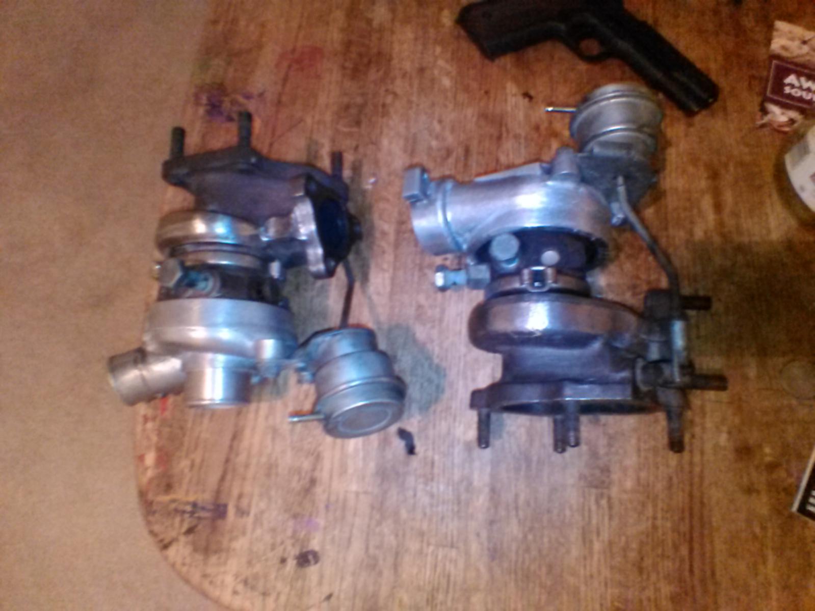

    Here are the turbos btw. Sorry for the crappy picture, just took it a second ago.

    Here are the shots of the engine as promised. Changing my motor from a G54b to the 6G72 in my bio was immensely satisfying by the way . I only wish that I could select the G54b as the 'former' engine, if only as an homage to that gutless wonder.
    It isn't quite routed how I would like just yet, particularly on the passenger side. Also note the unmounted MAF, washer fluid reservoir, and coolant overflow. Had to get it on the road in a bit of a hurry. The cruise control isn't mounted yet but after I fab up a bracket it will be going between the battery and brake booster. The hole in the firewall is the windshield wiper motor's spot, which still needs work on the mounting plate. All of these things are going to happen periodically over the next few months as side projects until I have some time to put the turbos on.

    Thanks for all of the compliments on the dash guys, everyone I show it to tells me they couldn't tell it wasn't stock, which is pretty much what I was going for. It's still nice to hear that folks who know what is supposed to be there like it too .
    Sorry to say guys, but the dash is about the only thing that hasn't broken so far. Lost the tranny in september after I clicked second gear at about 5500 rpms, leading to a gnarly synchro-grind and the stick locked in the 2nd gear position with no power to the rear wheels. Ouch. Swapped out to my spare V5MT1-1 as soon as I could and it's still doing alright, but 3rd is starting to sound funny and I'm chocking it up to 20-30 years if use. The carrier bearing shredded itself due to a slight difference in the mounting from the 1990 long bed frame to mine (the bracket is too close to the end of the transfer case. Not so much that it doesn't bolt up, but enough to cause excess wear.), and I'm waiting until I can swap to a single-shaft driveline like it used to have. The cherry on the cake here is the motor seemingly spinning a bearing at 1560 miles.
    Took it out to the sticks last weekend and let a friend do doughnuts in a mud pit after a shooting trip and he basically had it pinned at the rev limiter in 1st the whole time apparently. This was, at most, a 1 minute long doughnut, but evidently that was one minute too long. The motor rattles constantly when warmed up, growing in volume with rpm, and under load above 2000 rpms it develops a deeper knock that sounds an awful lot like a rod bearing going out.
    The motor had its first oil change at 600 miles with noticeable sparkles in the oil, and here at about 1560 it has sparkles in the oil again and a rod knock. It has always ran cold, maybe a third way up on the gauge, and it was running just as good when it started knocking as it did before, that is, no loss of oil pressure, no increase in running temp, and no loss of power. This last change I ran 20w-50 non synthetic, a quart of Lucas oil stabilizer and a fresh filter. The "new" trans is running a bottle of pennzoil synchro-mesh and GL-4, with pure GL-4 in the transfer case. Those are the fluids that I've had recommended to me by folks who know this drivetrain, so I don't see that being the issue.
    I'm starting to get pretty unconfident in this drivetrain. The (admittedly old and used) V5MT1-1 5 speeds I've ran have proven to be sloppy and weak, while the NA 6g72 is blowing itself up at 1500 miles at the first sign of hard use. Do I have gremlins or something?
    So I know that there are a lot of powerful SOHC 6G72s out there, and they seem to do fine, but I've never heard of how well the 5 speeds handle power... Does anyone here know the torque rating on those trannys? Do people with high output 6g72s baby them everywhere? I just want to know from folks with experience with these drivetrains if I'm building a grenade that I'll have to always drive like it's already breaking down.
    I'm not canceling the build, though I will obviously have to remedy the engine first, but I'd like the questions above answered before I dump more money into this already money pit of a truck.

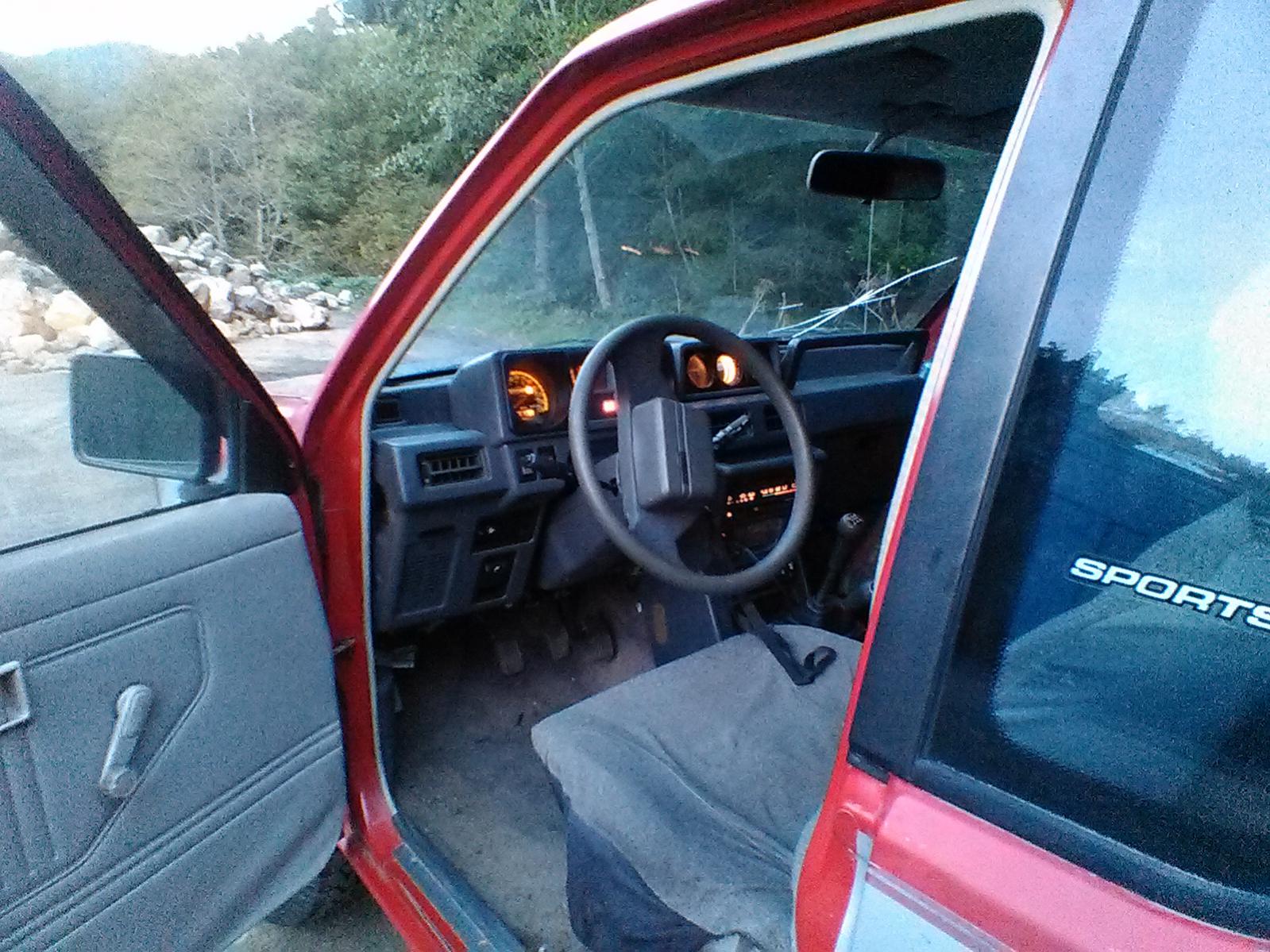

    As for the dash I'm loving it. It's everything that I'd hope it would be .

    Sick build! love that dash swap, looks like a factory job from pics. excited to see the boost!

    If you have concerns about the V5MT1-1 I'd jump right over the -2 and look at the -3. They had trouble with 1 and 2 synchros and were weaker for it. If you already have your -1 I'd look at the fill (or maybe drain?) plug on the trans for a white paint mark. That mark signifies that it was put through the recall and fixed. As for the auto suggestion, that may work for some people but to me, switching to an auto is an unacceptable solution. If you read some of my tomes above you will see how much work I had to do to get rid of mine (which I do believe was the 904). Believe it or not the V6 part of this swap was initially a means to an end of getting a manual in it. The KM145 was said to be weak, so I found the V5MT1 and by extension the 6G72.
    The bottom end of the SOHC is the same as the 2 bolt main DOHC motors, so in theory they should take just as much abuse. The extent of what it means to "take care of" a 6G72 is my question here. Obviously keeping fluids fresh and full is a must for any motor, but would I have to run it like an economy car on top of that? This build is meant to be fun, and if I can't actually have fun with it without it immediately exploding, what is the point?
    As for my block, the crank and rods were inspected and found to be fine, the block had 185k on it and only needed a hone to get back in ideal shape. Everything was put together torqued to spec, well lubed, and with fresh bearings, gaskets, and good clean seals. I drive the truck in a more sporty fashion than most, but I don't abuse it. I may shift at 4k, but I wouldn't redline it, or bangshift, or ever allow it to run with bad or low fluids. Basically I drive it like I drove my non-rebuilt 280k '89 2.0 truck that never failed on me. Both of the trannys were dropped in with fresh fluid but untouched beyond that. The first one went in part because I used GL-5 in it by mistake, but this second trans has the fluid that it is supposed to take. The stock clutch was swapped for a centerforce dual-friction clutch during the tranny swap.

    What year was the -3? Ill check my fill plug to see if the recall was done, if not is the recall still active?
    Not too keen on the lower end of your SOHC but at least the rods, pistons and I think the oil pump are different. Im betting you ran into some oil starvation. This may have been caused by spinning doughnuts in the parking lot and all your oil not reaching the oil pickup. 6g7# motors are very finicy when it comes to getting proper oil pressure and volume. I think even our capacity is more iirc.

    Read on sigma galant, that the bellhousing was the 5spd weak link. So much so that they sold boxes without em ?
    Anyway MOST OF ALL.... Great build & detail!! Thank u
    The -3 SHOULD be the newest one with an actual stick for the transfer-case. As for the year I couldn't tell you, but that should be a start at least. In my research I have found a whopping two threads on that trans, and they detail mostly on fluid setups and synchro issues. There is a service manual available in PDF that will give you a good bit of info on them (excluding their respective torque max's unfortunately). Just google V5MT1 and you should find it in the first page. As for the recall still being active I couldn't say. I'm not an expert in them, but I've picked up a fair bit of info in my searches and personal experiences.

    Checked my trans for the marking. No dice. Still going to stick by the oil starvation for now unless your rebuild wasn't performed properly. Bouncing the motor off the Rev limiter while spinning in a circle would surely airate your oil and leave your crank unprotected. Another thing to check is the condition of your oil pan. For us 3s guys people tend to jack up the car by the oil pan denting it and compressing it against the pickup. This causes oil starvation and spun bearings. Make sure yours looks good.

    Well I've found that the 1-2 shift on the V5MT1s to be the best judge of imminent failure, so if that's good I wouldn't lose any sleep over the recall. Would you mind telling me your tranny's serial number? Of my two, the newer (and currently working) tranny had gone through the recall, while the older one had not.
