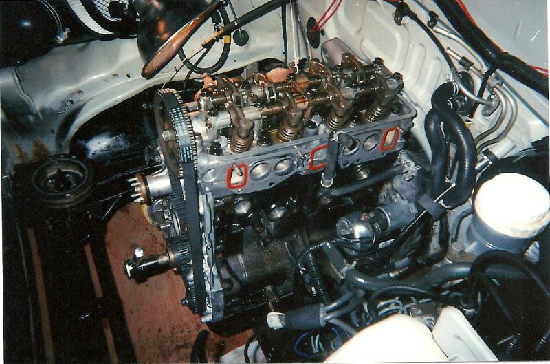

I'm thinking it would be a lot easier to remove the jet valves from the 2.0 head...there are some issues regarding the fuel pump mounting on the 2.4 head, since it is fuel-injected. There is a kit you can buy to eliminate the jet valves. 1949panrider welded his shut http://www.mightyram50.net/vbulletin...ll=1#post27085 without having to remove the head. Doing it that way means a lot of time saved and no gasket kits to buy.
Below is a photo of my 2.4 head. Note there is no port for the 2.0 fuel pump. (center of head).

My 90 model truck had a 2.4 fuel injected engine that the block was no good. My buddy had an 86 with a 2.0 and bad carb. We bolted the 2.4 head with intake and all fuel injection on the 2.0 block. No problem except had to use the 2.0 trans.
Risingphx, whatever you decide to do, I hope you will update this thread with what you encounter. I was told the 2.4 head will bolt on to the 2.0 block and the EFI can be hooked up. I know from first-hand experience the head gaskets are the same.
