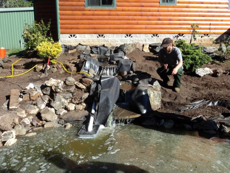

took a break from the motor and truck yesterday. my friend and my sister and i built this nice waterfall to run into my pond. i hope to put some fingerlings of trout in the pond. sure was fun to build and surprisingly easy to build too. now i just have to decorate it with rocks.

Trout will live for a while, but if the water temp gets above ~70 degrees they'll just die, and they require a high level of dissolved oxygen, not sure the waterfall would cut it. Could get some small bluegill or pumpkinseed?
Cool looking falls, though. Be really nice when the landscaping is finished!
my pond is around 2,500 gallons and is almost six feet deep. as far as oxygenating the water, my pump moves 1,200 gallons per hour through a 4 inch line. my neighbor has a much smaller pond with no waterfall and has had trout living in it for years. a few of them are almost a foot long. anyway, the trout are only an idea, something for my daughter to fish for when she gets done with school.

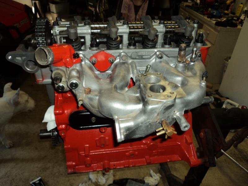

i decided today that a stock camshaft wasn't going to be good enough, so, i got a hold of Oregon Cam Grinders. they have a nice camshaft with a 272/260 profile with .430"/.448" lift and a 1.4:1 rocker ratio. it can be used with hydraulic lifters as well. oh, and it's $99 to grind your core.

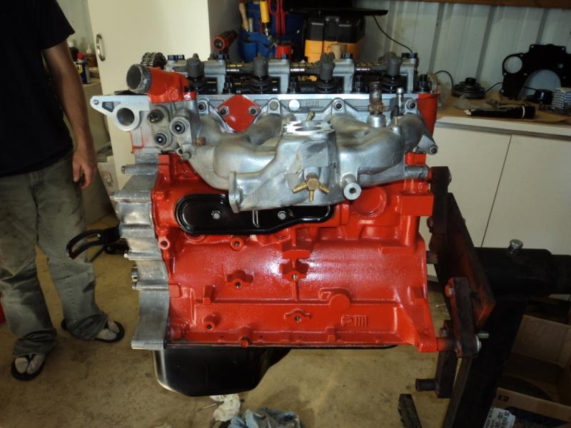

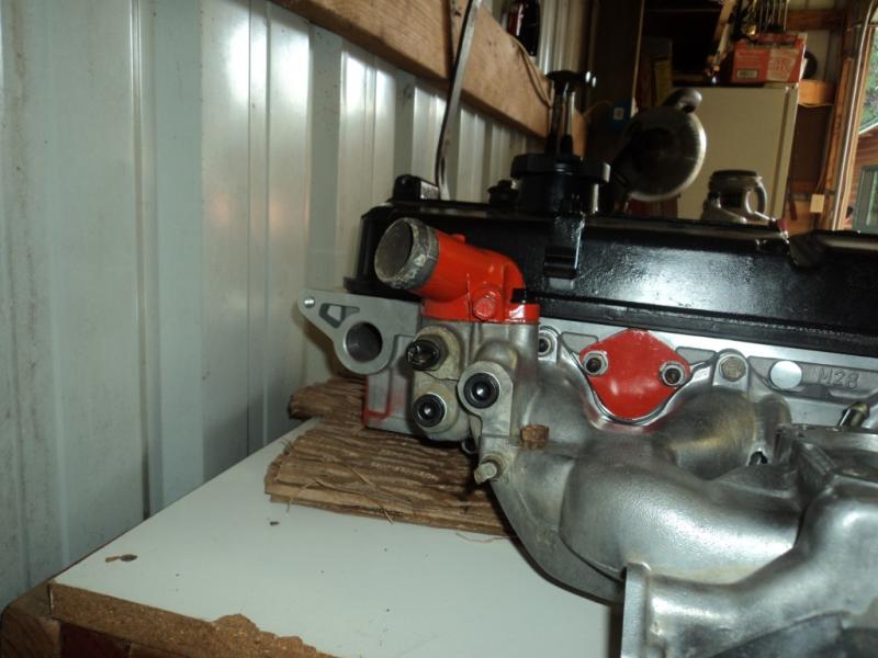

here is the intake secured to the head
Attachment 1287

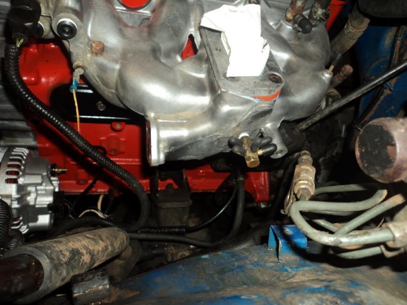

i got rid of the useless vacuum plugs attached to the thermostat housing and plugged them. only the temp gauge is left. since no one makes a block off plate for the machanical fuel pump, i had one made.
Attachment 1289
i have a block off plate being made for this port too.
Attachment 1288

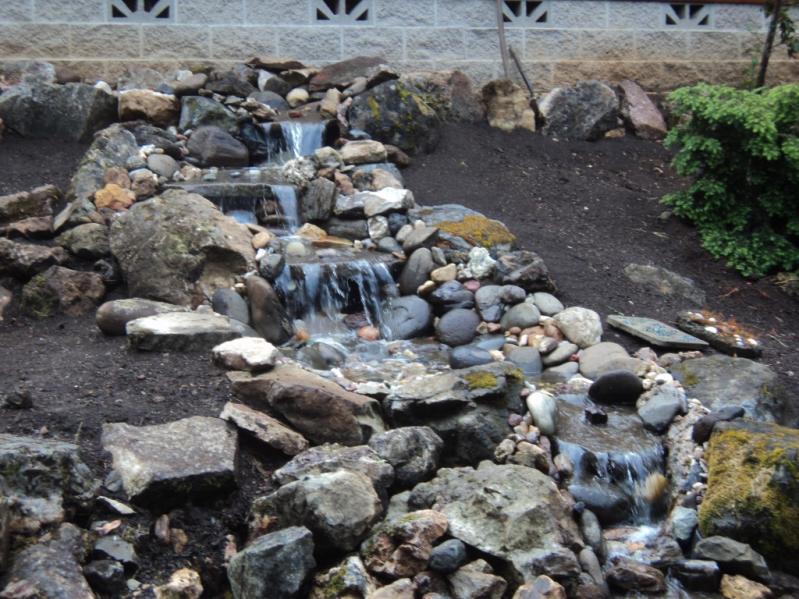

here is my waterfall all done.
Attachment 1293
Congrats, that waterfall looks badass

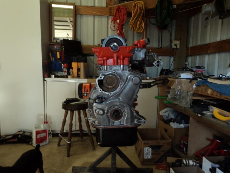

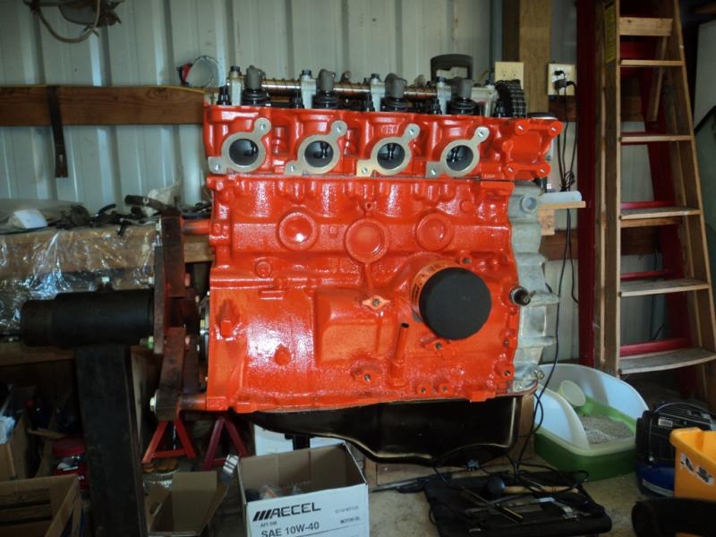

here is the timing chains and gears on and oil pump primed. notice the balance shaft delete
Attachment 1320Attachment 1315Attachment 1314

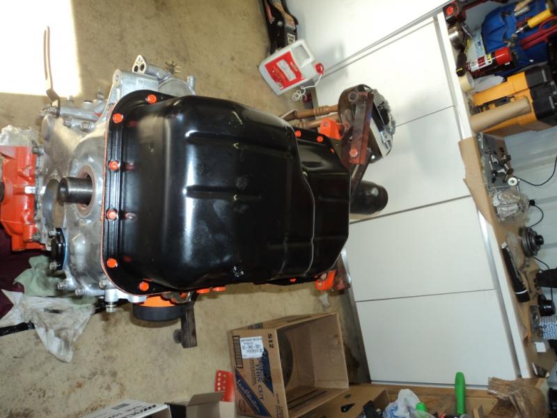

the timing cover and oil pan on
Attachment 1321Attachment 1319Attachment 1318
i painted the oil pan bolts orange. kinda looks cool on the black oil pan
Attachment 1323

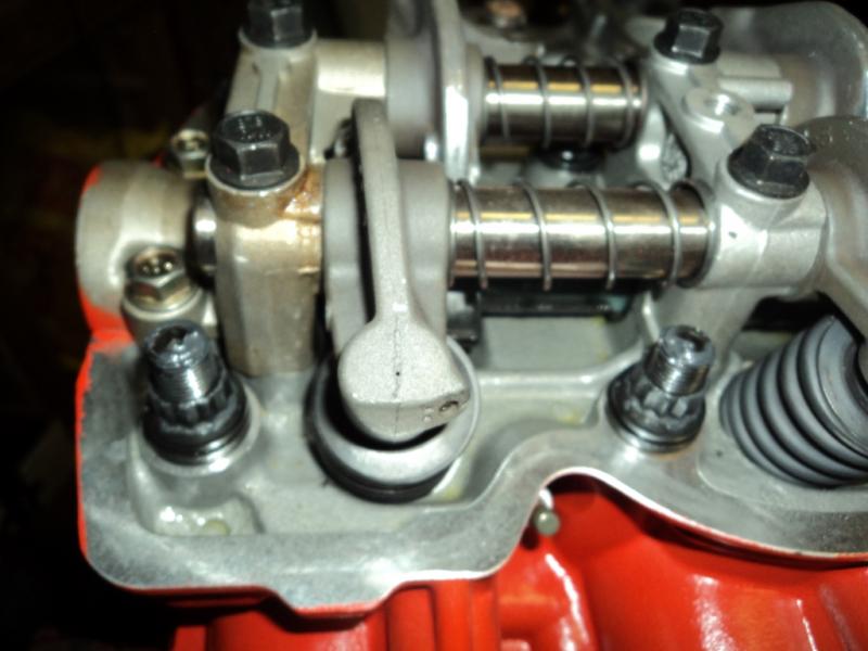

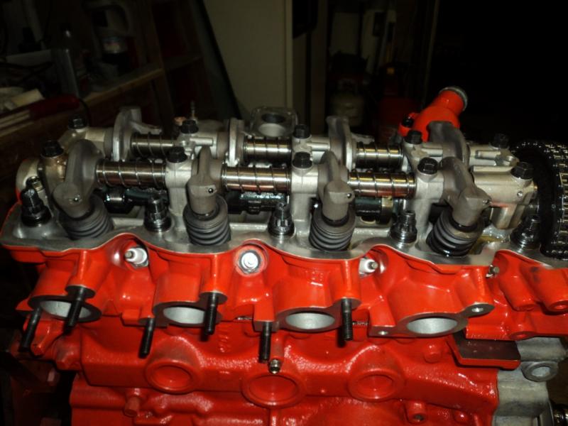

here's the arp head studs
Attachment 1313Attachment 1316

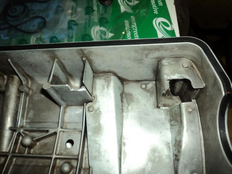

i had to cut the valve cover to have enough room for the head studs. i didn't realize they would be just a smudge too tall
Attachment 1317

Ya the instructions do mention that the valve cover needs trimmed for clearance; the benefits far outweigh the problems of trimming the cover

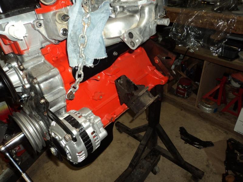

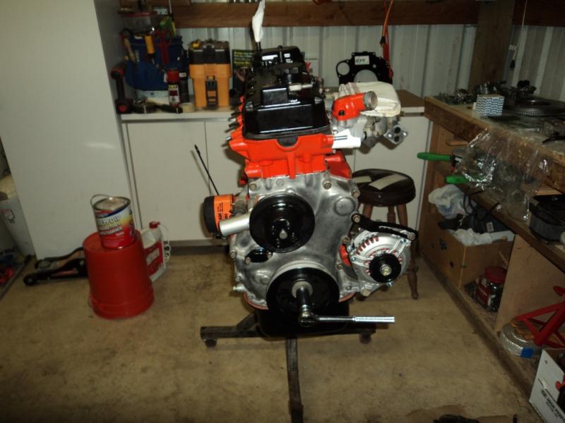

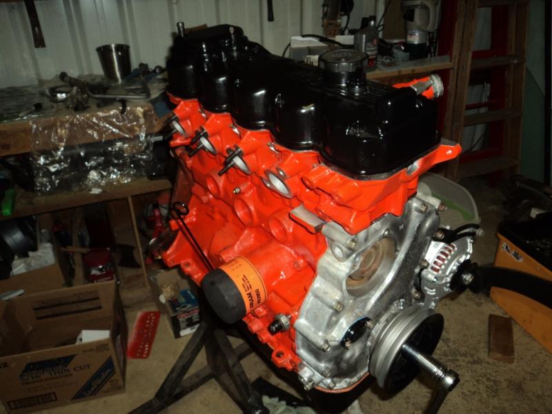

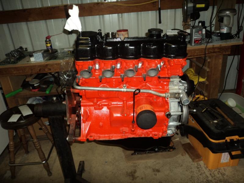

here it is all assembled
Attachment 1327Attachment 1328Attachment 1330

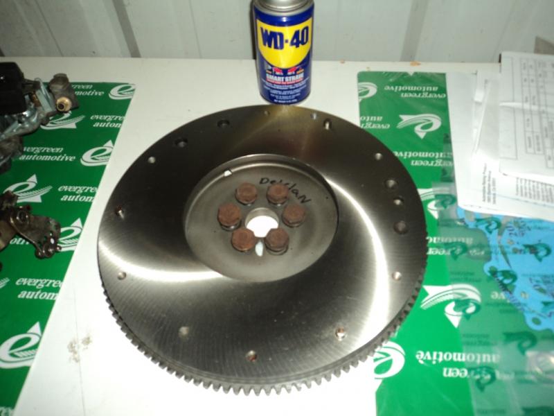

here my lightened and balanced flywheel
Attachment 1326

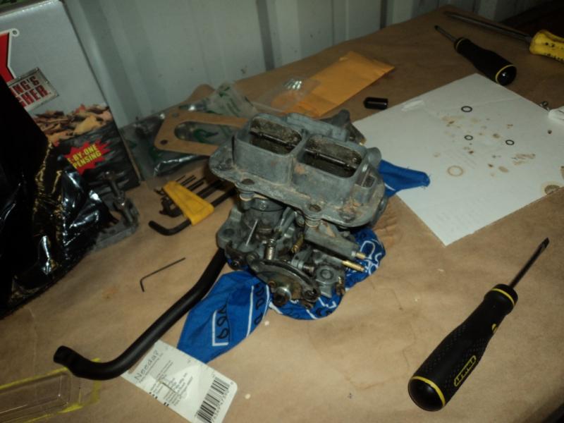

i didn't realize that the weber carb i wanted to use is not a weber at all. i found out that the EPC 32/36 is not a weber but a knock-off of the weber
Attachment 1329

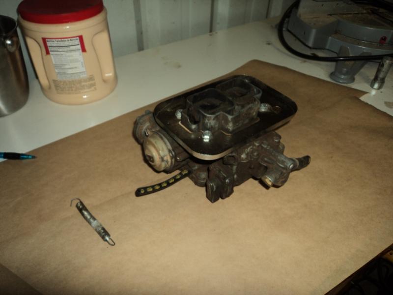

so i had to rummage through my parts shelf and i came up with this actual weber DGAV 32/36
Attachment 1325

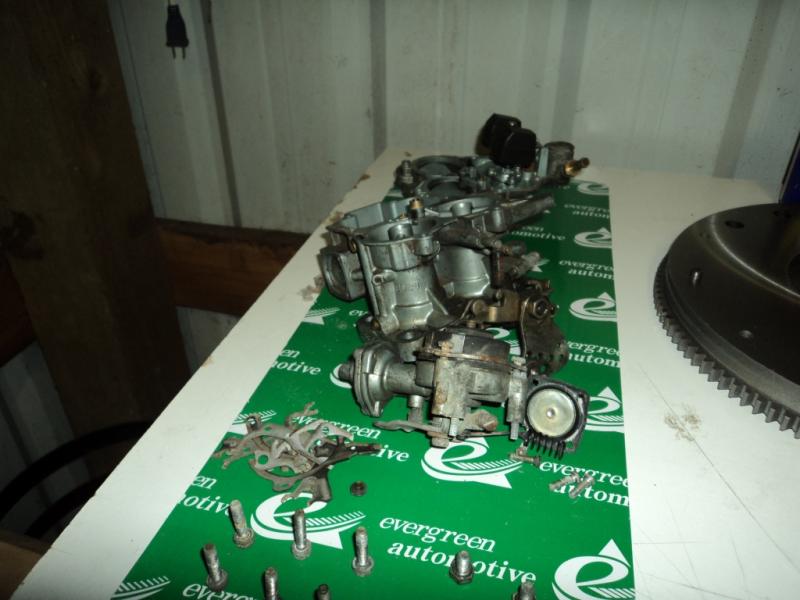

now i have to rebuild this one so i can put it on the motor
rebuild kit for the carb will be here tomorrow. can't wait for that:bang:

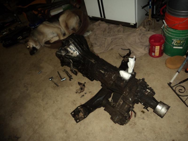

i pick up the engine hoist from the equipment rental place tomorrow:thumbup:. i'm gonna pull the motor that's in the truck, drop the transmission, pressure wash the engine bay, install the new motor, then install the transmission. i got the carb rebuilt and it is ready to go. my edis4 stuff will be here on wednesday as well as my new fuel pump. the megajolt lite jr module should be here by the end of the week. i hope to start the motor next weekend:grin:

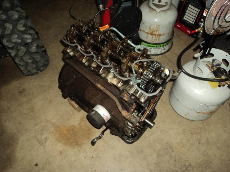

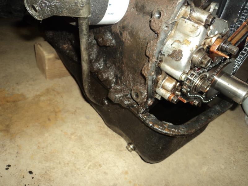

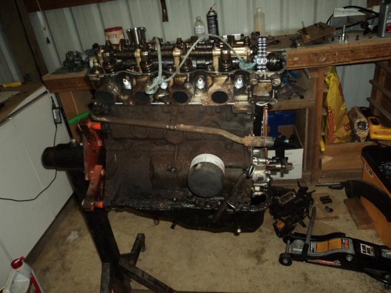

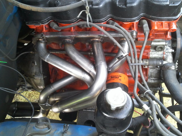

here's the motor out of the blue dodge. i'm not quite sure why the person that owned this truck before me put a dipstick in the oil pan.
Attachment 1375Attachment 1369

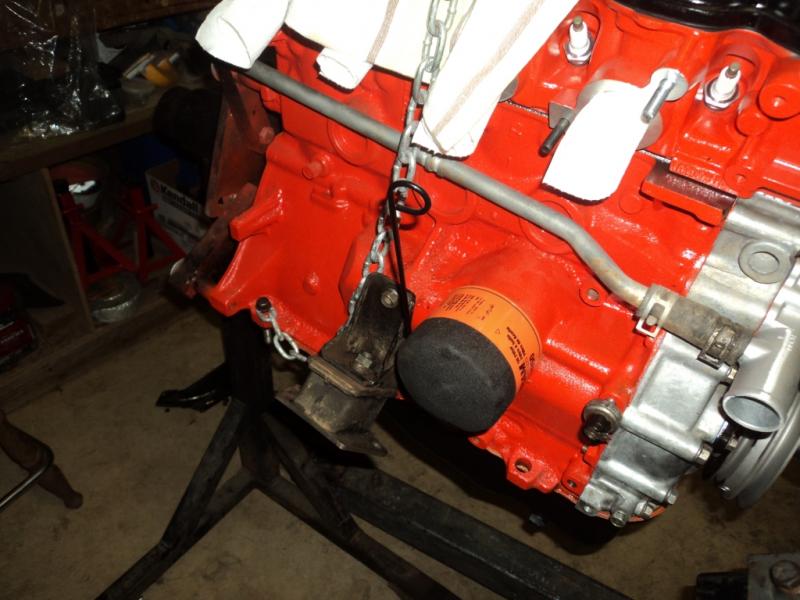

here's the motor mounts on the new engine
Attachment 1373Attachment 1367

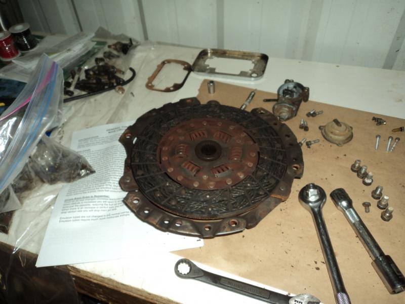

here's the transmission and clutch
Attachment 1371Attachment 1370

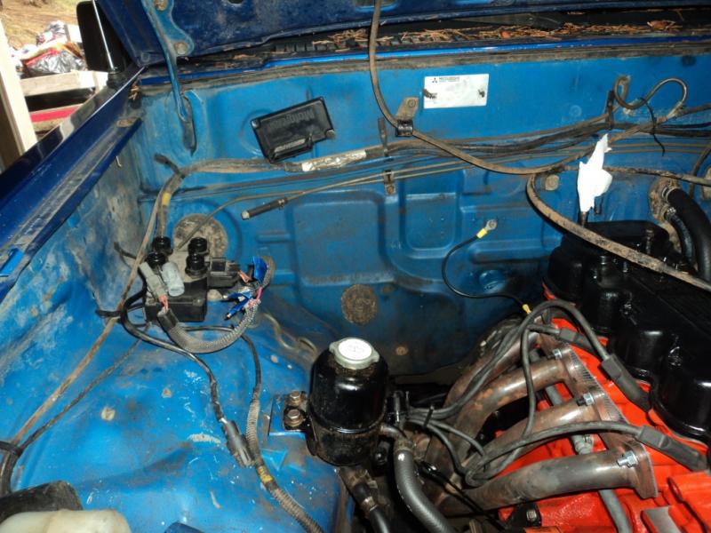

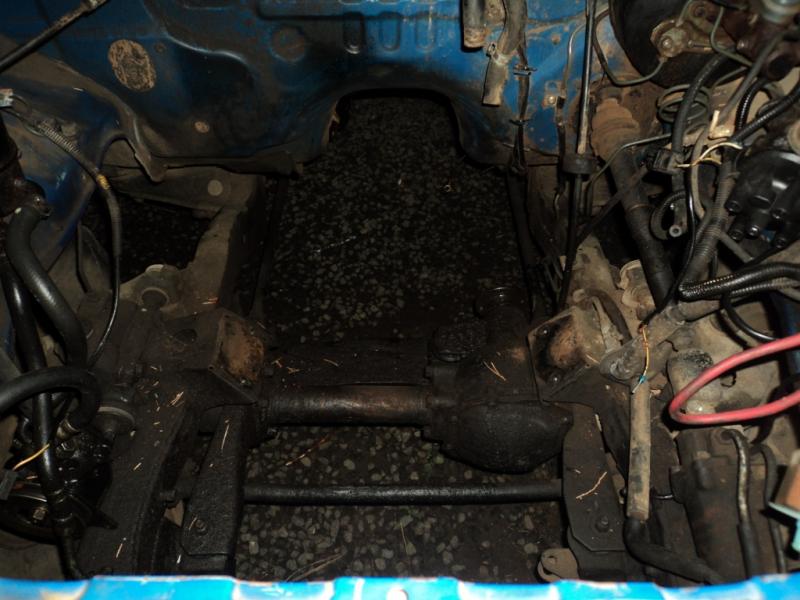

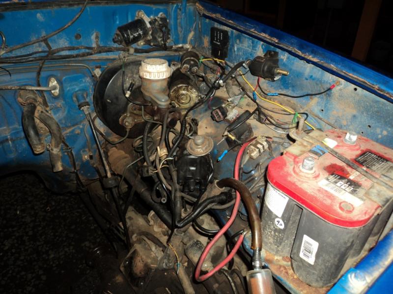

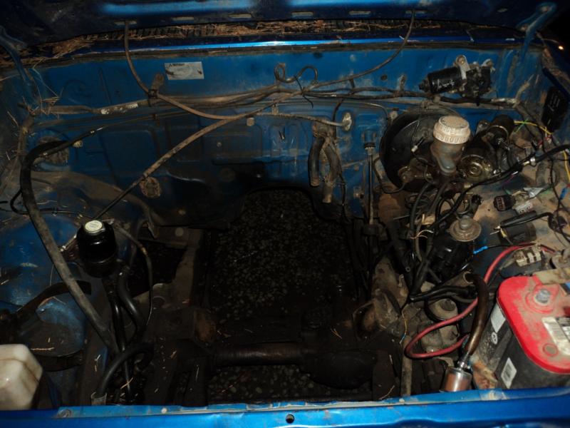

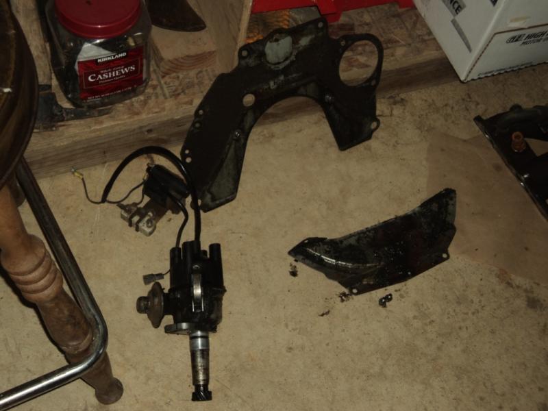

here's the engine bay all dirty. i'll pressure wash it in the morning then the new motor will go in. i still have to eliminate the distributor and coil.
Attachment 1366Attachment 1372Attachment 1368Attachment 1376

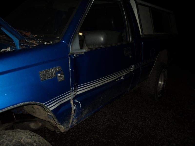

here's the driver door caved in. thankfully i have a spare.
Attachment 1374
How would you wash the engine bay, just soap and water or do you use some kind of cleaning agent?
pressure washer hooked up to hot water.
purple power and a good garden hose nossle also work good if you dont have a pressure washer. truck looks nice though, keep up the good work.
That oil pan looks to be from a starquest 2.6 motor; thats how the dipstick is on them.

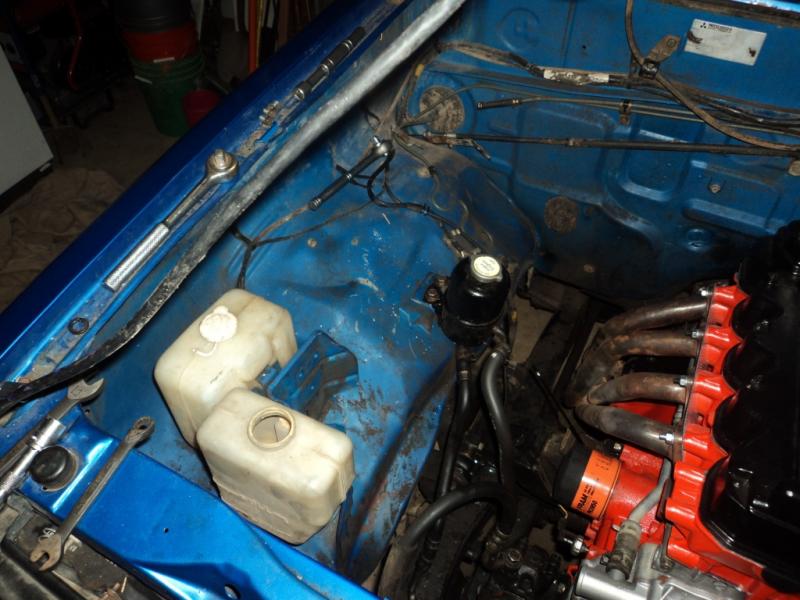

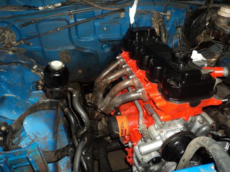

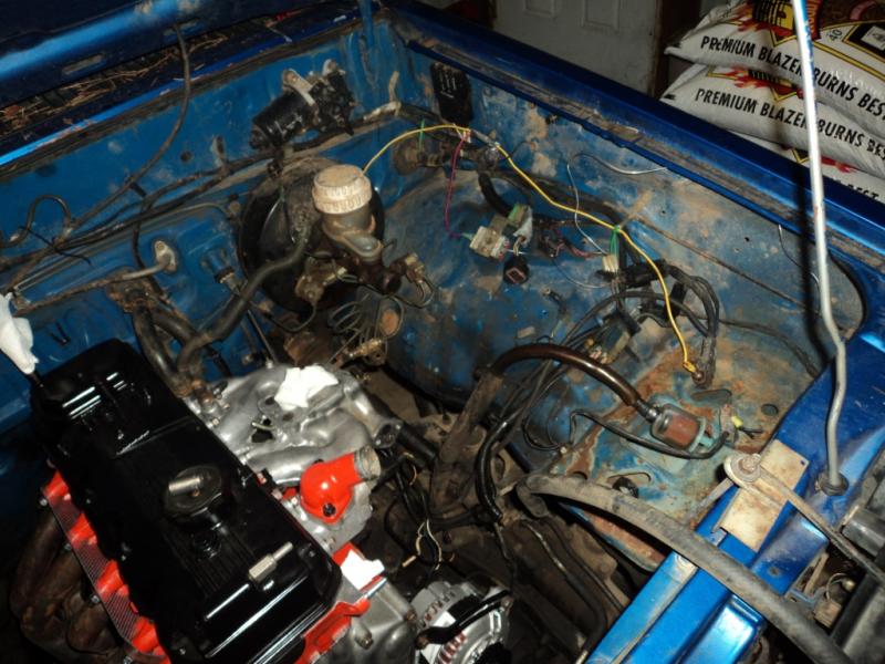

cleaner engine bay
Attachment 1411

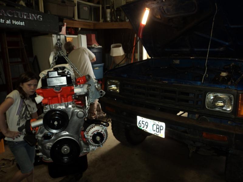

getting ready to go in
Attachment 1414Attachment 1406Attachment 1419

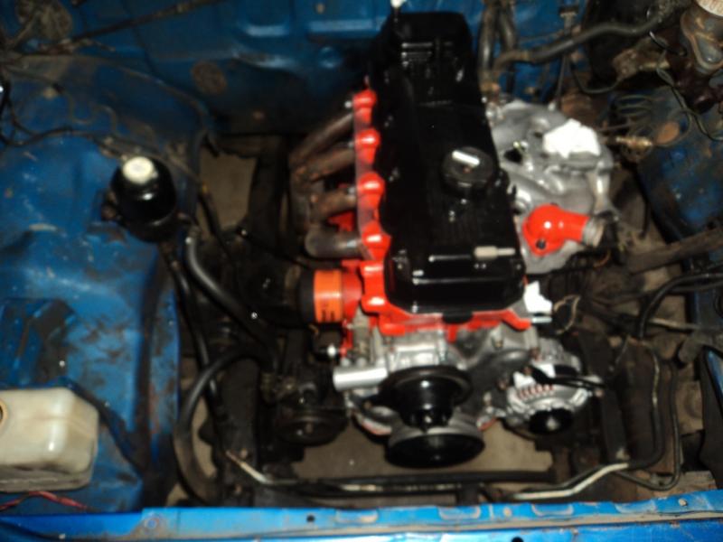

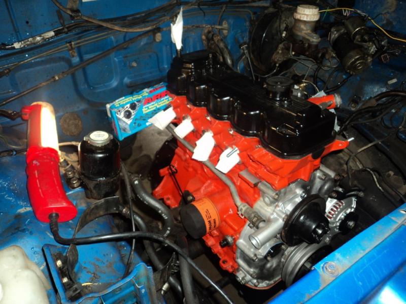

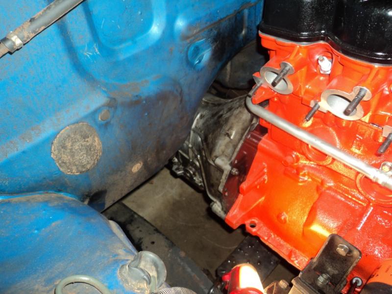

motor and transmission in
Attachment 1399Attachment 1413Attachment 1415Attachment 1417Attachment 1418Attachment 1408Attachment 1400Attachment 1401Attachment 1402Attachment 1403Attachment 1407
the motor is in and the only thing i am waiting for is the fuel pump and the edis 4 stuff.

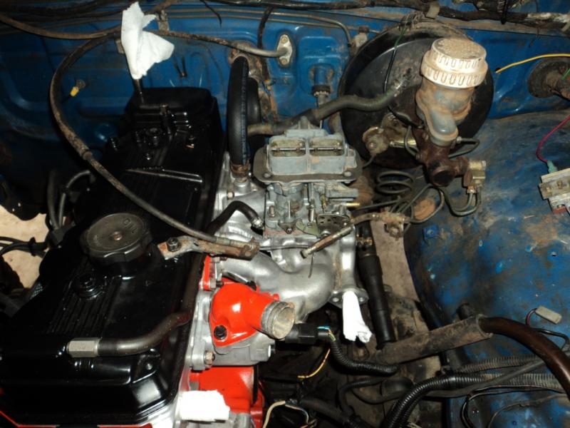

the rebuilt carb
Attachment 1412Attachment 1405

the carb torqued down, linkage hooked up and set
Attachment 1454

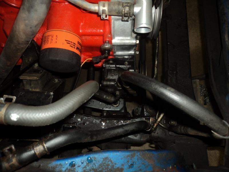

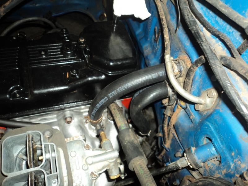

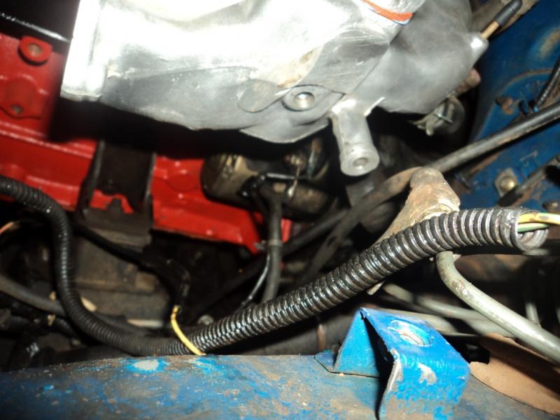

since the truck has a 3 inch lift i had to go custom with the heater core hoses
Attachment 1457

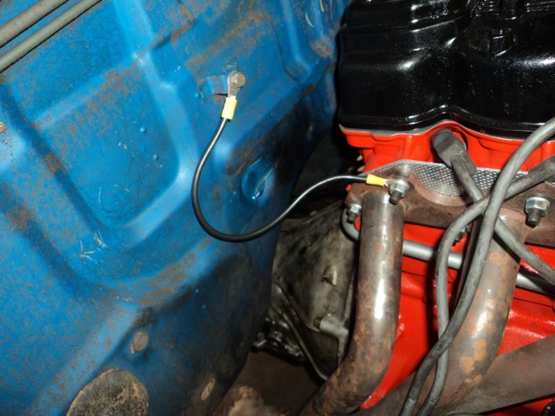

made a new ground wire out of 10 gauge wire to go to the exhaust post. realized afterwards that i may get some smoke from that yellow plastic cover touching the header plate
Attachment 1459

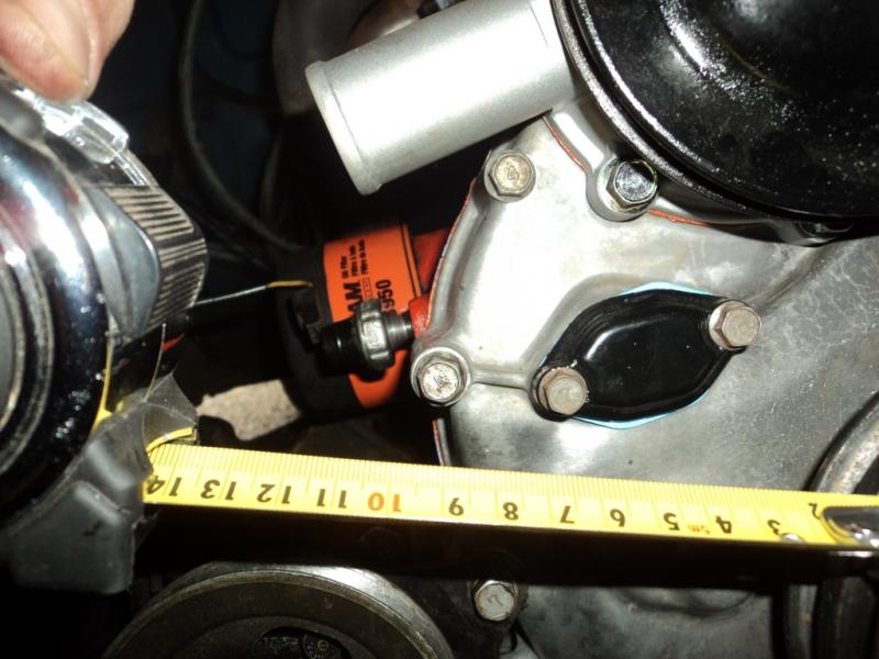

getting some measurements for the bracket for the VR sensor
Attachment 1453Attachment 1456
i'll attach the coils to the fender and the module to the firewall
Attachment 1455
