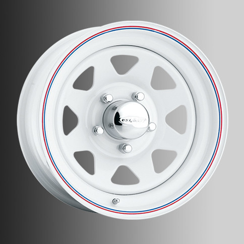

I ended up ordering these white wagon wheels in 14x6 with 3.5" backspacing because I like small, skinny wheels and tires for some reason. There are a few wheels that will fit available on Summit. I happy to learn U.S. Wheels are made in the USA in Southern California.

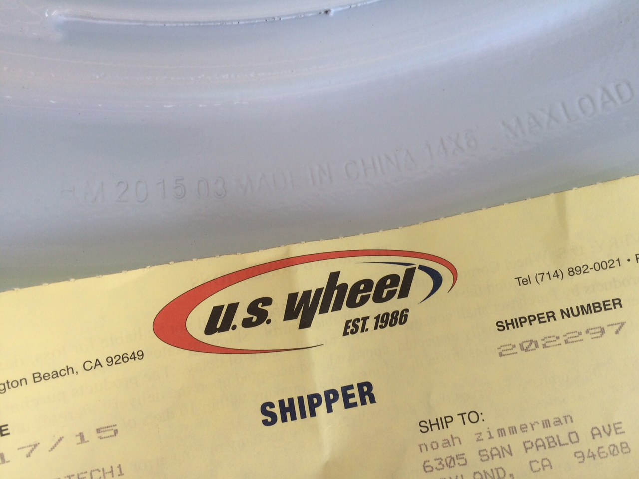

F*** US Wheel.:rapidfire:
Attachment 14590
http://www.uswheel.com/pages/american-made-quality
