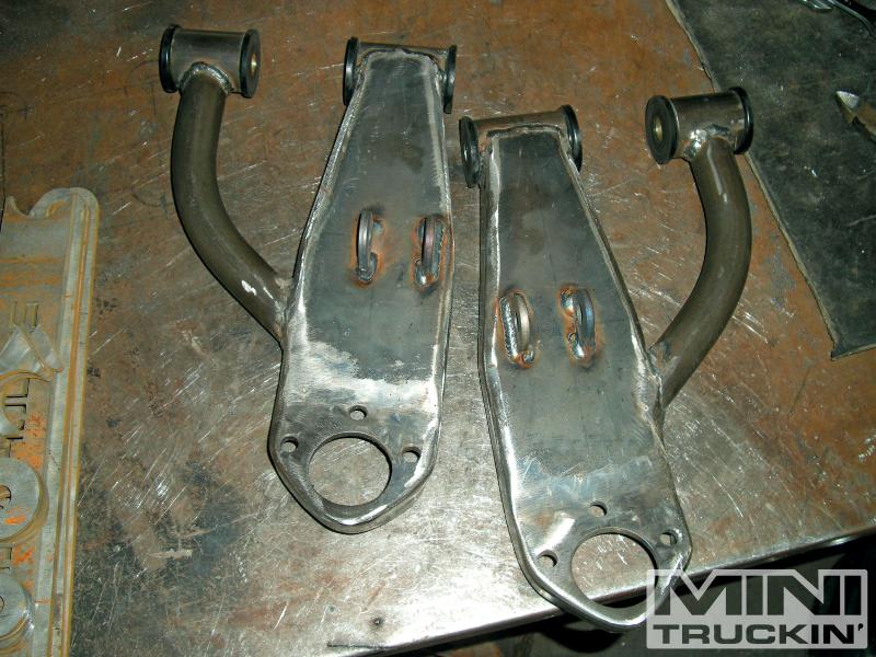

    You can remove them but you need to triangulate the lower arm like this to make it an a-arm.
    The new arm's bolt has to be in line with the original bolt so it doesn't bind.

    Those look so fresh. Where did you get them?
    Those arent mine, but they are just stock nissan lower control arms modified.

    With a set up like the one in the pictures above you need to be real careful when driving. Pot holes and curbs can roll the wheel under the truck it things hit hard enough. Thats why they put the control arm off the front. The further apart the legs of the triangle or A arm, the stronger it is. You always need to think about the forces involved while driving at 60 MPH and stay away from any long leverage points.

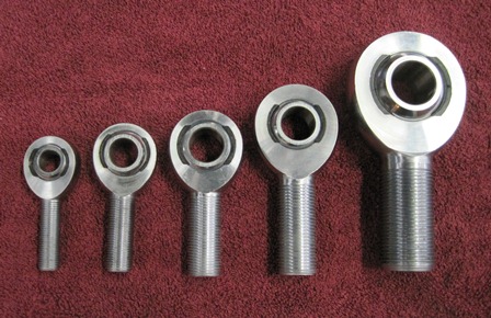

    Rod Ends.
    allLG.jpg http://www.ruffstuffspecialties.com/...g/RODENDS.html
