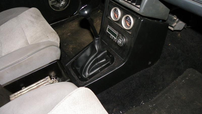

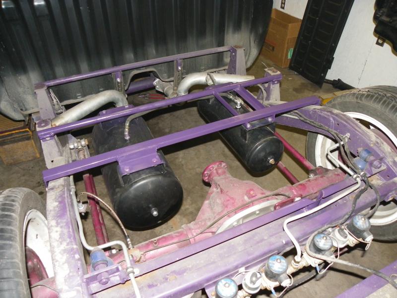

Maybe a LONG weekend....... the first time I built the truck took me about 3 weeks to get everything in and it running. I used the stock drive shaft but had front half shortened and a ford yoke welded on.Used a 82 Crown Vic passengers side exhaust manifold and a 71 Bronco drivers side as they dumped in the right places.Relocated the floor shifter hole for the 83 Mustang shifter and made a rod the correct length, and of course the new tranny x-member.Few other things were adapting the Ford Dura-Spark to the Mit's wiring and using a Mits Alt. with Ford brackets.
you can go with a B&M shifter. MSD 6a ignition box an older style Ford Alt to not have to modify as much as I had to. With the exhaust you can always run the pipes to the passenger side and get a duel in and out 2 chamber muffler placed under the box where the stock pipe runs and everything will be tucked up above the frame.Or run 2.5" primaries to a single 3" pipe and muffler in the same location.Any Headers will have to be modified to clear the steering box.
