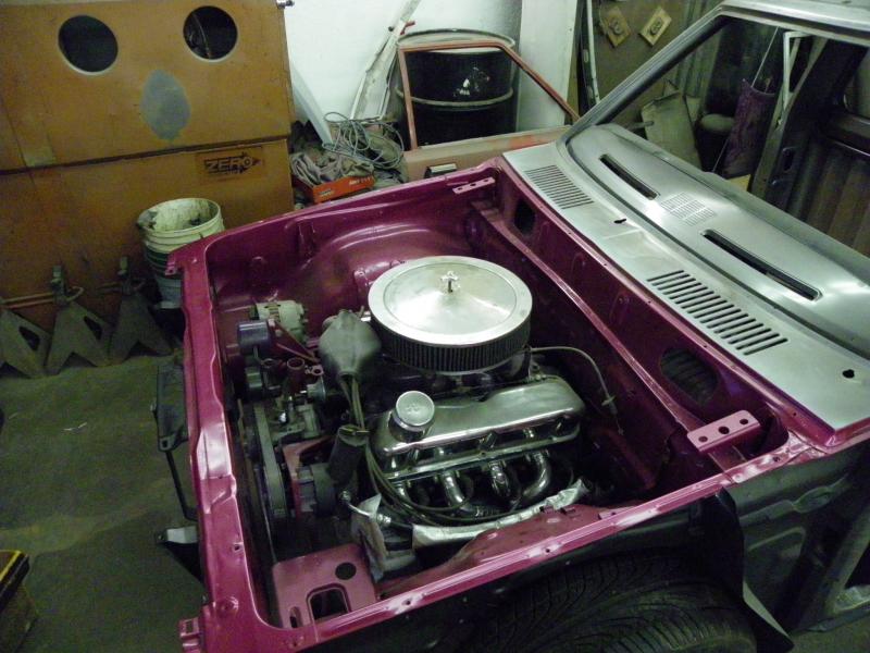

    I picked up this truck 17 years ago for $150 figuring I could rebuild the engine and have a parts truck for my shop.The rebuild was stupid money at the time so as a joke I grabbed an 85 302 out of a T-bird that was totaled. Got the thing on the road and had a blast kicking "ricers" butts with it. Then 11 years ago I was hit by a drunk driver who merged into my lane taking out the passenger front end (I wasn't hurt at all just PISSED)
    A few months later I found a rust free 83 cab and bought it for $39.99 from a local junk yard.Well next thing you know the frame is stripped, air ride put in, 4 link, 7.5" 3.45posi (Ranger axle) gas tank relocated,full mandrel bent 2.5" duel exhaust,AOD with 2400 stall and a stage 2 shift kit,modified BBK Mustang headers, and 5 lug front conversion. there the truck sat for a few years.
    Then I was lucky and found a set of 66 289 4v HO heads and its engine upgrade time.Put in a new cam (Ford A312) windage tray,anti-pump up lifters,roller rockers and a few things to let the engine run to 8000 rpm.Again the truck sat for a few more years
    in the last 6months I have been working on it again and with luck will be on the street again in 3-4 months

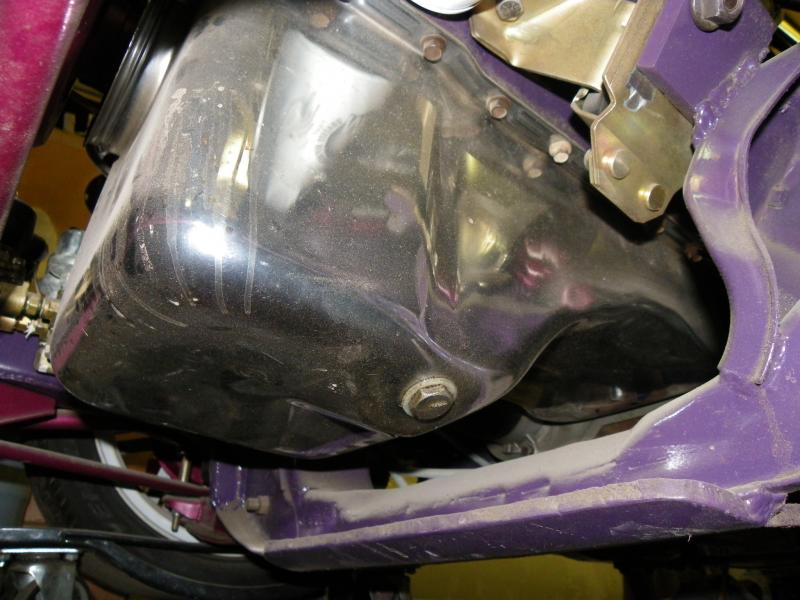

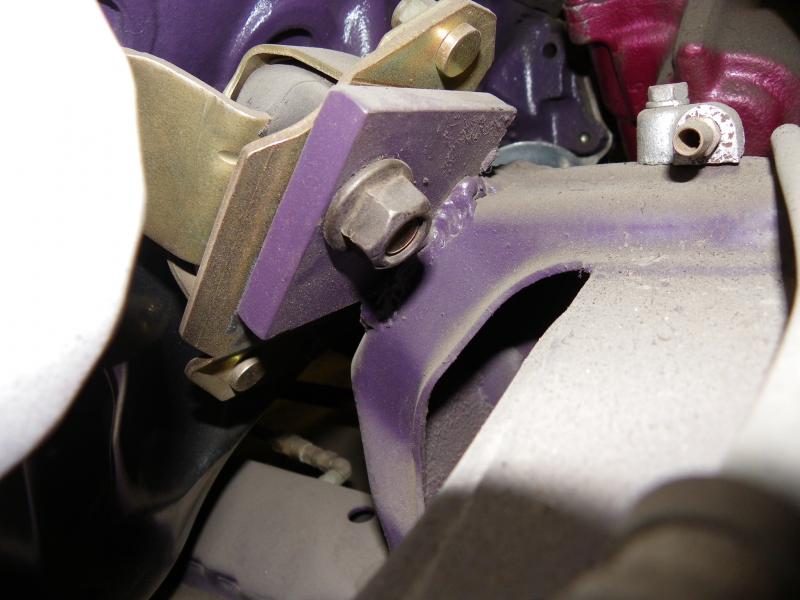

    Nice truck ive got a few questions for you. What motor mounts are you using. Why didnt you use a dual hump pan? Last one with a ranger rear end, which drive shaft are you useing and did you have to mod it any. Thanks
    -Mike
    113
    British Columbia, Canada
    1986 Dodge D-50
    Wow, I think I saved about 15 of those pics for my "awesome mini trucks" folder... The assembled frame with motor reminds me of a hardcore R/C chassis with those bright colours and white wheels. I love it! Very inspirational!
    -RHP
    831
    thanks guys. to answer a few questions here goes.........
    the engine mounts are stock replacement 79-83 Fox body, the frame mounts are made from 3"x1/2" flat bar welder to the factory engine mount location.
    The oil pan is a 60's- late 70's front sump so it clears everything with no mod's needed
    The drive shaft is a 1 piece 2.5" diameter thick wall tube with Mustang U-joints and flanges
    yeah the name was of course a play on words as the whole drive line is Ford and the body being a Mitsubishi we started calling it either the POS or the Fordubishi as a joke and the name stuck.
    if you have any other questions I'll answer what I can

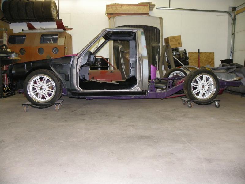

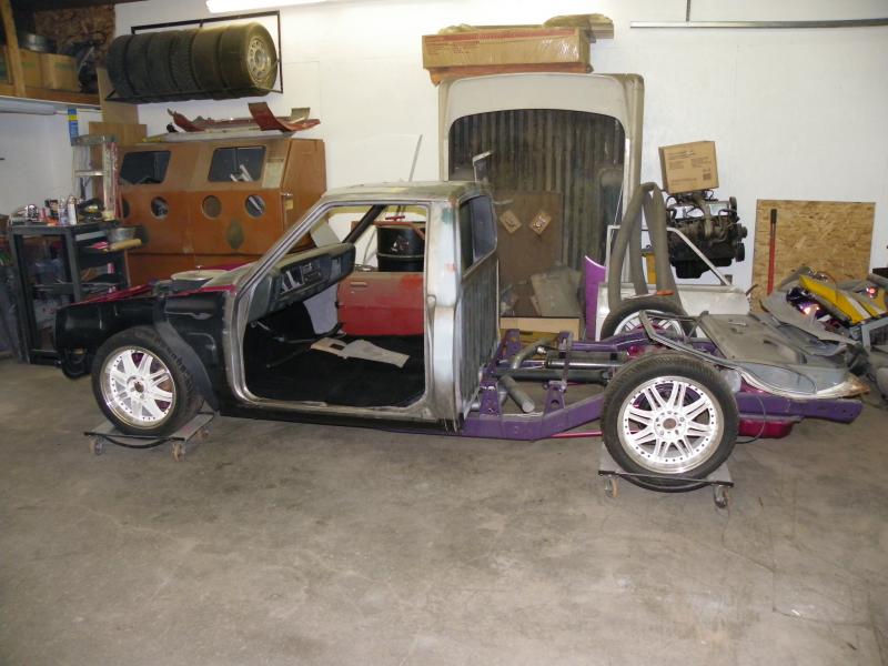

    Couple of pic's of the cab back on the frame after 5 years WOOOOOOTTTTTTTTTT!!!!!!!!!! as of 10 minutes ago

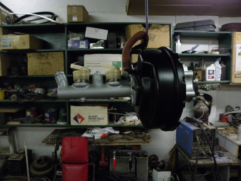

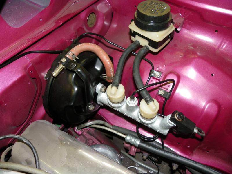

    Stripped and cleaned the master cylinder and brake booster, repainted it and put it all back together. almost looks factory again.
    831

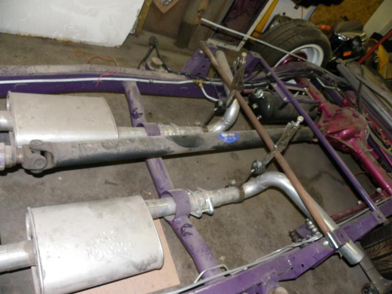

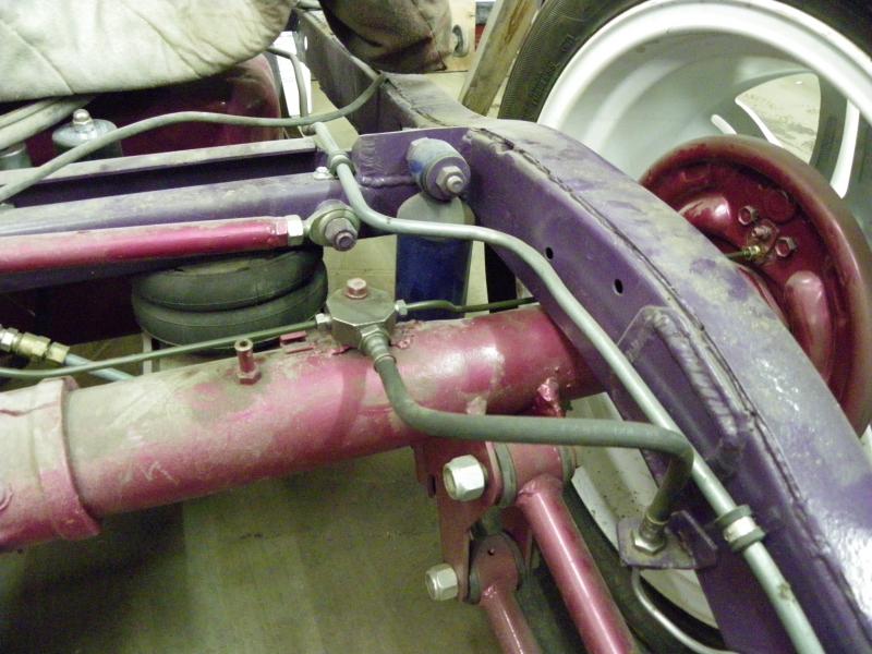

    well got the brake system all in and lines run. here's a few pic's
    all clean and shiny
    rear all plumbed
    259
    Savannah, GA
    looks great! Are you using a pcv valve as a check valve there on the booster?
    831
    that's the stock check valve, just have to do the 11/32" Vac line to the intake.
