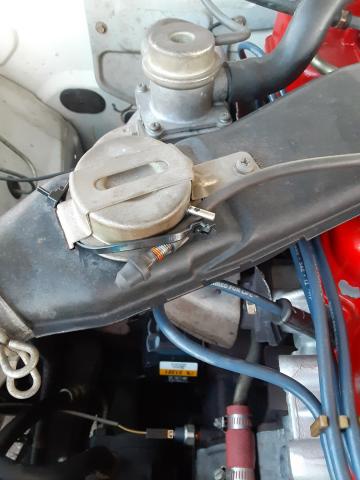

3) Capped off vacuum line to air cleaner snorkel inlet valve (bad bimetallic vacuum valve was preventing outside air getting in...)

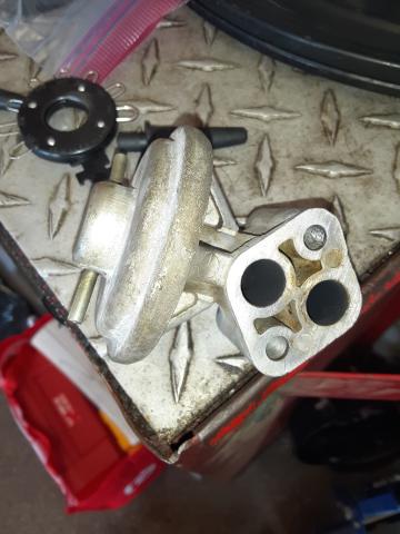

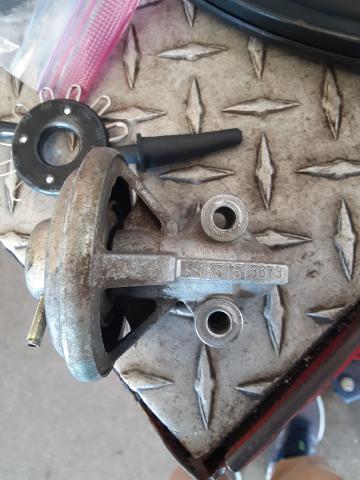

5) Removed tested, cleaned the EGR valve & cleaned the EGR intake passageways...

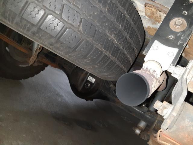

Accelerator pedal is sensitive any wiggle my foot causes truck to surge & buck ~ must rest my foot on the trans hump for smooth throttle response ~ hope the tailpipe color does not turn black ~ truck runs better & more power at WOT...
