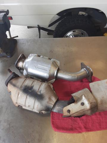

    catalytic converter replacement plan (not a California CARB version) 1986 Power Ram50
    Drivability & History:
    Truck has a worsening trend toward poor gas mileage, intermittent miss, acceleration lag,tendency to run hot up steep grades, lack of power, rough idle AND has had adjustments for ignition timing, RPM setting and new parts for Mikuni carburetor, distributor ignition module, spark plugs, plug wires, coil, PCV valve, both engine coolant sensors, O2 sensor, oil pressure sensor, new muffler, new cylinder head, air, oil, crankcase filters new, etc... Hawaii roads are mostly 25MPH stop & go driving which leads to a plugged catalytic converter... There are freeways on Oahu where the truck can be driven long enough & fast enough to heat up the catalytic converter to burn off the crud that collects inside a converter...
    Reference:
    https://mechanicbase.com/engine/bad-...rter-symptoms/
    Photo of exhaust manifold catalytic converter canister taken when replacing O2 sensor:
    PARTS:
    Exhaust Manifold to Catalytic converter inlet Gasket MB687020
    Catalytic converter outlet to exhaust piping Gasket ???
    Catalytic converter as shown in photos below (OEM Catalytic converters are obsolete & not available)
    WORK STEPS:
    1) Accumulate parts
    2) Remove piped catalytic converter
    3) Clean out old catalytic converter canister & remnant from inside the exhaust manifold (truck will use only one catalytic converter)
    4) If needed target old catalytic converter on workbench & reuse it's piping ends onto new converter if new converter is not an exact fit...
    5) Test drive with X'd fingers...
    comments, suggestions, bashes..? cheaper ways of DIY..?

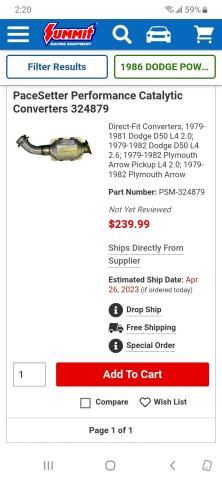

    Pacesetter direct fit FED cat listed as no longer available at Summit Racing and other sites as well; will phone PaceSetter Co.

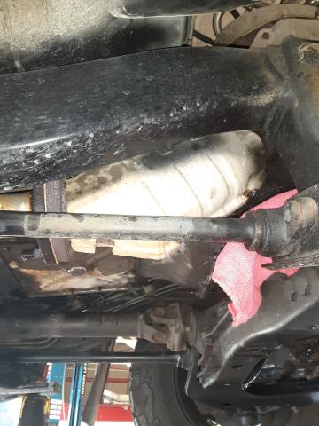

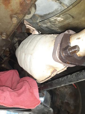

    Was able to reach & loosen the 4 rear cat bolts in a dry run for removing the cats this week ~ I think the front cat container is bolted to the exhaust manifold; if so, plan is to remove it due to it being plugged ~ once it's removed reassemble & test the rear cat & exhaust system for back pressure ~ a failed back pressure test will require replacing the rear cat...

    Inspected the exhaust system again and decided to purchase the rear cat as a result of seeing how bad the front cat is plugged (the truck was burning coolant with cracks in the cylinder head for a couple months before A miss & bog got really bad...) Removed the exhaust manifold heat shield to expose the five bolts holding the front catalytic canister case onto the manifold ~ it might be possible to remove both cats out the bottom w/o having to remove the exhaust manifold (?)

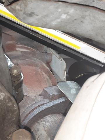

    Not sure if the upper cat can be removed from below. Take off the two lower heat shields first then give it a try. If you do have to remove the manifold, you can re-use the head-to-manifold gasket.

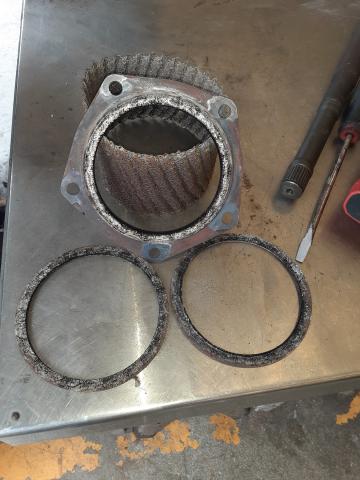

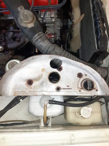

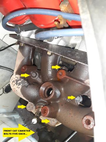

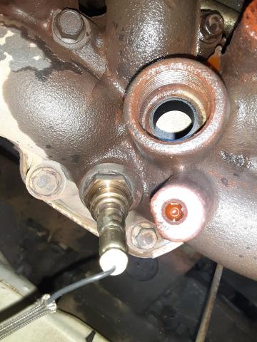

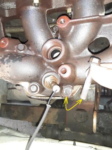

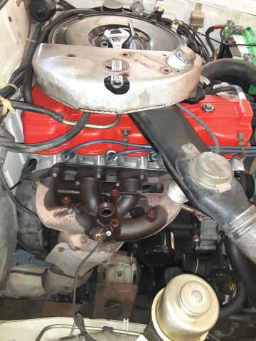

    (The FRONT & REAR catalytic converter assy came out from the top; the exhaust manifold did not need to be removed...)

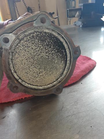

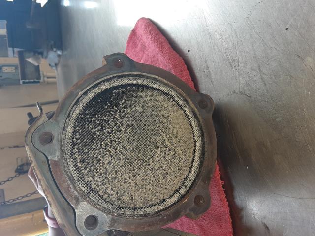

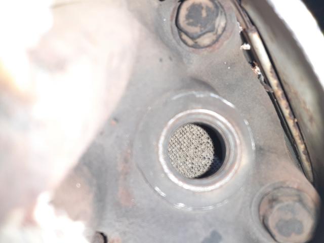

    Removed FRONT catalytic canister which was melted & plugged inside the exhaust manifold attachment ~ the REAR cat was OK & reused it ~ also discovered a vacuum hose split and not attached to it's barb under the carburetor ~ the truck now runs normal; no miss, no bog..! Photos 'n more details soon
    Thanks to those who gave me helpful advice ;^)

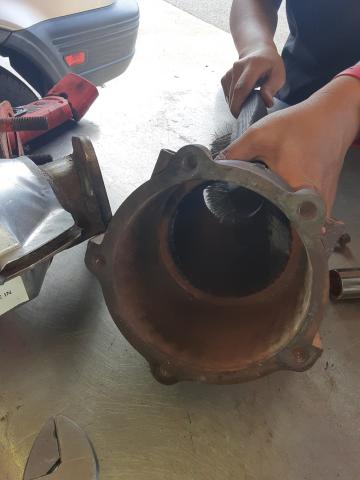

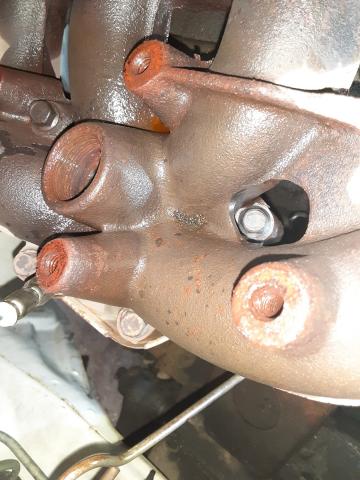

    We used an air driven impact gun on low setting with 12mm socket to break loose the five front cat case to exhaust manifold bolts...

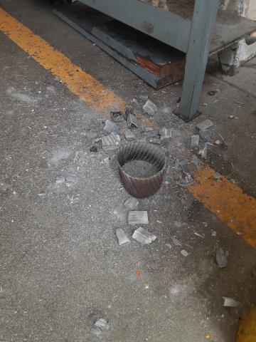

    Wife helped a lot ~ she used a long blunt nose chisel & small hammer to knock out the melted honeycomb material & she crawled under the truck to hold the rear cat while I bolted the front cat casting onto the exhaust manifold ~ she really was helpful..!
    FMS88 your advice to do this before purchasing the rear cat was spot on (our existing rear cat was alright) & would have saved us $350.00 BUT we will keep the Pacesetter cat as we plan to keep the truck ~ we would have used the new rear Pacesetter cat except it required drilling larger holes to slip onto the spring bolt shafts & it does not come with the bracket to mount the original heat shield metal ~ also, the "V" shaped gaskets they provided were too small I.D. to fit over the pipe end of their cat ~ so, we had to reuse the original formed "V" shaped gasket... and, their cat inlet pipe is a little smaller I.D. than our existing cat (see photo) who knows if it might increase or decrease power... Hope photos answers your ??

    Thanks for your post and pictures. Now I know how the honeycomb was fixed inside the cast iron casing. The surrounding mesh makes sense plus I bet it made removing the honeycomb easier.
    Too bad you couldn't use the new cat, but then by not needing it, you saved a lot of time and effort to make it fit correctly. Nice work on your part and your wife's!
    1,572
    Thanks for all the Kudos :^)
    IMHO that mesh was the only way any exhaust gas was able to pass through the system ~ the photos don't really show that the entire honeycomb was plugged or melted...
    In a 1/2 mile distance WOT test drive to a fwy exit the "before" speed reached was 55MPH and the "after" speed reached was 75+MPH ~ altogether, no real butt-oh-meter increase in horsepower but just a smooth running keep up with traffic daily driver...
