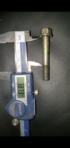

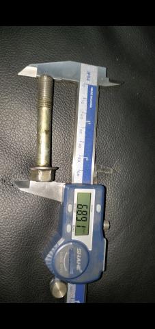

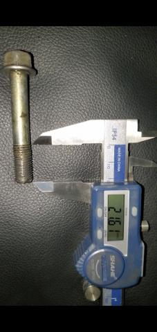

Attachment 27038
Attachment 27039
Attachment 27040
I hope that's what you were looking for. Any questions, ask away. 14mm bolt head btw.
Think it's an M10 60mm long bolt with a 1.25mm pitch thread. Need someone to verify as the other option is 1.5mm pitch thread... (readily available online and cheap)
