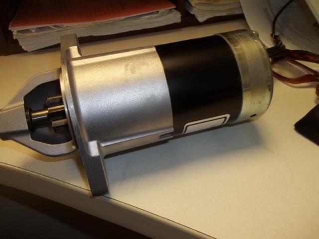

    BACKGROUND ~ I am comfortable bidding on vehicles & parts both online & at live auctions, been there & done it... I just bought a starter motor for my truck at this auction: https://gsaauctions.gov/gsaauctions/...31QSCI21145012 and I don't even know for sure if it will fit ~ heck, I don't even know if I will ever need another starter ~ but, this auction part is a better starter than the original Direct Drive starter, this one is a PMGR (permanent magnet gear reduction) type starter motor
    AUCTION STARTER PHOTOS

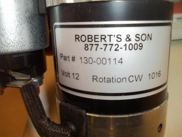

    WEB PAGE FOR THE AUCTION STARTER ~ https://www.robertsandson.com/rs-130-00114.html
    I spoke with the Robertson & Son phone rep and he said this starter is not made by Mitsubishi but to replace parts on Mitsubishi equipped vehicles forklifts and the like ~ he didn't even know who made it or where it's made ~ think Made-in-China Korea Mexico anywhere but USA (?)

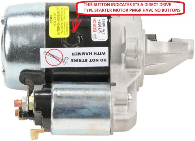

    DD STARTER MOTOR IDENTIFICATION PHOTO (typical DD direct drive type on our trucks & less powerful than a PMGR motor) yet physically larger & heavier.
    WEB PAGE FOR HELP INFO ~ https://www.808starters.net/home.html
    I spoke with phone rep Kale he said you can go up 2 teeth on the starter pinion gear when going from DD to PMGR motors ~ he also told me how to identify a direct drive motor by it's it's field winding buttons ~ my truck has the DD starter motor ~ I might try installing the PMGR motor when it arrives or whenever...

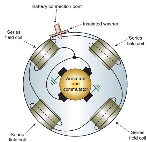

    DD MOTOR WITH FIELD WINDINGS (telltale buttons)

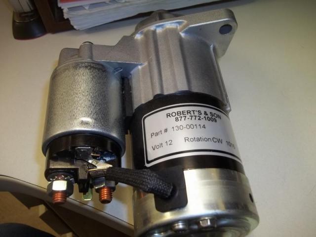

    Got Mail today ~ the GSA Auctions Starter Motor arrived today ~ looks new & unused (+) has Mitsubishi symbols (+ or -) could be China knock off ~ the CW 8 teeth pinion same as oem part (+) don't know if it will fit though (-) experiment project winning bid $35.00 shipping $70.00 ~ weighs about 7lbs looks smaller than whats on the truck ~ gotta comparison measure next (doubt any oem starters on the island NAPA no O'Reilly's no) will need to glean dimensions from the internet BUT I have learned & notice that specification data for the same part is often different depending on the store webpage

    Oh Oh ?? The two mounting holes are not threaded on this forklift starter need check my truck asap

    Thanks for posting fighter ~ I did not look at my truck's starter today BUT this new farm equipment/forklift/implement PMGR starter has no threads in the two mounting holes & I'm thinking threads are needed ~ gotta peek at the situation soon BUT today I was occupied getting the #2 Moderna covid vaccination @ the VA Hospital in Honolulu ~ Left arm getting sore tonight just like the Right arm did on #1 jab & overall day 2 and 3 have a feeling of fatigue 'n a little feeling of soreness all over ~ no biggie yet ~ funny musta hit a nerve on the Right arm coz the injection hurt 'n burned going in BUT today the nurse jabbed & I did not feel a damn thing..! She said they use 25 gauge size needles which are the most common size for vaccinations ~ heck I know more about shots than starters (not really)

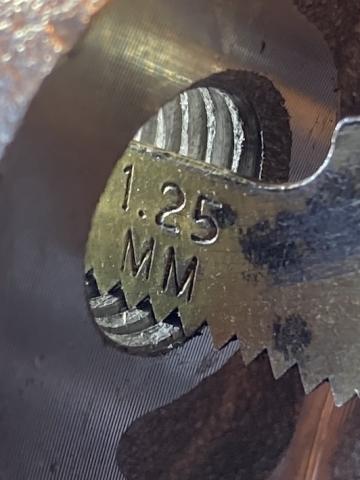

    Scoped out the existing starter on the truck today & it does have internal threads in the two mounting flanges ~ the tractor/forklift starter flanges are similar in thickness & drilled so they can be threaded too ~ no OEM starter on the island to compare on a workbench, might have to remove the existing starter to see if all else is samo samo besides the thread issue ~ ugh..! finalfighter do you have a stock starter with the threaded flanges & if so, maybe you'd be willing 'n able to do some measuring on it for me..? Check out the 2020 Ford Ranger truck compared to a gen1 Mitsubishi 4X4

    I think there might be enuff thread length sticking out on the mounting bolt that a thread pitch gauge might be capable of measuring those threads ~ I can check if Hardware Hawaii has a gauge, they are just across the street from me ~ trouble is can't get an eyeball very close to the starter while under the hood

    M8 X1.25
    Builder compared drive, mount holes , nose cone depth, solenoid connections, all the same !!

    Final Test Results: UNSATISFACTORY
    Yesterday my truck would not start & today I was lucky enough to get a local mechanic (Vernon) to fix the broken starter; problem was just loose wiring connections..! He tested the starter while it was out of the truck and it spun up strongly... Even so, I asked him to do his best to install the new starter I bought at an online govt auction...
    The auction starter was intended for farm equipment and fork lifts with Mitsubishi engines... He threaded the starter case holes to 10 x 1.25mm to match the existing bolts & even used a grinder to remove metal on it trying to make it fit... Best he could do was get only one of the original mounting bolts to line up... He said it would be necessary to remove a good amount of metal from the pointy end of the cast metal cover which holds the pinion gear shaft end bushing... Forget That...

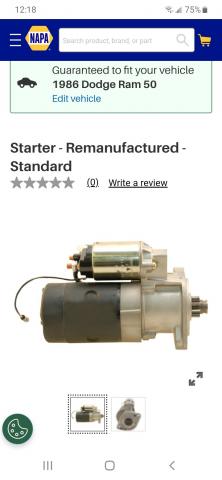

    So I phoned NAPA O'REILLY's AUTOZONE asked them if there was any difference between automatic transmission & manual transmission starters for my truck and they said no even though two types of starters are shown on Autozone & O'Reilly's web pages NAPA only shows one starter exactly like the one that was in my truck... They do require knowing engine size mine 2.6L (not sure what the starter might look like in a 2.0L engine) The starter like mine only fits 1985 & 1986 trucks... NOTE that the correct starter like mine has a white electrical wire coming out of the starter casing (not sure what this extra wire does but it connects to the truck wiring harness and it's clearly seen in the photo below)... The Autozone rep said the cone end shaped starter photo was a STOCK photo and not a photo of the actual part...
    Anyway long story short is the NAPA starter should fit it's the only one they list that fits a 1985 & 1986 2.6L engine irregardless of transmission type or 4WD & RWD ; while O'Reilly's & Autozone show two types of starters you better know whats in your truck before ordering a starter from any of them...
    MORE INFO: After reviewing RockAuto starter info it seems the transmission type does make a difference ~ the automatic transmission starter has the closed nose cone shape end 8 tooth pinion gear & the manual transmission starter is open face 9 teeth pinion and the extra white wire from the solenoid... Many of the manf have their starters listed as fitting the wrong transmission... Vernon tried to get the automatic transmission starter to fit my manual transmission truck without success... MitsubishiPartsCentral shows only the automatic transmission starter part# M085731D and I cannot find a Mitsubishi part# for the 1985/1986 manual transmission trucks...
