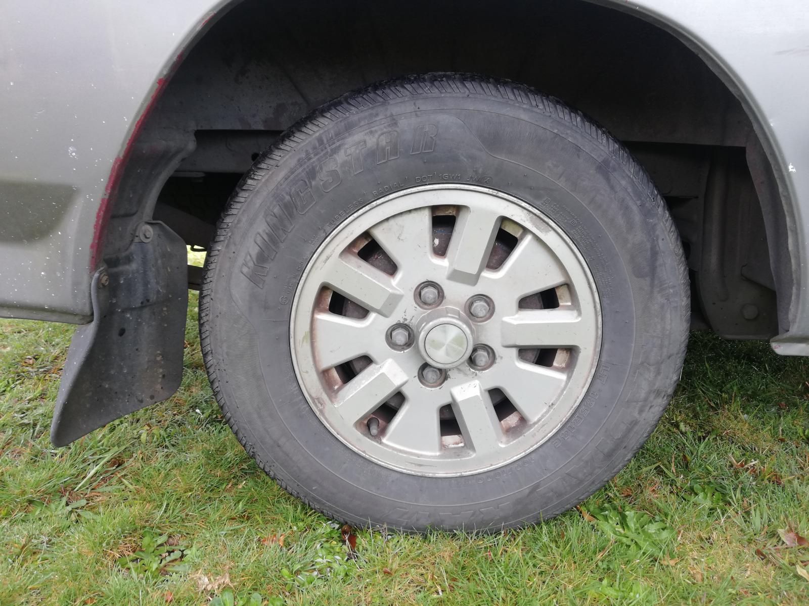

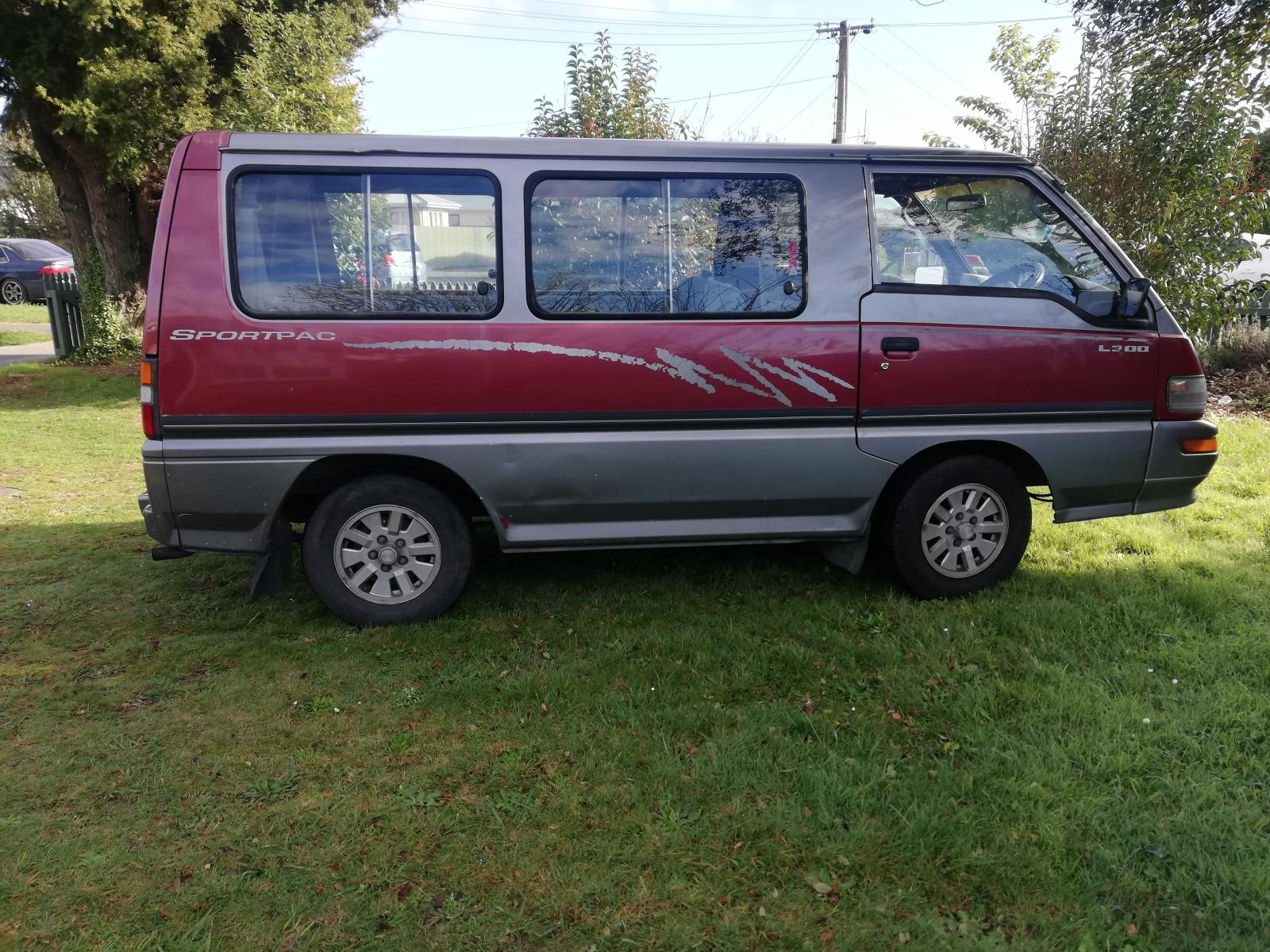

This is my neighbors L300 van
Attachment 23384
Attachment 23385
It's a diesel 2wd. Can measure it if you like. I believe they were popular in Thailand so you should be able to eBay parts
