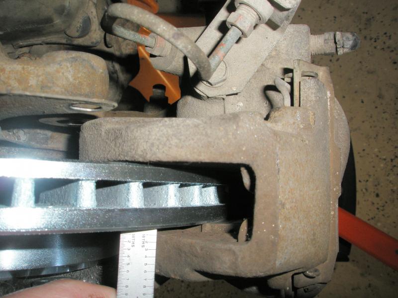

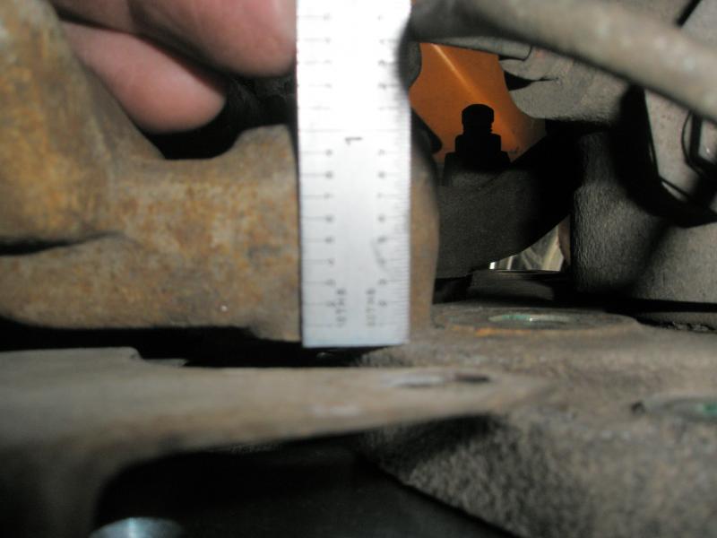

    Might as well get Toyota front hubs anyways. You can get the hubs from a junkyard for much cheaper then getting the Mitsu hub redrilled, and the wheel bearings are the exact same size(ID) as the mitsu spindle is so everything bolts right up.

    I'm guessing this is just the old Toyota HiLux type pickup?
    Yes, I believe the years are 89-95. And I used 95.5-01? Tacoma rotors. Shimmed the caliper with like a 1/16" washer or somewhere around there, you'll be able to figure the exact amount pretty easily.
