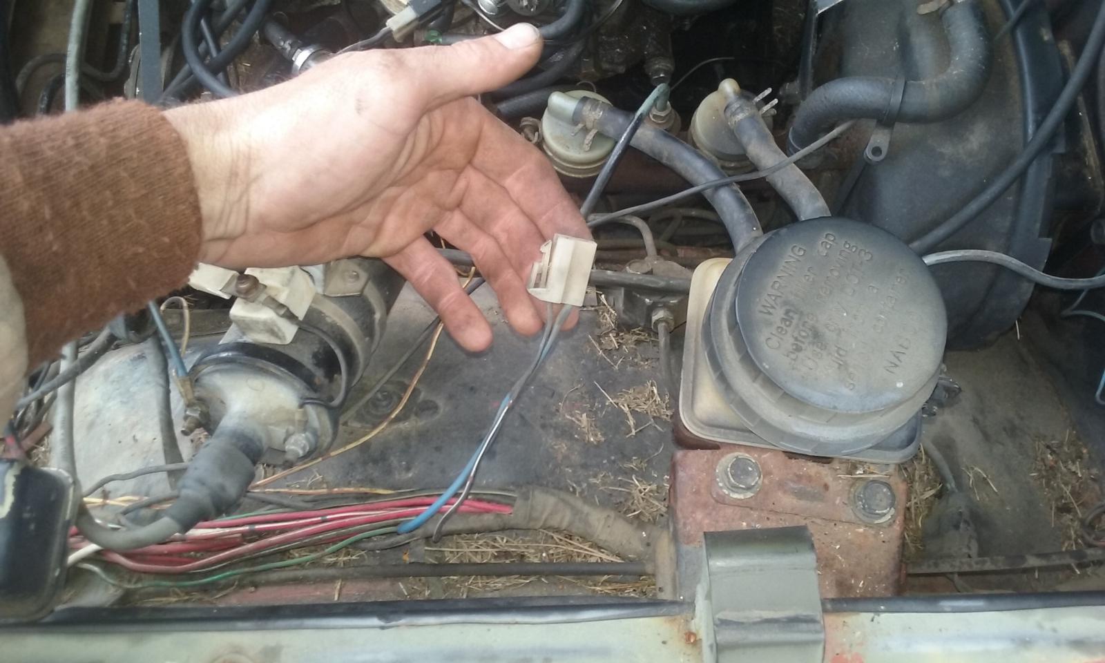

Attachment 18446Attachment 18452
i dont think it goes anywhere, mine isnt connected (the wires)
Can you hook up a multimeter to that 2 pin plug and see if it goes live on ACC or the engine running? A blue wire tends to be connected to the accessory circuit - this might have been for air con :shrug:
I almost started to say that is was the connector for a 3 wire connector starter. Sure looks close to one. Depending on year of truck, the extra wire going to the starter was a great benefit for starting. It would increase the voltage and crank engine faster. But, I think Geezer may be correct. It looks like something AC related. You can check the electrical schematics we have on forum for the correct answer. I think they are located in the Wiki section if no one gives a definite answer between now and then.

I'll check it out.. power is a 1984..

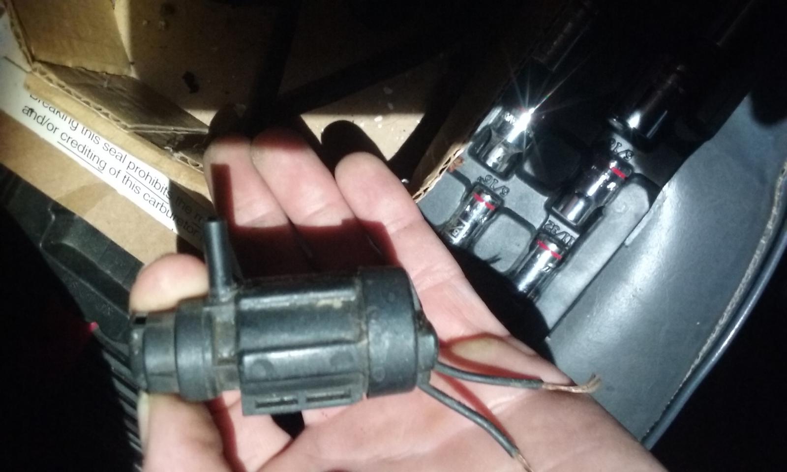

On wire i came acrossed in haynes it says I'm looking ing at a,solenoid I have this thing but don't know what it is..I'm also looking for a 83 and 84 emis sion digrams to the one one hood Mines not there :( I have both Chilton n Haynes manuals and emission for 1984 down don't excist in them looking for more books or unles someone take pictures of theres first..Attachment 18453Attachment 18453
Find the wiring in here. http://www.mightyram50.net/vbulletin...ory-manual-PDF
