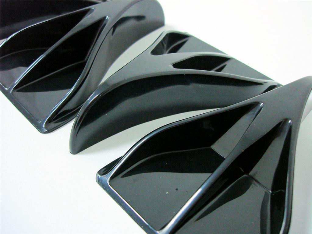

This is the Ebay model of the product which is installed on the roof of vehicles.
Attachment 16554

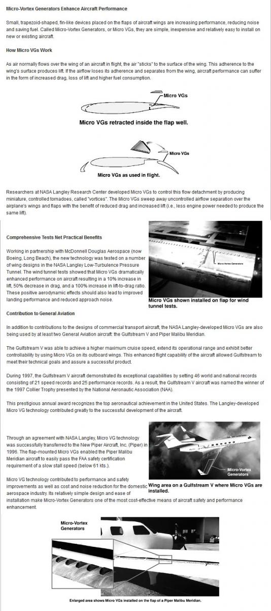

This is the NASA sheet that explains the workings of these little items.
Attachment 16555
Also can be found here http://www.nasa.gov/centers/langley/.../Micro-VG.html if you cannot read it at full view.
they are used to decrease drag on Evos and some big rigs - it works by diverting air into the vacuum pocket that forms at the back of a vehicle - the smaller the pocket, the less the drag.
I think you'd need a hard bed cover to gain any aerodynamic improvement. And you would probably have to be travelling at sub warp speed before they work. Bit like the Lexus LFA. Take it onto a track and do 140 kph and it'll try to kill you - do it at 170 and it'll stick to the tarmac and actually be safer to drive...
Landspeed Racers love them, cleans up the air nicely. All the really fast stuff has them. Other than the cool factor, don't expect any real improvements in fuel economy etc...on a Mighty Max.
