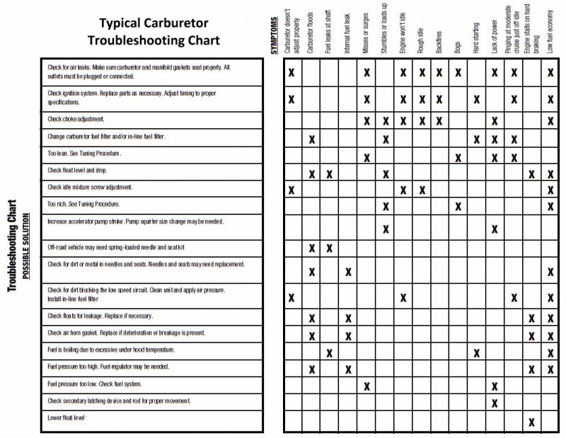

This is a basic troubleshooter sheet for a Carburetor.
Attachment 16428
(click image to expand)
Attachment 16428
