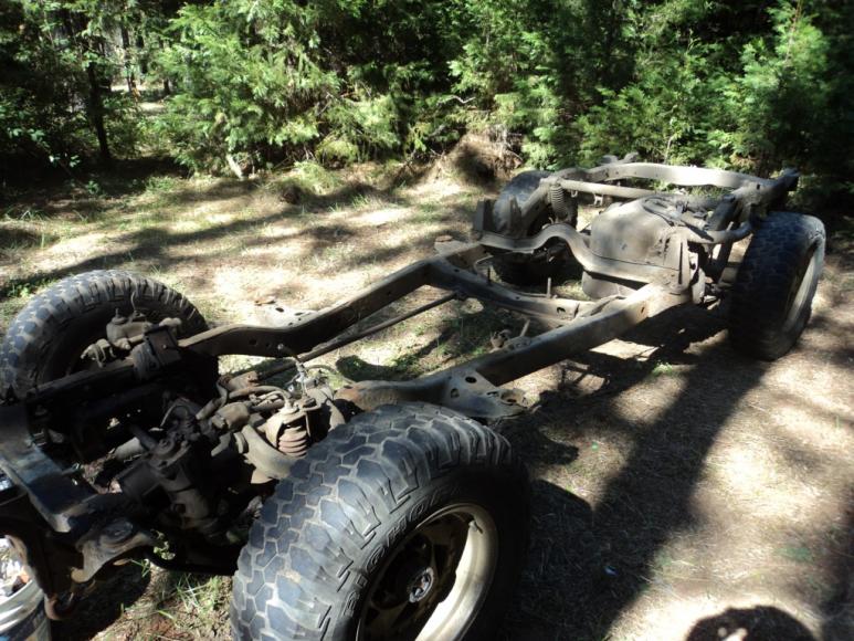

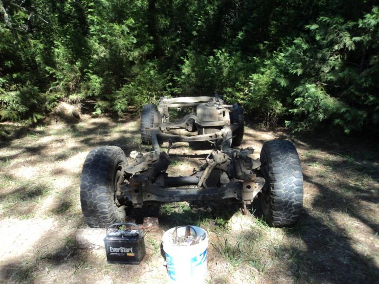

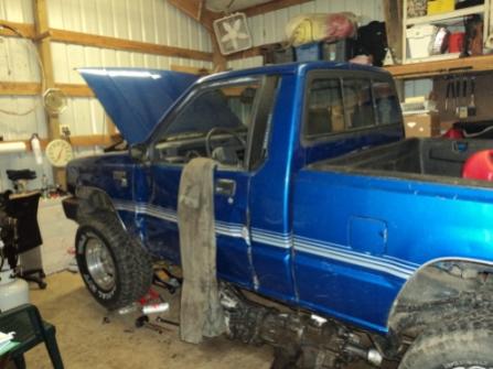

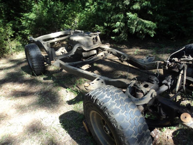

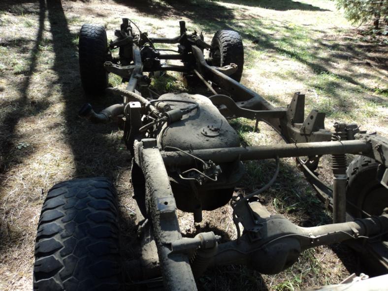

i am currently rebuilding one my two 89 Power Ram 50 4x4's. the one i am rebuilding has a three inch lift that was done wrong that i have to re-do. the motor went out on me the day before christmas last year and have finally got all my parts together for the rebuild.

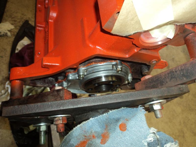

this where it starts
Attachment 396

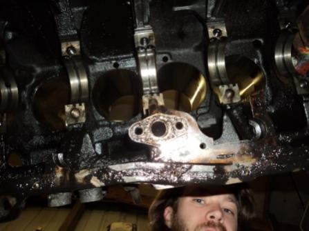

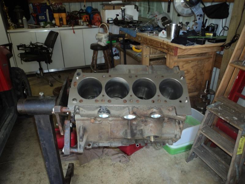

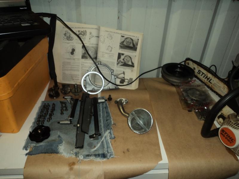

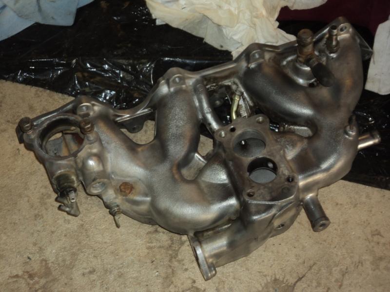

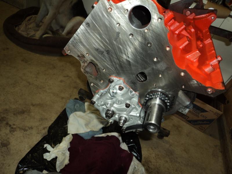

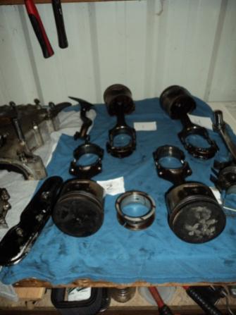

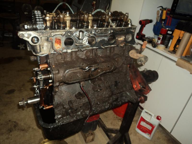

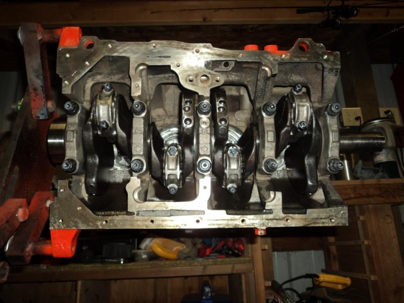

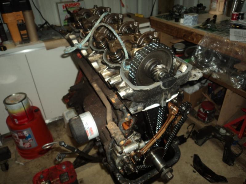

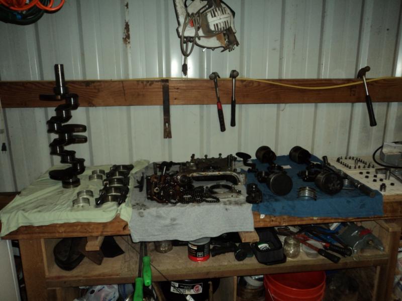

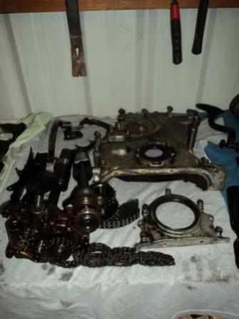

here is the motor torn down
Attachment 397Attachment 398
Attachment 400Attachment 401

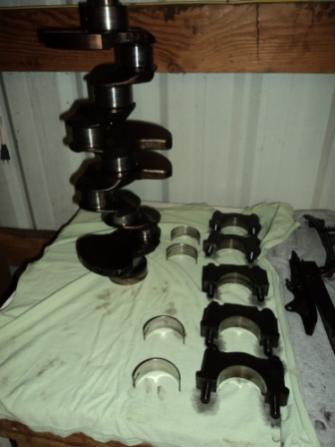

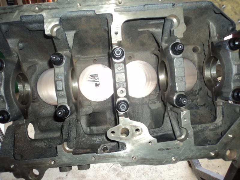

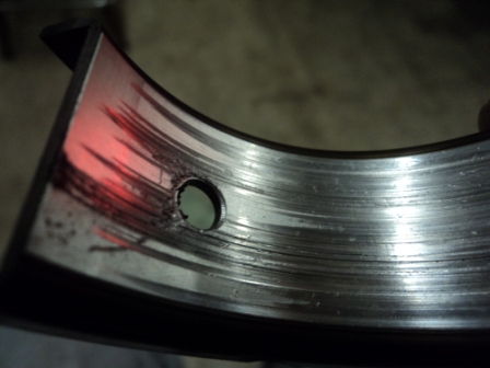

here is what all the main bearings look like

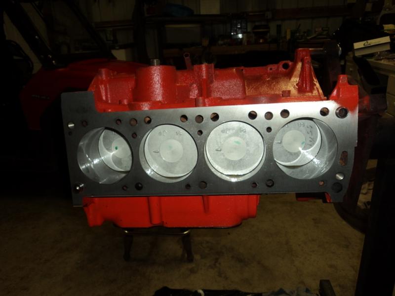

Attachment 402

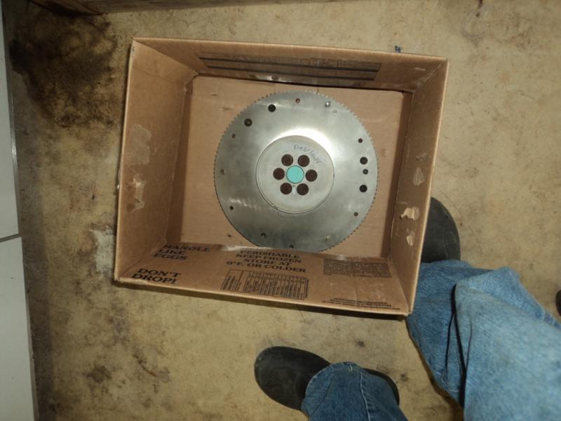

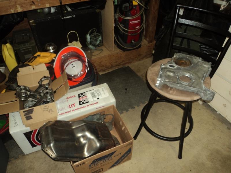

next week the block, new rods and pistons, crank, flywheel, clutch, and front pulley go in to the machine shop to have the bore pushed 0.020 over and a full engine balance. i am going to have two pounds of metal removed from the flywheel as well as eliminating the balance shafts, hence having the motor balanced. i am also going ditributorless so you will get to see how i progress with that.
