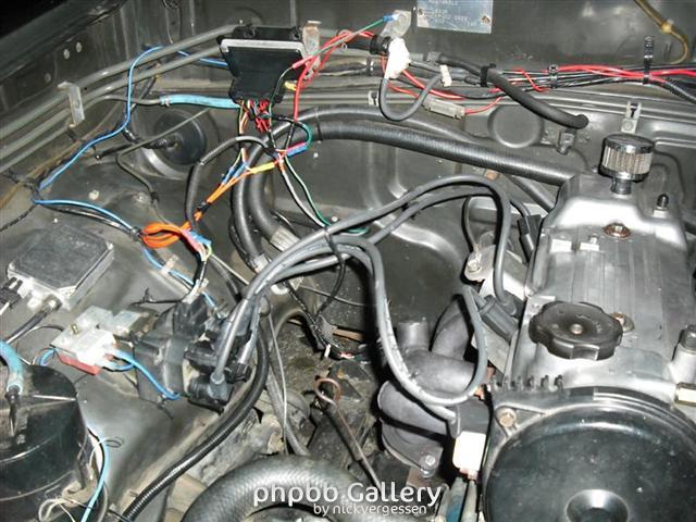

378  379 380  The best thing about this conversion is that the distributor is totally eliminated. So, The timing is dependent on the crankshaft. The crankshaft as a trigger source will send the spark out perfectly on the right time because think of how much slack the distibutor gear, timing belt, sprocket has, so the spark wont be as precise when using a distributor against a direct fire ignition.
The EDIS system is a wasted spark ignition with two coils(2 sparks at same time, one on exhaust stroke one on compression stroke) so there is one coil for 2 cylinders which means the charge time for the coils is greater, putting out a powerful spark. I recently had my stock distributor with MSD Street Fire Ignition and the EDIS is much better.

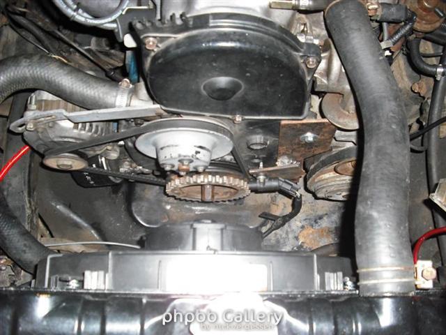

Well its simple on how it works, but putting it together takes time and cost a little $$. I had my crank pulley lathed down then spot welded the trigger wheel into place. then made a bracket mounted on my timing belt cover to hold the vr sensor. then the rest is wiring.
