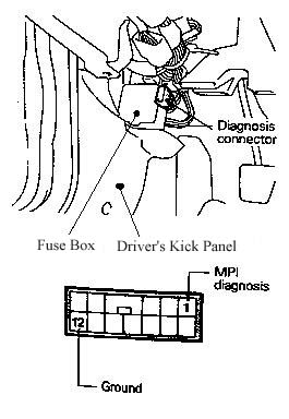

There will be a diagnostic code inside the ECU (Electronic Control Unit) if and only if the 'Check Engine' light on the lower left portion of the dash is illuminated. To get the code that the ECU is reporting follow these steps:- Locate the engine diagnostic test terminal located at the top of the drivers side kick panel (next to the fuse box). See illustration
