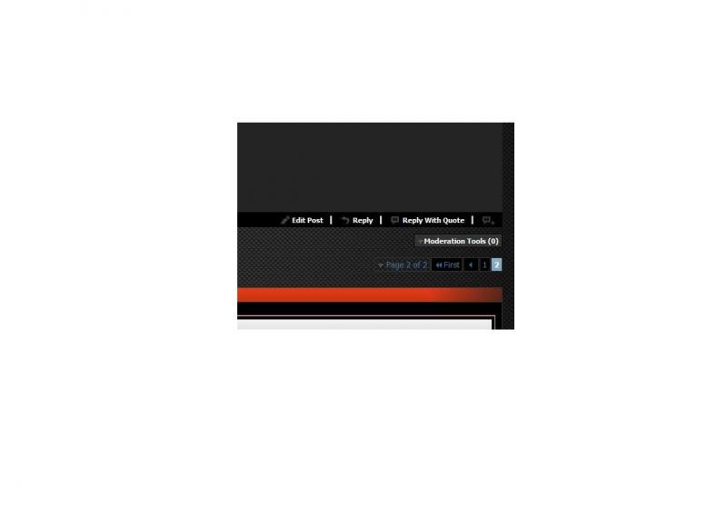

  15. #65
    03-02-2012
    139
    United States
    1989 Dodge Power Ram 50
  16. #66
    3,846
    Thats strange. Try looking at one of your other posts in the forum some where. I'll look into it. It might be a setting for the new b section. You should make a build thread. Also try to make one in the test area and see if it shows up. It looks correct on the back side.
    Find me on FaceBook
    clicking HERE.
  17. #67
