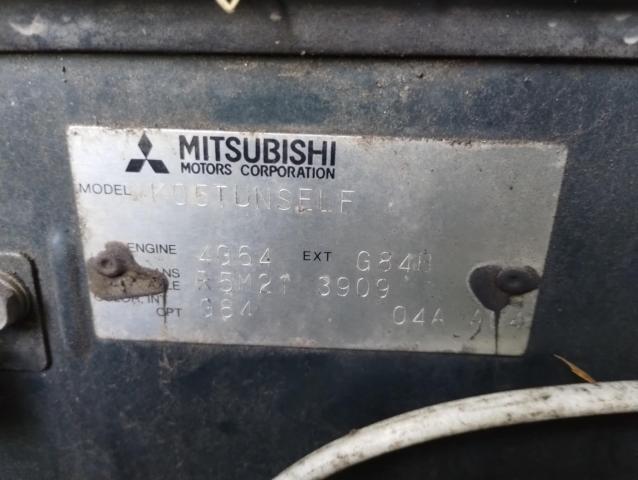

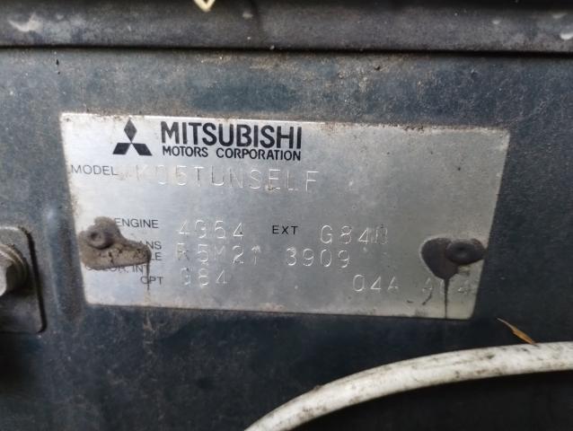

    This is the 5 speed transmission and has this gear ratio on the firewall tag from this 1994 Green Mitsubishi Mighty Max sorry I thought it was a 1995. This is the tag from my 5 speed transmission swapped it also has the same gear ratio on my red 1994 Mitsubishi Mighty Max macro cab. Can anyone help me out why its the same ratio on both tags please?
