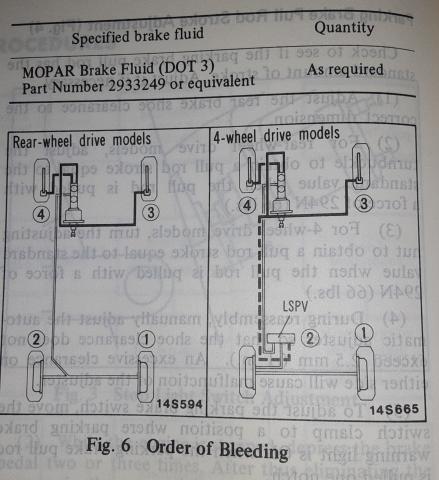

    Hey everyone. Just serviced my brakes. New pads, cleaned and greased calipers in the front. New shoes, springs, wheel cylinders, and lube for the rear. The old cylinders were bad so overall it feels much better. The bottom 1/3rd of pressing the brake pedal is very firm, but the top 2/3rds are a bit soft. Is this normal? I adjusted the drum brakes so that they barely rub when depressed. You can hear it slightly but it doesn’t significantly slow the wheel down from spinning freely.
    They feel safe but I am worried they might wear unevenly/present other issues or are otherwise not adjusted properly.

    Unless you have a fancy Amazon DIY brake bleeder; have a helper bleed the brakes once or twice more (a couple reservoirs of brake fluid)

    Bleeding Procedure Photo:

    It does but my concern is coming from normal use while the car is on. Think it's just excess air, finally getting around to it today though will update later. Appreciate your help

    Just needed to bleed more, feeling nice and firm now. Appreciate the help from everyone. Interestingly enough, my MM is a 2.0l RWD but the rear driver side drum has lines like the AWD diagram.
