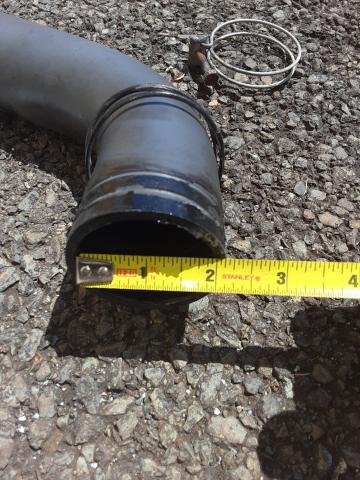

    Hey would you happen to know the diameter of the fuel filler hose? Are there any filler hoses for another truck that are compatible? My fuel filler hose disintegrated and I need a new one but cant find a direct fit.

    Nik my truck will be towed to the U.S. Marine Base Kaneohe Friday 7 March so we can begin cleaning the entire fuel system... Removing the fuel tank & fill hose needs to happen for complete cleaning of both tank & hose... I will measure the fill hose I.D.

    1,549
    Quote Originally Posted by nik View Post
    2"
