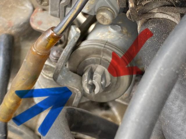

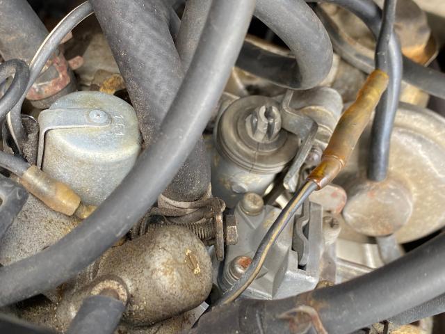

    I’ve attached 2 pictures. Is the thing with the blue arrow supposed to go in the slot with the read arrow pointing at it? I don’t even know what it is, but it sure looks like they’re supposed to fit together. Anyone know? (Not sure why 1st pic flipped upside down.)
    1,580
    YES a small spring followed by a small ball bearing go into that slot hole then the arm fits into the slot and finally a pin passes thru all the holes with a tiny C clip that snaps onto the pin end to hold the pin in place... It can be tricky to fit together...
    The device is call SUB EGR

    Thanks so much. Any chance you can post a picture?
