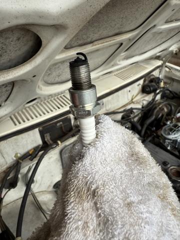

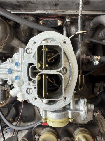

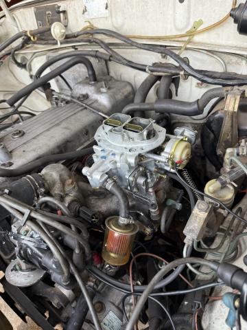

    Hi everyone, first time posting. Just installed a new Weber 32/36 DFEV on my 1986 Mighty Max G63b Automatic. Also installed a new Carter electric fuel pump next to the gas tank. Truck will start up okay, but once I gas the throttle, the carb will backfire. Once I put it in gear, truck will bog/ die out when pressing the gas. Max speed uphill is about 5mph. When I pulled the new spark plugs they are covered in soot. First time working on a carb. I've attached a link with pics and vids below. Thanks

    Backfire is odd if the valve and ignition timing were good before and weren't touched. Just read in this other thread that jet valve malfunction can cause backfire and loss of power:
    http://www.mightyram50.net/vbulletin...ll=1#post86167
    The Weber conversion doesn't engage the jet valves at all, so you can try temporarily disabling them by removing their lash adjustment screws from the rocker arms under the valve cover.
    That said, this may not help if any jet valve(s) got damaged. Look up "jet valve eliminator" for a kit of plugs to replace your jet valves; they just unscrew from the head like spark plugs, tho' you need to remove the rocker assembly to get at them. You'll also need a deep 14mm socket.
    Been meaning to do that job myself, have read that the easiest way to remove the rocker ass'y is to remove the cam sprocket first. There's a hook provided to hang it on, so you won't lose cam/valve timing or have to mess with the timing chain. Keep track of which cam caps went where, so you can return them to their original positions on reassembly.

    Hey xboxrox,
    I have a carter electric pump right outside the gas tank. I haven't replaced the filter inside the tank though. I just picked up this 86 Mighty Max locally a few weeks ago! New to me work truck.

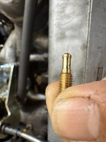

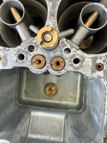

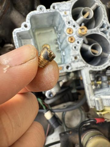

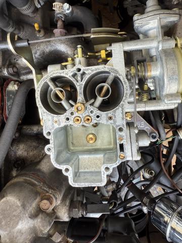

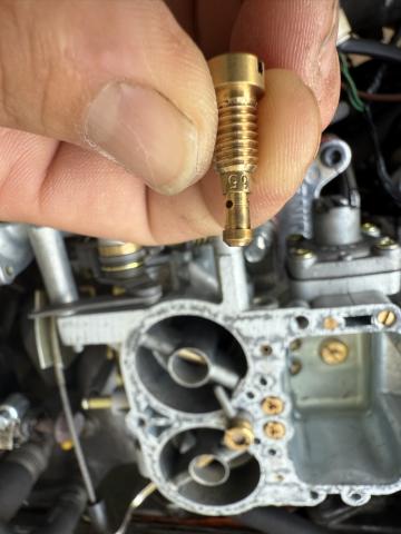

    Post update 04/02/25

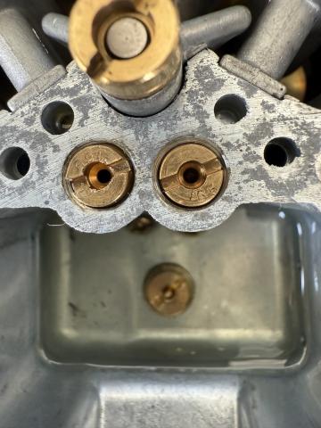

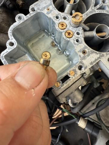

    Took apart the carb to check my jet sizes
    Weber 32/36 DFEV
    Primary Air Corrector: 165
    Secondary Air Corrector: 160
    Primary Main Jet: 137
    Secondary Main Jet: 140
    Primary Idle Jet: 65
    Secondary Idle Jet: 50
