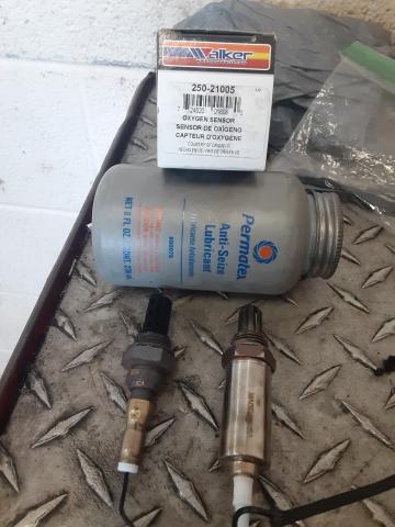

    Just replaced the three year old O2 sensor with a better quality part although both the old & new were Walker brand from RockAuto... Result, truck runs noticeably better but every so often at low RPM 10 MPH 2nd gear acceleration has a slight miss corrected by using more throttle WOT is great...
    So...
    NEW IGNITION COIL
    NEW O2 SENSOR
    and...
    MAYBE A MIKUNI REBUILD someday

    That anti-seize compound might be a problem:
    https://www.kemsoracing.com/blogs/ne...wner-must-know
    1,574
    Ewww..! I just read most of that info & now know why the new sensor had some sort of lube on it from the factory. Hopefully the small amount of anti seize I applied will not screw it up.
    Thank you Sub A
    03-06-2018
    666
    Tucson, AZ USA
    I can't make out the number on your jar of Permatex anti-seize, but according to the article I linked, looks like Permatex #80078 should be fine (but NOT Permatex #77134).
    1,574
    It's Permatex #80078 copper, nickel & aluminum among other ingredients lable includes using it on O2 sensors BUT Permatex website does not mention using it on O2 sensors (there was waxy looking lube on the new sensor threads and I did put a very thin layer of my antiseize on the threaded end of the sensor) too late now & too much trouble to rework the job so X'd fingers the engine keeps running ok... Will not use the metal compound antiseize for any future O2 work lesson learned...
    Need shop tools materials experience in rust repair now WHAaaaa
