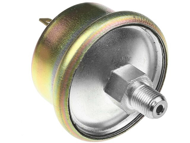

    Hello all,
    For some context, my oil pressure gauge on the dash cluster does not work. I recently was doing some maintenance on my truck and noticed some damage to what I believe is the oil pressure sensor (see photo). I was unable to find this part in any manual I could find, but figured it was the oil pressure sensor due to its location under the filter. When looking online for a replacement they look similar but I am not positive. Can anyone weigh in and confirm/point me to a relevant manual?
    Thanks in advance,

    Yep, that's the oil pressure sensor. I've had a couple of them fail in the last couple years, never a good feeling when the oil light comes on. It's been awhile, I don't remember if the light should be on with the connector grounded or open. Someone else may know and chime in. If that's how yours looked originally I'd recommend cleaning up that contact and plugging the connector all the way in, the switch may still be good. You could also remove it and use an ohm meter to test the switch, I think (Don't quote me) with the plunger depressed there should be no resistance, plunger out there should be a high resistance / open circuit. I believe the switch gets it's ground through those threads, that could also be the issue. Good luck, hope you figure it out.

    The low oil pressure warning light switch is a separate unit from the oil pressure gauge sender. In the photo you can see the other one off the side of the tee.
    Typically the switch will be the smaller of the two, just a hex fitting with a terminal sticking out of a bit of plastic on the end, whereas the gauge sender will be a bit larger, with a small (2" or so) metal canister between the hex fitting and the terminal. Hard to tell for sure, but seems like both in the photo may be the switch type, which might explain why a prior owner just left it disconnected if they replaced the original gauge sender with a switch by mistake.
    Both work by grounding their respective wires from the light or gauge to the block thru the switch/sender body. Oil pressure holds the switch open, preventing the light from illuminating, and pushes a plunger in the sender that presents a variable resistance for the gauge to read (it's basically just an ohmmeter).
    OEM gauge sender part nos. should be MD005480, superseded by MD092660; aftermarket replacements will prolly cross-ref both. Oil switches and senders are both stocked at RockAuto for your year/make/model under Electrical-Switch & Relay > Oil Pressure Sender/Switch, and note which ones say light vs. gauge.

    Thanks a bunch. Was wondering why my searches returned 2 different things. The warning light is not on, so seems like the smaller one in the back is the light switch. I'll get a gauge sender ordered instead.

    Wanted to follow up on this as I’m a bit confused. Have the new part in hand and was getting ready to disassemble, but the old faulty sensor has a 3-pin connector, while the new part/all documentation of these cars stock is a single spade terminal. There is an aftermarket pressure gauge in the cabin, is it likely that somebody modified this harness? Even the light switch sensor has 3 connections oddly enough.
    If it’s aftermarket guess the next step is to pull the gauge in the cabin and follow the wires/remove them and revert it.
    the one in your hand looks factory. The 3 pin one is a gauge and oil light in one. But it doesn't look factory.
    There is something else going on there because I see a T and another light switch.

    the 3 pin one is definitely aftermarket gauge

    Pretty sure for all years the stock-type light switch and gauge sender should each have one spade terminal, wired directly to the light or gauge respectively.
    That setup you've got looks like a BSPT-to-NPT thread adapter (stock threading is BSPT), apparently to add a NPT tee to that, then the two switches (?) screwed into that tee, so some sort of jerry-rigged aftermarket setup there for some reason.

    Looks like there's just the one bung for a gauge sender or light switch, so trucks equipped with a gauge would have just the sender installed there and no separate switch:
    https://www.megazip.net/zapchasti-dl...e-unit-1865220
    Prolly the gauge itself does double-duty to trigger the warning light when it's pegged at 0.
    Speaking of double-duty, another thing just occurred to me about that 3-terminal connector on your apparent non-stock busted switch: could be that one terminal is a normally-closed circuit for the light, and the other two are a normally-open circuit for use as a safety switch -- e.g., to cut power to an electric fuel pump when the engine dies, such as in case of a crash.
