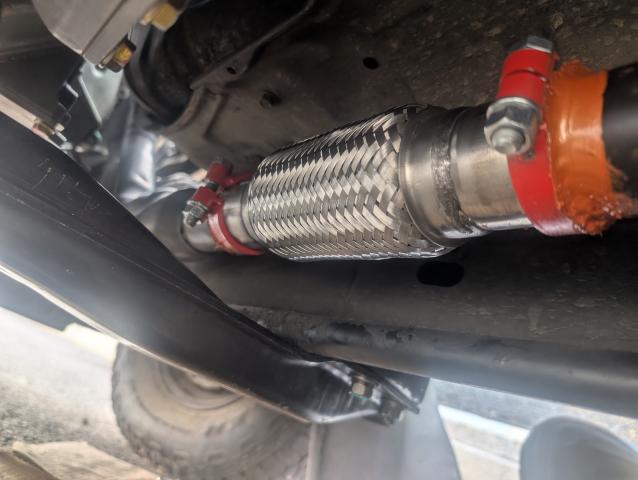

    I finally removed the catalytic converter. Now, where do I scrap it for money? Made some shop made clamps too. Slathered some high temperature orange rtv on the ends of the pipes and then clamped the flexible exhaust connector where the catalytic converter once was. I still have other work to perform on the truck before I can start it and check for leaks. That will be another update...

    Thanks for the information guys. I just started her back up and the truck didn't get that much louder. It's very hard to notice much of a change in sound.
