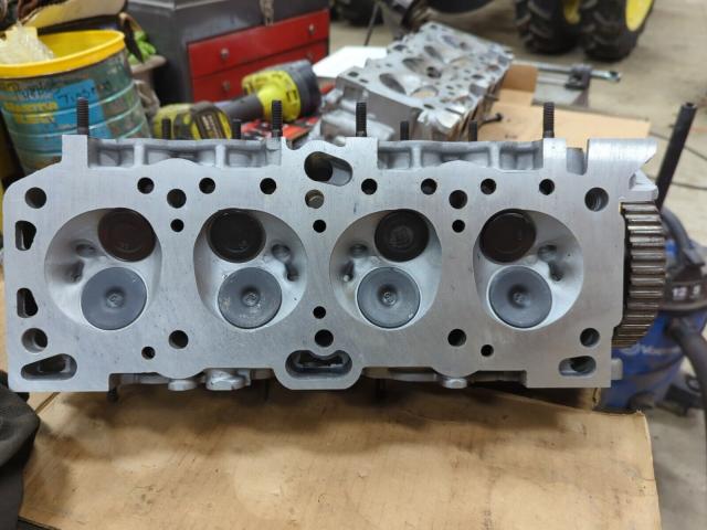

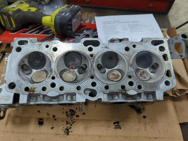

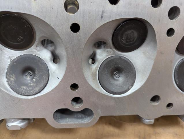

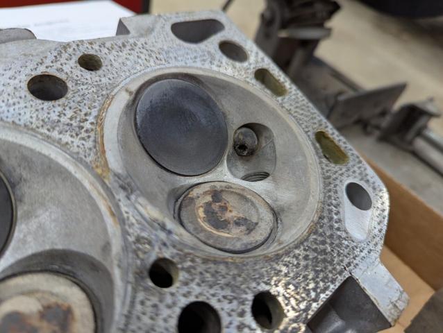

    Good morning, so I did find another head online from a parts shop. there's a couple differences I wanted to ask you guys about. First off, the new head has oblong combustion chamber faces... whereas the old has perfectly round. And then there is a second port (threaded hole) near the plug hole. I'm not sure what that does, but the new one has plugs in it and the old has what appears to be a jetted fitting. Any thoughts to whether i should install this or send it back? Thank you.

    also the original had cam bearings, the new one looks like it fits perfectly fine without bearings... I'm reading that it may not need them? That sounds like a bad idea but what do you guys think?

    G63B would have been a jet-valve head, so those threaded fittings in the old head were for the jet-valve inserts. I'm not sure what's up with those smaller plugged holes in the 4G63 (non-jet-valve) new head, might be a small pre-combustion chamber, or maybe the heads are all made with pilot holes they'd drill out for jet-valve inserts or plug otherwise.
    Oblong combustion chambers may be shaped for better combustion and/or breathing, and prolly has less volume than the round chamber, which would get you a slight compression boost; just make sure they're fully enclosed within your head gasket cylinder rings.
    In general, many OHC engine designs don't use separate/replaceable bearing shells for the cams, as the head material itself can be sufficient to act as a bearing journal. Cam bearings don't suffer the kinds of shock and pressure that crank/conrod bearings do, so Mitsu may have concluded cam shells weren't necessary and/or improved the alloy formula for later head revisions to eliminate shells for the cam bearings.
