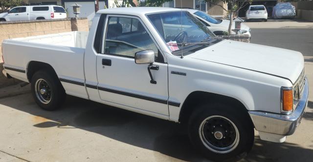

    Hi everyone, I'm new here.
    I just got this 88 Mighty max, with the 2.6L, G54b, original Mikuni carb and California emissions.
    Its in great overall condition and seems to run fine, plenty of power and the engine sounds great.
    But there is a bit of indication that it might be running slightly rich, Black sooty exhaust and failed CA smog.
