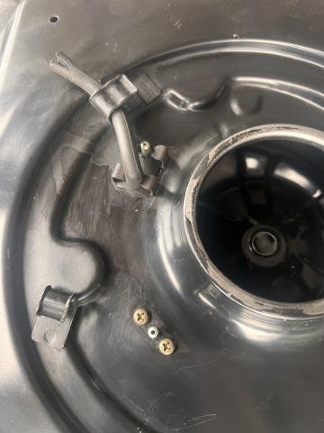

    Now that we can see the hose you mean, a correction to FMS88's reply: that hose should plug into the air temp sensor on the bottom of your air cleaner. Then the other hose barb on that sensor connects a hose to the vac tree on the manifold.
    BTW, pretty sure the intake snorkel has the hot-air flap closed by default, only pulled open by vacuum when the air-temp sensor in the cleaner housing allows vacuum to pass. At least, that's how the snorkel works for my 2.6L and other carb'd vehicles I've owned. Which makes sense, as default modes are typically for "normal running" conditions, with the deviation from default being for special-case scenarios (frigid-temp warmups in this case).

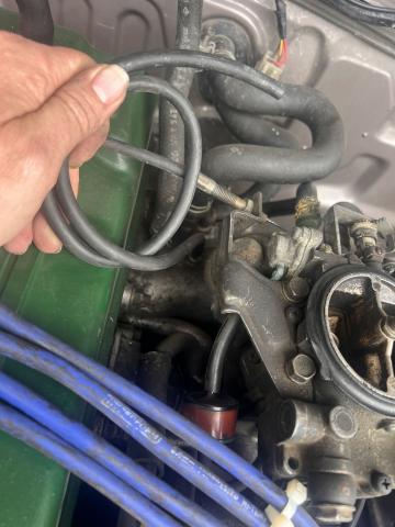

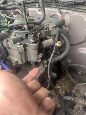

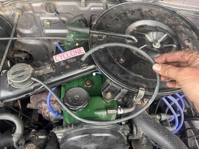

    Thanks so much for the replies - I lifted the Air Cleaner off and have now got more mysteries...
    I can see the two points you've mentioned on the bottom of the Air Cleaner, but I've now found another hose disconnected and an empty barb - any idea what goes where?
    Really appreciate the help so far!! Cheers

    Yes, pictures definitely help! Not sure about the latest hose. Does the other end attach to the carburetor or manifold? If the manifold, it could go to the air cleaner thermo-switch. As to the open port, is there vacuum hose routing diagram applied to the under side of the hood? If not, is there an identifying number on the carb top, or one on the tag next to the left of the accelerator pump and above your hand seen in Carb.jpg? Identifying the carb could help us find info about its vacuum lines and ports.
    Is there a vacuum line from the distributor advance to the carburetor? If not, the open port you're pointing to may be for the distributor advance.
    Lastly, in the Vacuum.jpg picture in Post #2, it looks like the shroud over the exhaust manifold is missing. Without it and the flexible hose/duct from the shroud to the air cleaner snorkel, less warm air will be directed to the carburetor during warm up.
    Yeh, that position on the carb does look like about the right spot for "ported" vacuum that would operate the distributor vac advance off-idle.
