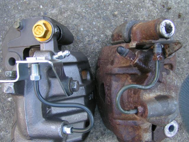

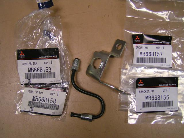

    I'm doing the upgrade on my '88 Gen2 and during a test fit between storms yesterday, I found the backing plate needs to be trimmed or changed to the Montero's. Also the one pot caliper's bracket supporting the flexible rubber-to-hard brake line connection and the hard line too, aren't adaptable to the Montero's two-pot caliper. So they need to be acquired along with the calipers. Otherwise, the fit looks good with adequate clearance between the caliper and a 15" steel rim.

    If the hard lines aren't rusty, you probably don't need to replace those, but now is a good time to replace the flexible rubber hoses, especially if they could be the original hoses. I found that I couldn't use the original short hard tube that screws into the caliper and it's supporting bracket. I could only find foreign sources for those so they're on order. Hopefully I'll have then in a week or two.

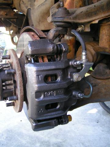

    Finally got time and good weather to finish this upgrade. Since the calipers were purchased from RA, I needed mounting brackets and hard lines that attach to the caliper.
    The original hard line is similarly shaped but a bit shorter. It might have been possible to bend it enough to work but the Montero supporting bracket is definitely required unless you can fashion your own. The backing plates needed trimming, but no other modifications are necessary.
    Here's the final install:
