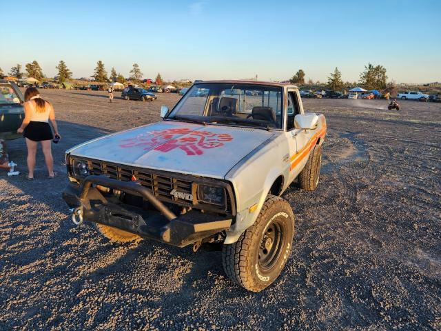

    I followed a thread on here about swapping Montero front brakes. I did the swap using 1999 Montero front rotors and calipers. It works great. It was not difficult and definitely an improvement.
