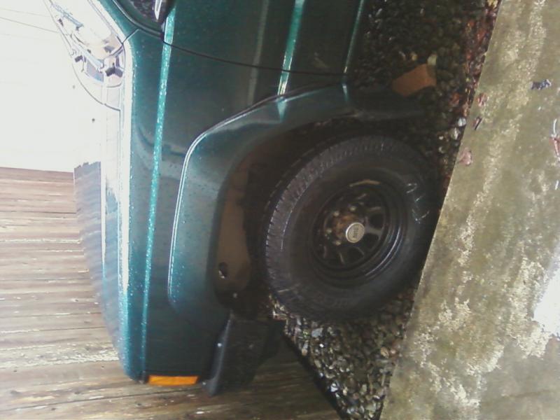

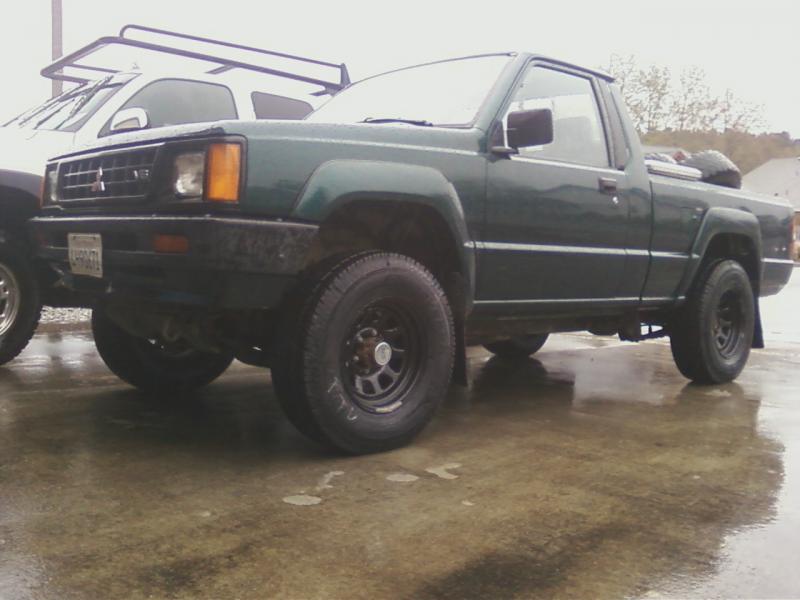

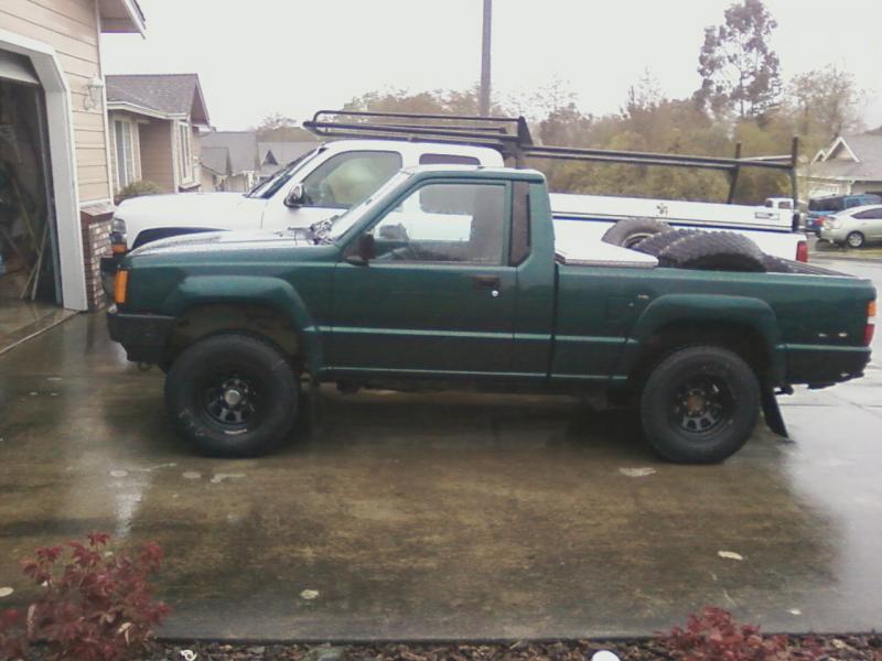

    Hey Camoit i just got your PM. I just fit 30X9.5X15 tires on my truck today! The only problem is it rubs on the front just a tad when you fully turn. I do not have a lifted truck but its perfect for me! I will upload a pic in a minute. Btw nice find on that 3.0L 4x4, i also have one. Pretty rare!!

    to clear the 30" tires on your truck, trim the pinch weld at the bottom of the wheelwell - it was a tip I saw years ago in an old John Baker performance catalog about clearance issues.
    3,847
    Or smack it with a hammer, it will fold over nice and clean.

    Yeah thats what i need to do. There is rubbing on the front where the metal trim piece is when the suspension is down
