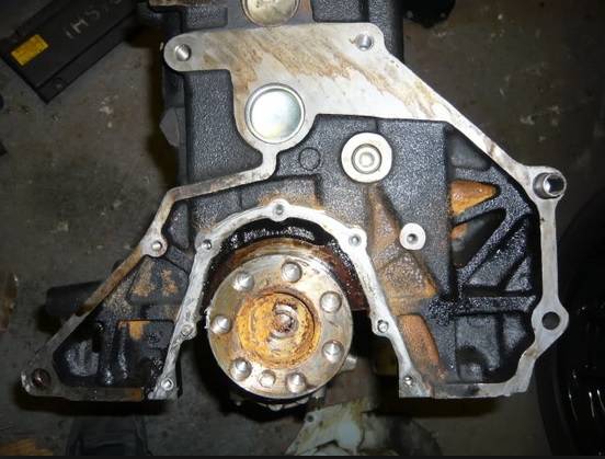

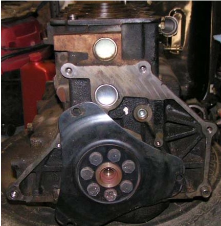

    Blocks
    DSM blocks are very similar to the Evo styles in that they have the same general dimensions, many bolt holes line up the same, and they are both part of the 4G6X family. There is one huge difference between the two - the deck casting.
    Evo blocks are also very similar to the DSM styles in the same way as above. However, there are 2 differences. The first one is obviously the deck casting.
    The second is the bellhousing casting. That will be explained below.
    Wide Blocks vs. Narrow Blocks
    There is a lot of confusion here for many people. The difference is 1 inch - thats it. A wide block measures one inch wider than a narrow block at the lower bellhousing bolts. Simple as that. If you don’t know which block is wide or narrow, measure it. If you have not memorized which blocks are wide or narrow, check the chart.
    FWD vs. RWD
    Again, more confusion. The differences are these:
    • Wide or Narrow bellhousing casting
    • Orientation bellhousing casting
    The most important thing to remember is the Orientation. There are 3 orientations of Mitsu engines with many different variations:
    • Rear Wheel Drive (RWD)
      • These were BOTH wide and narrow. There are TWO deck castings (DSM and EVO) available in both wide/narrow bellhousing castings in the 4G6X family.
    • Front Wheel Drive (FWD)
      • These are ALL narrow. There are TWO deck castings (DSM and EVO), and TWO bellhousing castings in the 4G6X family.
    In the FWD chassis, there are 2 orientations:
    • Drivers side orientation (left side in the US)
    • Passenger side orientation (right side in the US)
    A General rule for mounting FWD narrow blocks to RWD chassis is:
    “You CAN mount a Drivers side orientation 4G6X narrow block to a RWD transmission.”
    “You can NOT mount a Passenger side orientation 4G6X narrow block to a RWD transmission without a mounting solution.”
    What is a mounting solution and why do you need one?
    Simple. FWD blocks with passenger side orientation have and axle located directly in line with the right side of the blocks lower trans mounting bolt. Mitsubishi’s solution was to move the lower mounting bolt hole up about 2 inches to clear the axle while maintaining the same amount of bolts to the transmission. The Drivers side oriented engines have their axles located on the left side of the engine where they do not interfere with mounting.
    With that in mind, the general rule above applies. The FWD narrow bellhousing patterns differ by one bolt. When mated to a RWD narrow transmission, one bolt will have to be left out. This is NOT recommended because of the higher output potential and general weakness of the RWD transmissions in general. There are solutions to this problem, and we will get to them later - do not lose hope just yet. Keep reading.

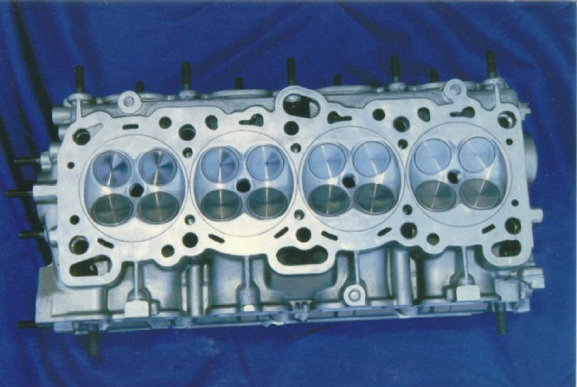

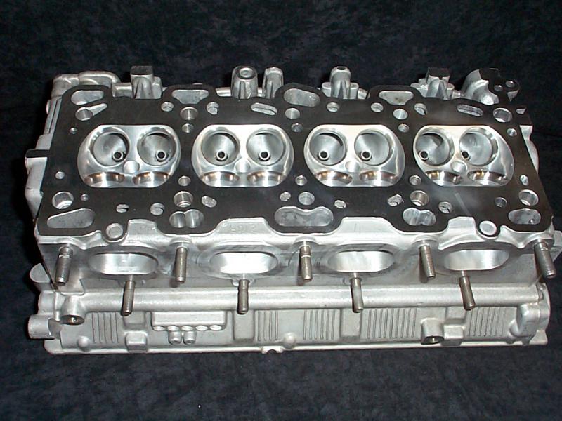

    Cylinder Heads
    Cylinder heads carry a similar manufacturing variation as the blocks. There are obvious variations between single cam (SOHC), dual cam (DOHC), 8 valve, 16 valve, orientation, casting, etc. are all variations of the same 4G6X cylinder head family. This article is aimed at 16v DOHC specific cylinder heads of the 4G63 DSM and Evo variants.
    DSM
    DSM heads have a specific casting that matches the appropriate deck on the DSM block. The intake ports are the LEFT side of the engine while the exhaust ports are on the RIGHT. The bolt pattern for the head bolts are the same as any other 4G6X engine. There are 2 different intake port sizes to chose from (large or small port), and everyone likes to provide an opinion on which one is better.
    Evo
    Evo heads have a specific casting that matches the appropriate deck on the Evo block as well. The casting is NOT the same as the Evo head and is NOT compatible. The reason why will be explained later. The Evo intake ports are on the RIGHT side of the engine while the exhaust ports are on the LEFT. This is opposite of the DSM. The head bolt pattern is also the same for the 4G6X family.
    Hopefully you can see the differences between the two castings. Now we move to the fun stuff where we put all of this together!

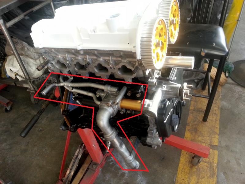

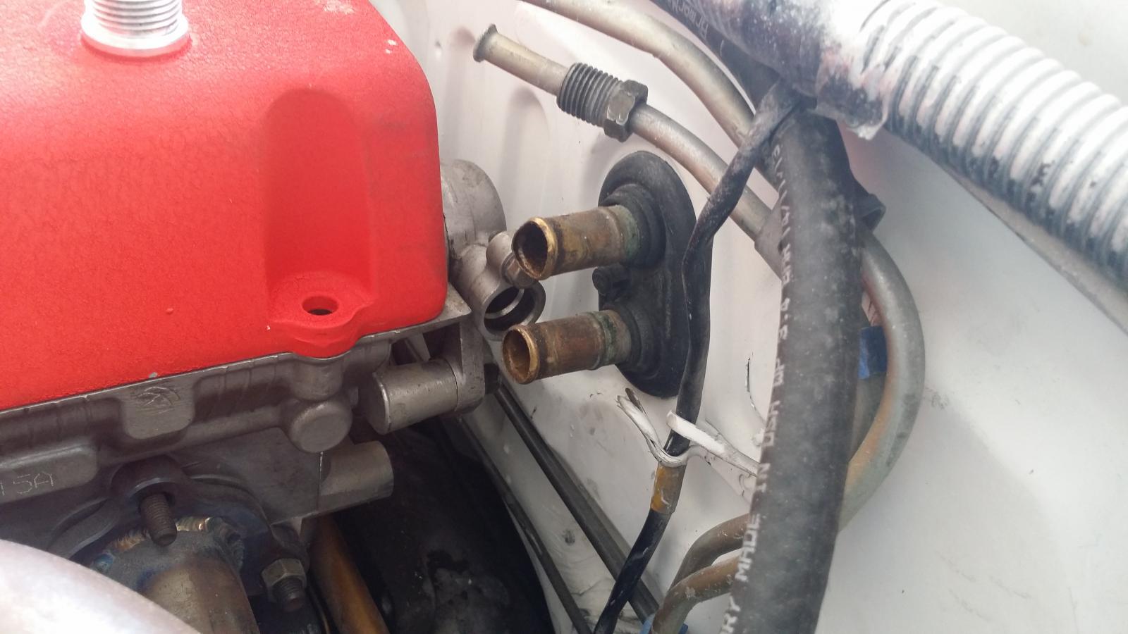

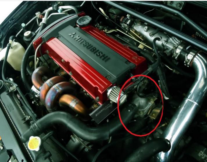

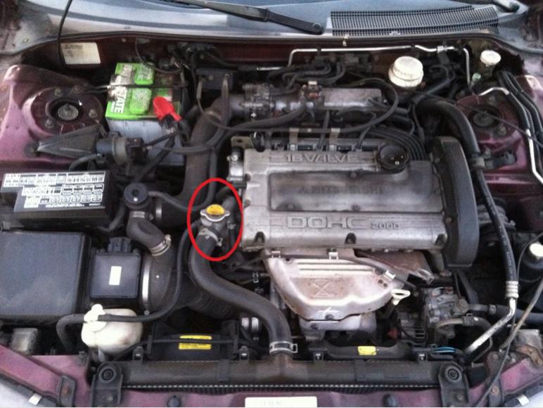

    Cooling system

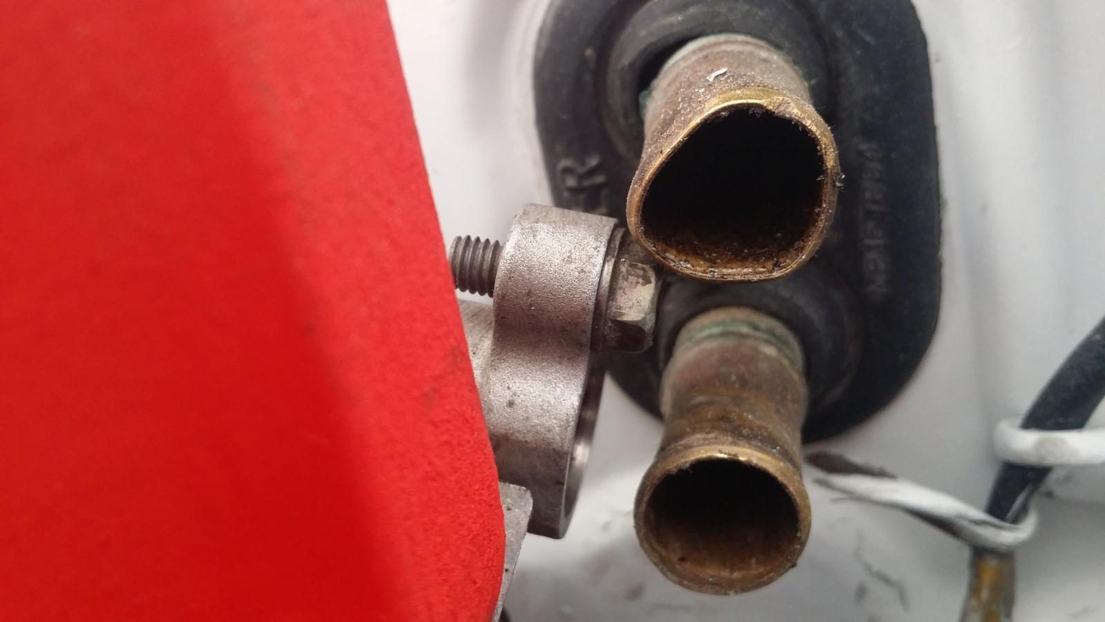

    What if you don’t want to play Whack a Mole with your firewall? What if you can’t justify slicing up perfectly good sheet metal just to shoehorn an engine in? Why do you have to worry about this to begin with? - because on the back of every FWD head you will find the thermostat housing or coolant port. This is usually located in the center of the engine bay of a FWD car.
    For future reference, those of you who want to use the Hyundai/Kia head for your Evo variant build, the neck is in the same location.
    A solution exists from Mitsubishi. It is a solution they used to mount and does not require you to smash the hell out of your firewall or slice it up. The 97+ Montero Sport 4G64 engine uses a thermostat housing located on the right side of the block. This also has the return port for from the heater lines and back of the head for flow.
    Utilizing the Montero Sport coolant housing does require a couple mods to pass coolant back to the radiator. For starters, you need to add a port to the front of the head. DSM, Evo, Hyundai and Kia have a freeze plug located on the front of the head. You can pop the plug out and attach a pipe or hose adapter which will lead straight to the upper radiator.

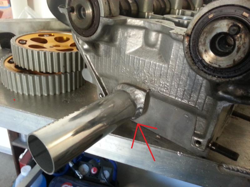

    The back of the head needs a modification as well. The port for the factory thermostat housing needs to be blocked off, but a hose barb/nipple needs to be added to feed the heater and a flow port needs to be added.
    The Evo, Hyundai and Kia heads have a coolant port already built into the right rear of the head. This port gets routed back to the Montero Sport thermostat housing via the water pipe on the assembly. You will need to either add a port to the block off plate to feed the heater, or tee the port off of the right rear port on the head.
    The DSM does NOT have this port built in. The solution is to tap a branch tee (or two separate fittings) into the block off plate. This will feed the heater and return coolant to the water pump.
    These mods will eliminate the need to smash up the firewall. These mods will also delete the need to run a water pipe to the back of the engine.

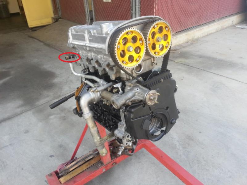

    Cam Position Sensor Vs. Heater Core
    The cam sensor directly interferes with the heater core tubes. This can be solved by phasing the sensor and reluctor, or finding another routing solution... I'll figure it out later and provide the solution.

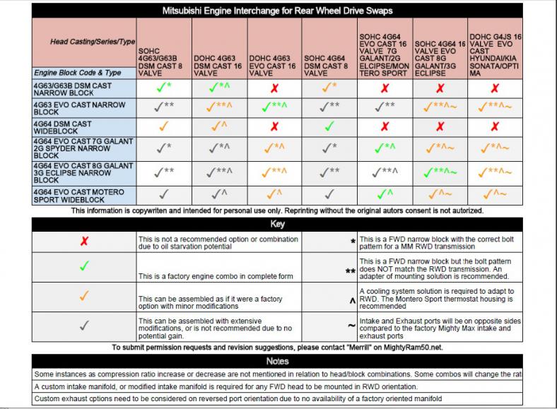

    Charts
    Below is a quick reference charts for your personal use. It will help you quickly decide which combination you would like to build in whichever fashion.
    Please ask permission to re-post this somewhere else, and please credit me for the information. I would like to track where and how the information is going as best as possible to provide possible updates and correct the information for new discoveries.

    I'm working on a quick reference interchange chart at the moment. Ill post it up as soon as I get it done.
    As more questions roll in, or if I add something else not mentioned, Ill be sure to add them to the post to eliminate most of the need to scroll through dozens of comments searching for more answers.
    As always - if you don't see an answer, post up or PM me (if you want to be discreet/worried about getting flamed). If you ask a question that is clearly explained (meaning I know you didn't read what I wrote), I might not be very nice lol.
    01-16-2014
    464
    Las Vegas, NV
    1991 Mitsubishi Mighty Max
    Reference chart added
    The only thing I see that was possibly missed are the years of the model engines being posted on the chart.
