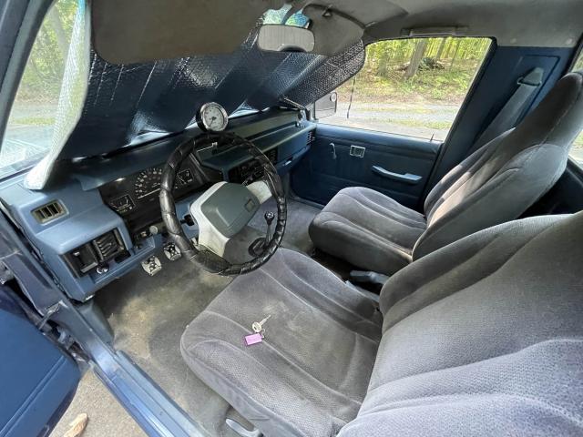

    -Redo interior. Previous owner elected to place a vinyl ... thing ... down in place of the carpet. I am not thrilled about it, but this is at the bottom of the list priority wise.

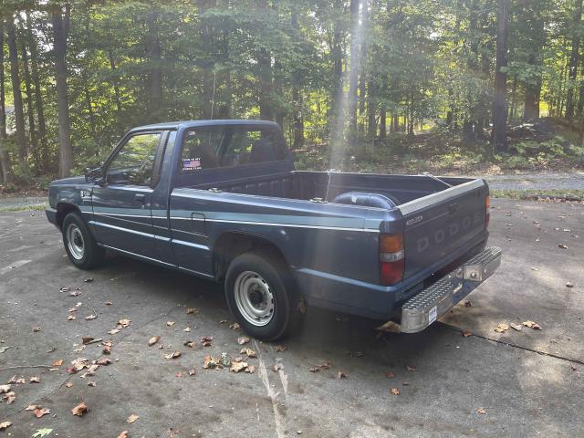

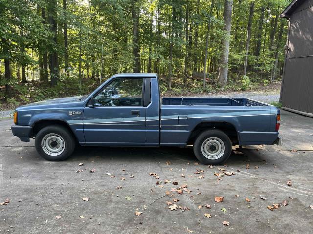

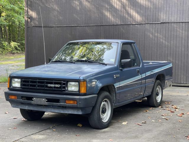

    I have read the thread on things to do the moment you get the car, and feel like mine is in good shape. Vehicle came with weber carb conversion, muffler work, and generally great upkeep. Glad to have found this forum and am looking forward to getting this car in top top shape. Pictures to follow.

    truck looks good

    Looks like a pretty clean and solid truck OP, good score!
