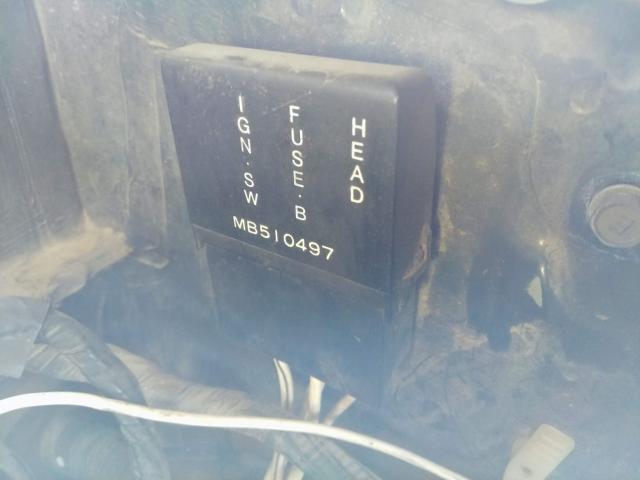

    I think 1st-gens and early 2nd-gens have a box with fusible links mounted to the inner fender on the battery side, like this:
    It should be pretty obvious if one of the links in that box is burnt out; looks like a PO of my truck had already tried to jerry-rig a substitute here:
