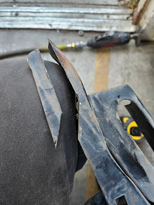

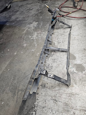

    Once back at the Garage I set the bumper up against my own MM and started looking at it again. I came up with the idea on how to modify the Montero main bumper support brace to recess it further into the truck and hide the gap on the top of the bumper. To do this I first removed the bumper cover from the bumper brace. Then punch out the two upper studs of the support brace. I set the back of the stud inside of the smallest socket that would fit over it's round head and then hammered down on the threaded side of the stud until it separated from the brace (just a couple whacks nothing bent) I then freed the outer two vertical supports of the main bumper brace by drilling the three spot welds on the top of each side. I found that if you bend the two outer vertical supports inwards, you can bolt the brace onto the truck without having to drill new holes or install rivet nuts as was done in the other forum post. I then found a chunk of 1x2 square tubing I cut two 1" long pieces to put between the brace and the vertical supports. I welded the spacer to the vertical portion of the bumper brace first then reinstalled the brace to the truck. I then could see how far up the horizontal beam of the bumper support needed to be pulled. i pulled the horizontal beam up till it was about 1/8 or so below the mounting screw holes for the lower screws of the marker lights (so you don't have to remove the bumper to take them off) with my height to the vertical bars marked I took the support off the truck, then pulled the vertical bars inwards (lined up with another line shown in pictures) then welded the vertical bars to the horizontal beam at the marked height.
    CUT TIME
